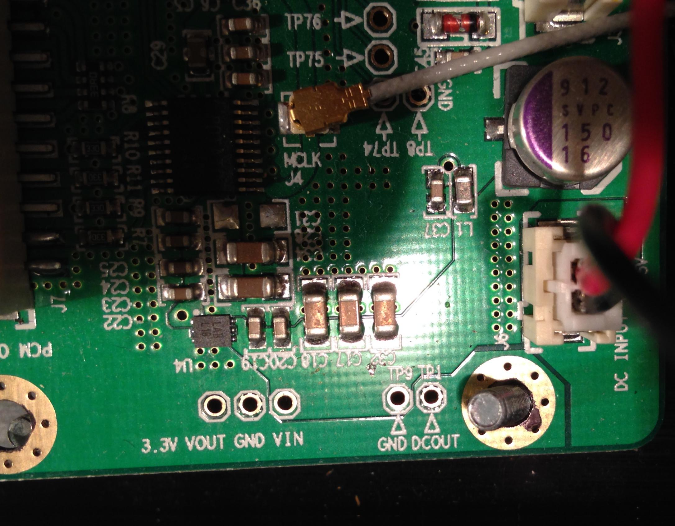

Ian, I see there is a 3.3 V out connector on the PCM-board.
Can that be used to feed the isolator on the WaveIO? (I have no FIFO)
And. Maybe add a small resistor (4.7 ohm) or a inductor, and a small capacitor (20 uF)?
regards
albert
There are two output holes that refer to a 3.3 V out: two are also designated as TP. That marking TP would indicate these are not for regular use.
I want to get rid of a separate power supply for the isolator on the WAVEIO. And that part of the isolator is not galvanically isolated fro the sim board. So my question is again:
Can I use the left output for the purpose of feeding the WIo board output??
Is it indeed regulated and derived from the 5 volt input?
Please suggestions.
Hi Albert,
How do you feed the MCLK of the PCM board ? From the Wave I/O ?
In this scenario, I'm not sure but the isolator has no interest has the MCLK output from the Wave I/O has a direct gnd connection before the isolator to the PCM board (I mean if you use (strongly advised) a 10" UF-L wire ! Here I advise you the uf-l non isolated I2S output of the Wave I/O to the PCM Board : I can testimony it's sounding good on a TDA1541A : the combo NDK Crystal without the little jitter given by the main isolated non uf-l plugd+ PCM board sounds defintly Good !
In an other scenario you would not have the IanCanada Isolator (which is quieter than the Wave I/O in term of Jitter) as well but the IanCanada Clock instead using the MCLK of the Wave I/O : you could use this voltage output of the PCM board to feed the isolator of the Wave I/O !
Anyway and always in this second scenario, you should try the Wave I/O non isolated outputs with the uf-l plugs and let you ears decide if you hear a difference or not ! I personnaly prefer the non isolated output with true uf-l 10" wires : connection is cleaner, 50 ohms connection is guaranted, and each I2S signal is cleanly shielded with a close return of the signal through the gnd surrounding cable of each uf-l wire.
And Ian could tell you than I already shorted a PCM board because the risky plug of the isolated Wave I/O where the voltage pin is close to the gns and I2S pins ! So uf-l wires is less DIY but Hassle free and better sounding solution (IMHO & YMMV).
I don't remember but is it not 5V needed for the Wave I/O isolator chip ???
regards
regards

Need a tip please :
It's not so clear to me at reading the I2S to PCM board manual :
Is there an other way than removing by desoldering the embeded LDO reg when feeding the pcb with an external low noise power supply ? Or can it be bypassed by the sided 3 unpopulated vias ????
Today I repluged my AYA II TDA1541 DAC but just with the Wave I/O non isolated side to the PCM board via u-fl wires (no external clock but the one of the Wave I/O)
Thanks in advance, regards
Eldam
I think you have to cut the enable pin trace to disable it. However, I desoldered the LDO with a hot air gun. You can do it in 30 seconds. I replaced both the LDO on clock and PCM boards with LT3042 and the result is fantastic. Noise is such an important factor on audio equipments.
