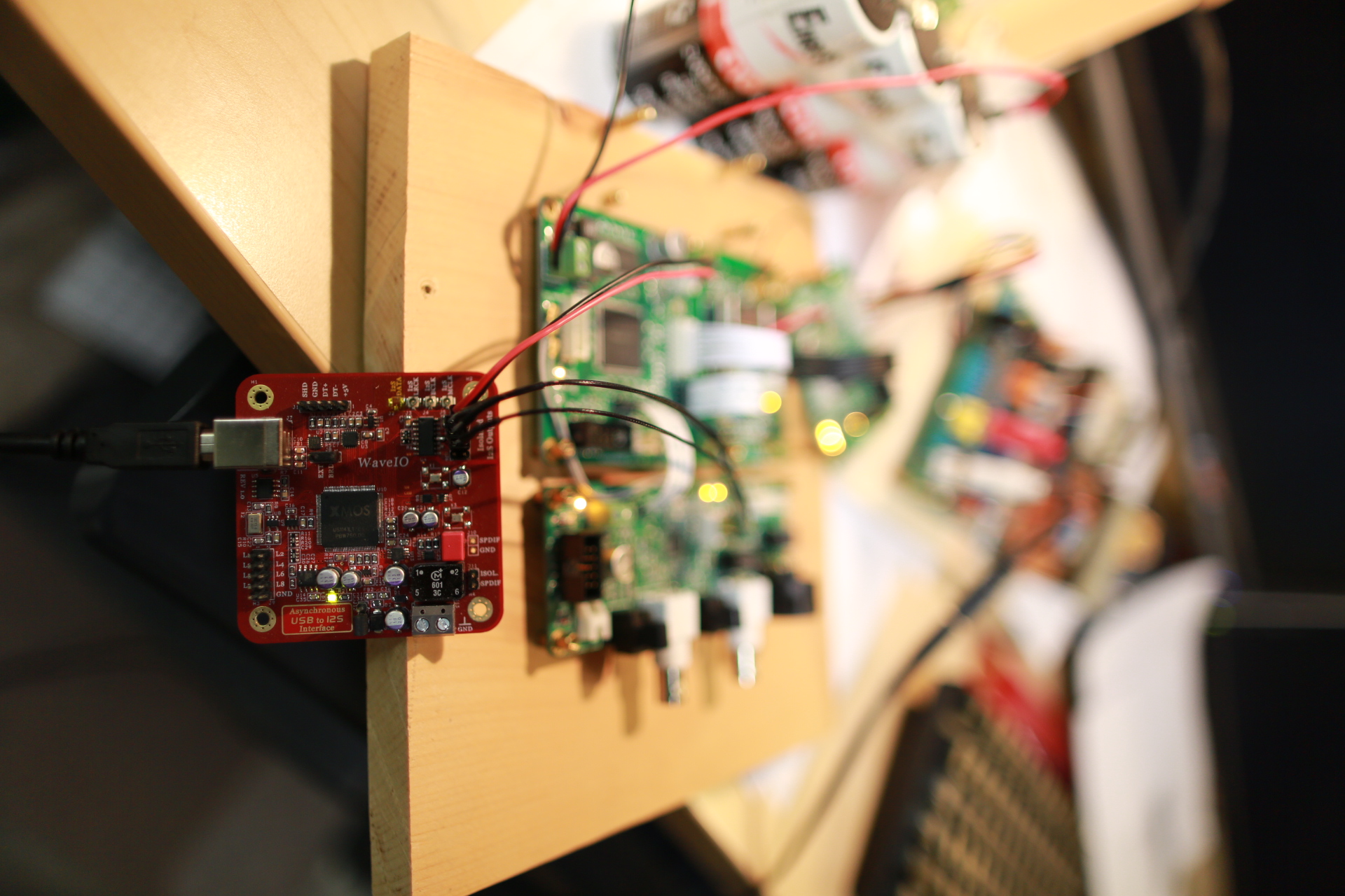

TDA1541A 384KHz with PCM board and FIFO
Back in December 2013, I connected an I2S-PCM board between a WaveIO and my diy tda1541a dac and also could not get it to work properly with music with a sampling rate higher than 96kHz. I puzzled over it for a while and wrote about it on this forum (post #603 to #622) but there was no resolution. Then I installed the FIFO, isolator, and clock boards and 192kHz music played successfully. I did not do anything other than install the FIFO, isolator, and clock boards.
Ian thought the problem may have been caused by a ground loop and EMC noise, and that was cut by the addition of the isolator.
I eventually upgraded the crystal oscillators to the higher frequency Crysteks and even though with the higher frequency clocks I should have been able to play 352.8kHz and 384kHz material, all I could get was music masked by a lot of noise. Since the ability to play material of these frequencies was not critical to me, I didn't pursue the matter further.
Perhaps my issues with I2S-PCM board and tda1541a dac and higher than 96kHz material may shed some light on the matter.
My layout and wiring:
423925d1402865602-asynchronous-i2s-fifo-project-ultimate-weapon-fight-jitter-waveio-fifo-iso-dual-clk-pcm-1541a.jpg

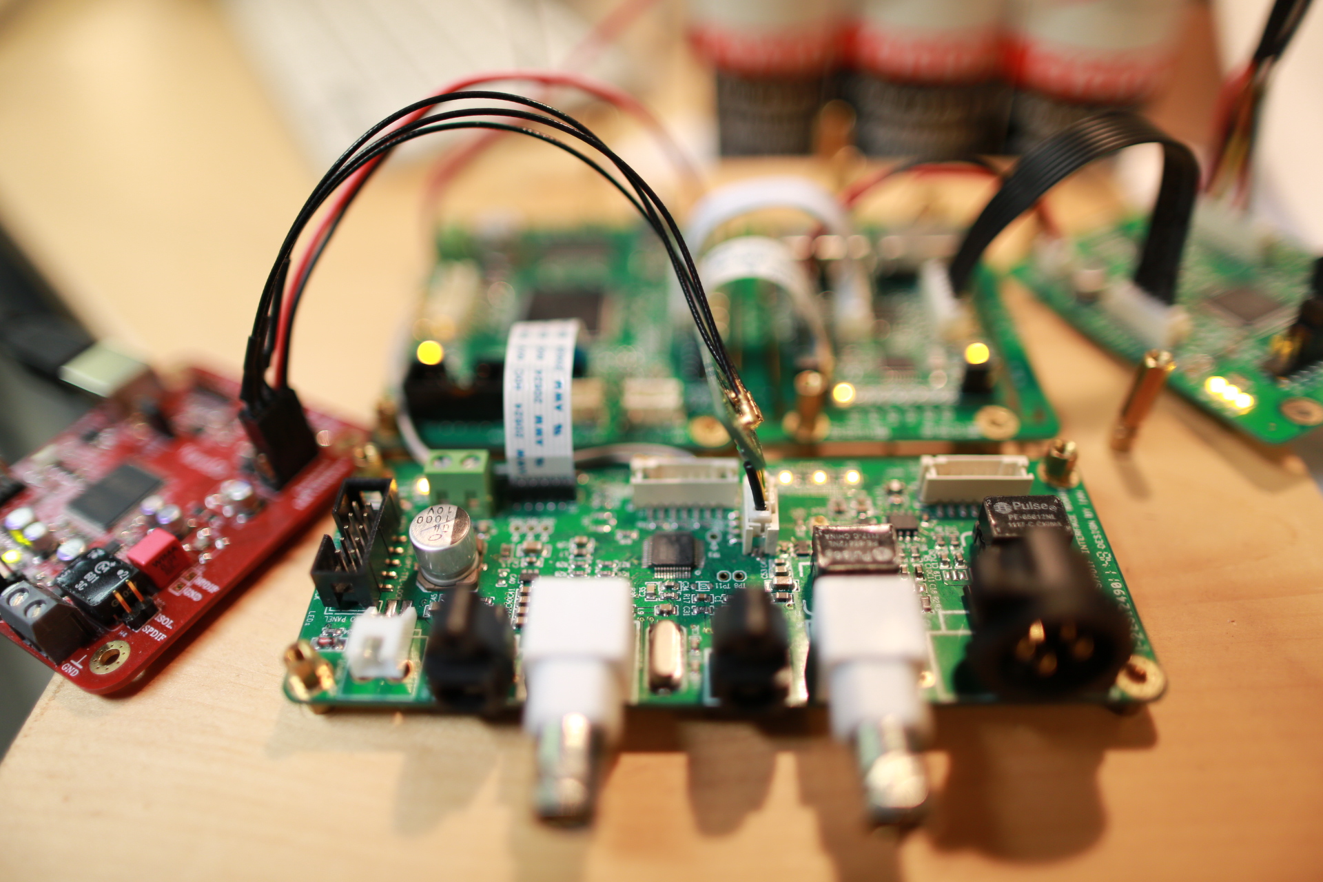

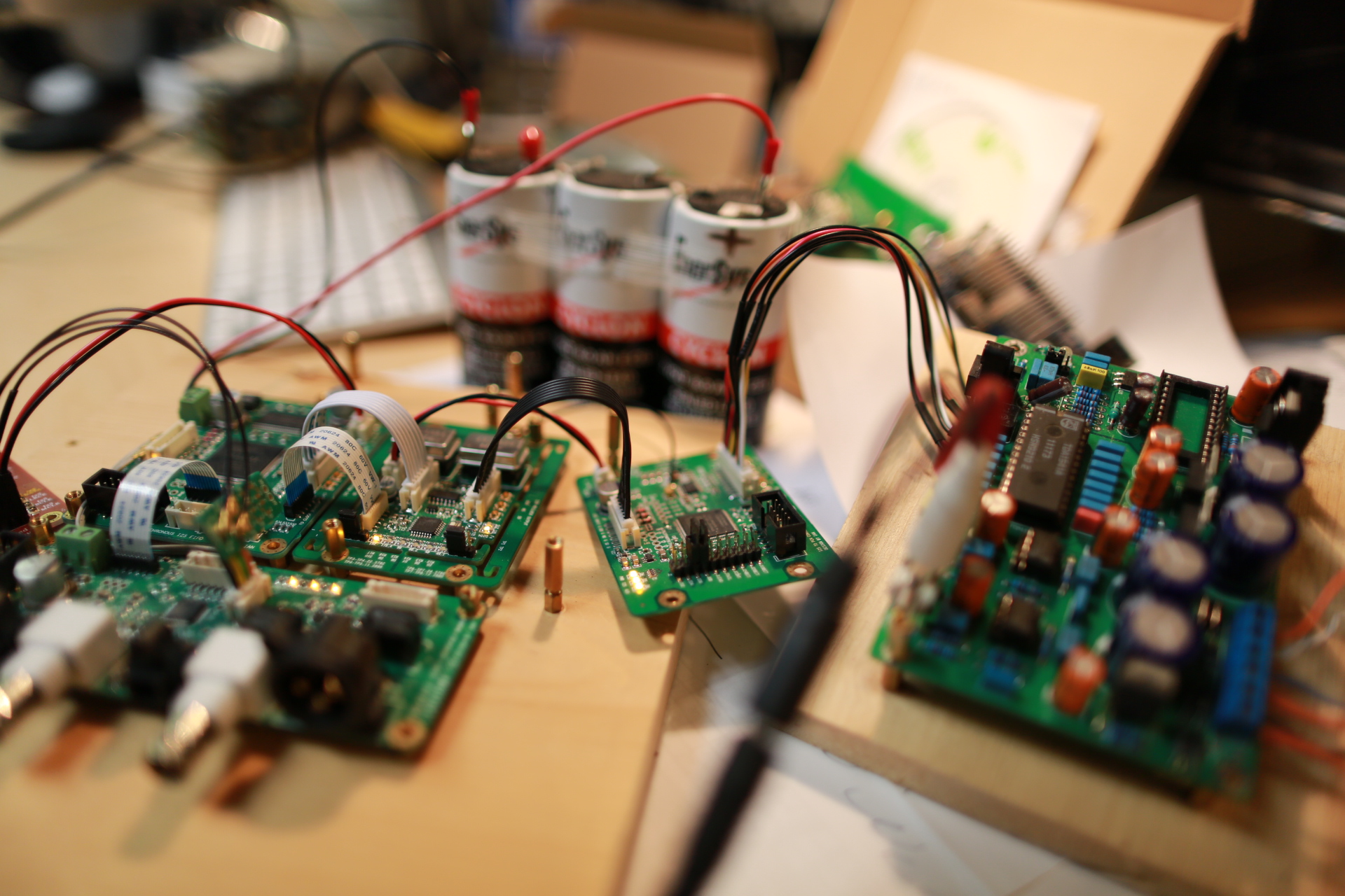

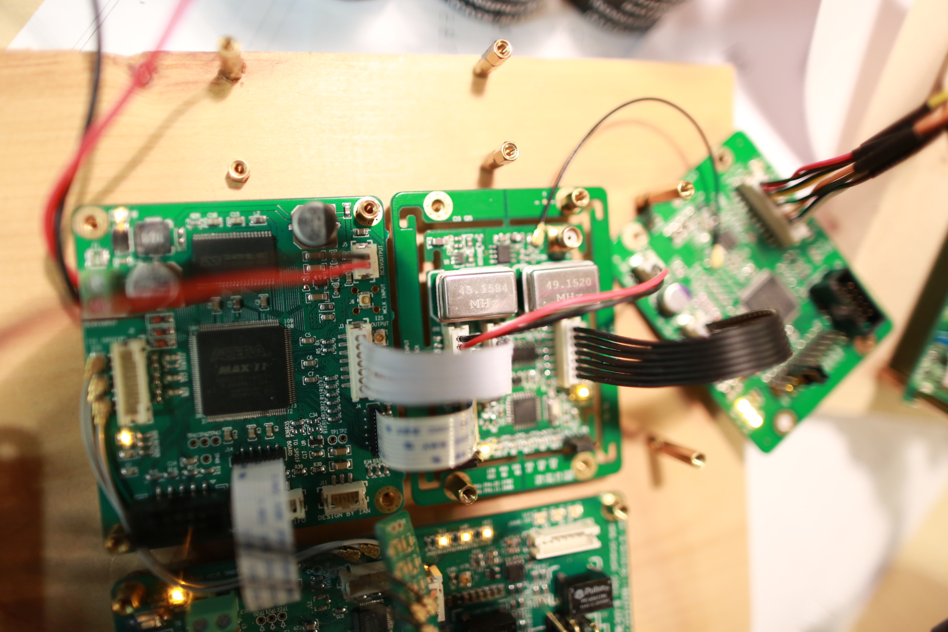

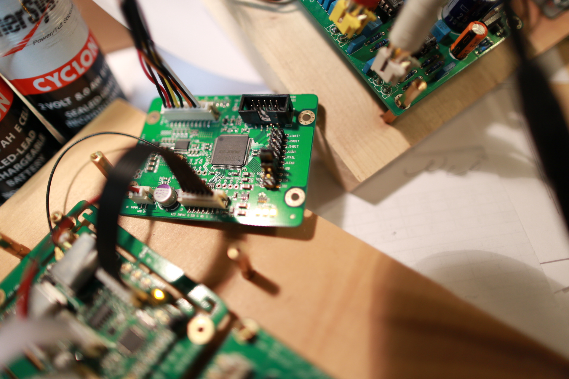

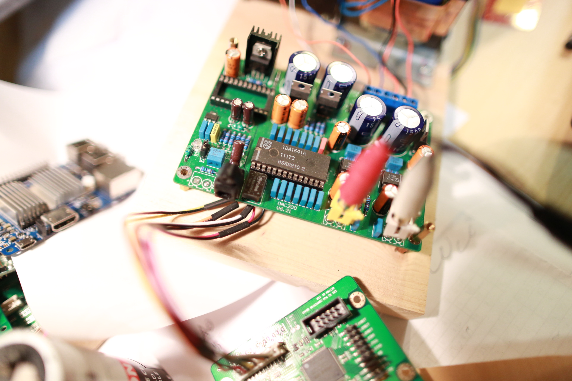

Hi Ben,

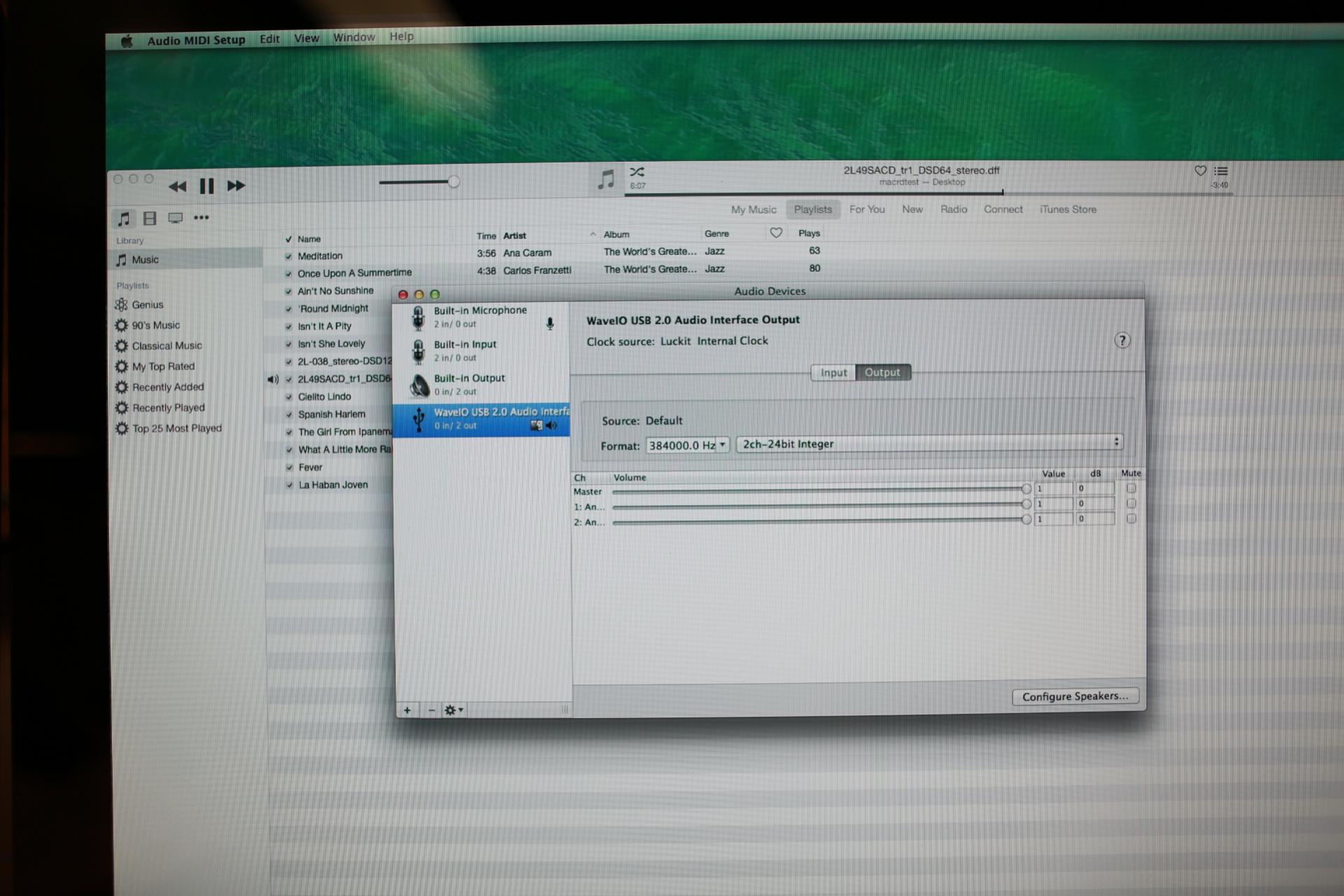

I just re-do the 384KHz test on my TDA1541A DAC today. It was running perfect without any problem. I really love the sound of TDA1541A palying at higher Fs. Very warm and classical style.
My setup was:
Mac (384KHz upsampling) +WaveIO isolated I2S -> Ian FIFO -> Dual XO (45/49MHz) -> PCM board -> TDA1541A
The PCM board has both JOB and JHALF jumper shorted.
PCM board was designed under low jitter sync logic technology. It has bit high requirement on MCLK and I2S quality. It might be reasonable if it can not go higher Fs with XMOS. The reason I have mentioned before.
I didn't use u.fl cable in this configuration to TDA1541 (u.fl could be still better), but I paired each signal with returning path(ground wire) and grounded with careful. That's also very important for signals in RF range.
Please see pictures I took today for details.
Ian

Hi triode_al,
I really don't know what's the physical Fs limitation of TDA1541, you can send the chip to me if you want me testing it at same cofiguration of my TDA1541A.
Ian
