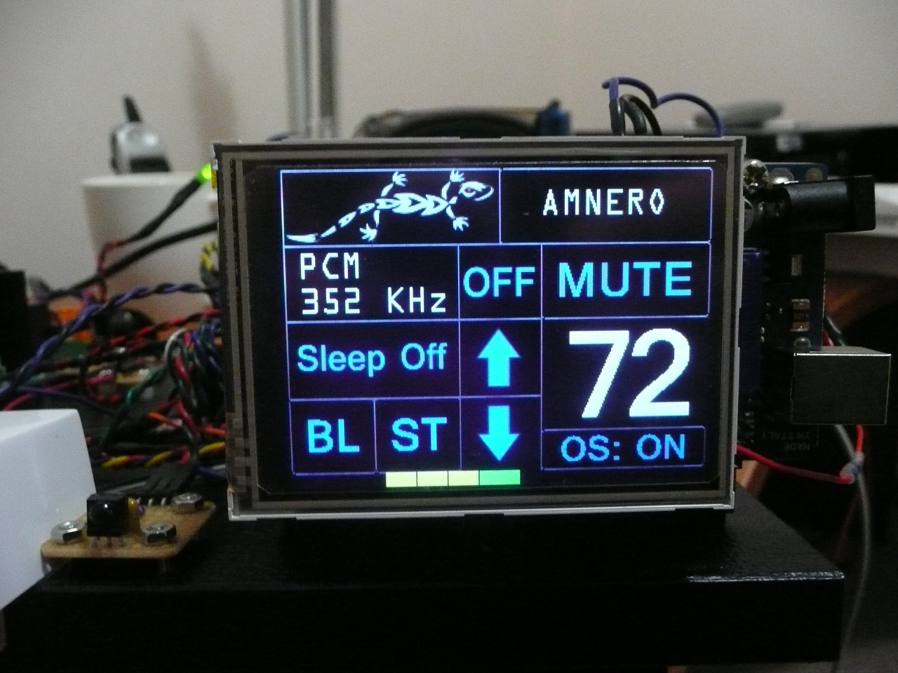

Ever since I started the DQ DAC 1 build (12 mths ago) I have been trying to get the Touch Screen function on the various screens I have used to work but to no avail. Now I have rebuilt DAC 1 I thought it was time to try again, especially as Henning has released extra Libraries to assist in that area.
After many hours of coding & recoding it finally all came together, I'm sure somebody with more code experience could have got it working much quicker than I did.
I have created what I call a simple screen that is the default display & the standard HiFiDUINO settings screen is called as necessary.
The touch screen is a work in progress.
Of course I could not have done this without the assistance of many Diyer's, to whom I thank again
TP BIII Arduino Mega DAC Build Touch Screen - YouTube

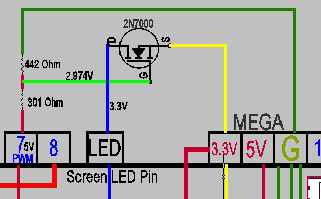

Ive had to do minor modifications to the screen to get to the backlight so I can dim it or turn it off when the DAC turns off. Originally I wanted to turn the whole screen off like I do with DAC 2, but if I do that the Touch function causes the code to lockup. The screen supplier has previously advised me that rather than using resistors to lower the voltage (from 5v to 3.3v) and using the PWM to dim and or turn off the screen. I am better off using a transistor to do the job.
But I cannot get it to work & it has go me seriously confused. I have set the transistor up like the attached diagrams. The way I assume it is suppose to work is, when the PWM voltage from Pin 7 is applied to the gate the transistor turns on and off (just like the PWM) so as I adjust the duty cycle of Pin 7 the voltage at the Drain will change. I have attached the 3.3v from the MEGA to the Source but I always have 4v!!! not 3.3V at the Drain even if there is no voltage at the Gate.
Can anyone help with this? please

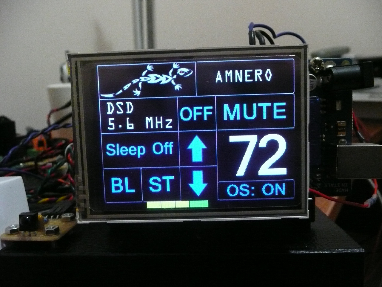

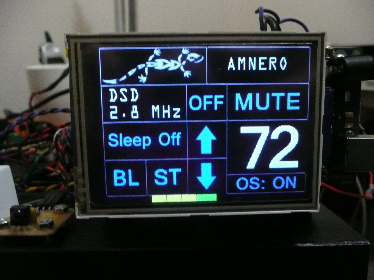

Another personal mountain has been climbed, a long time ago I set my sights on being able to play Hi Res music, at the time I was only thinking 192khz. I was very happy when I got the Amanero feeding through the sample rates you see below.
It really is only a academic exercise though, as in the near term I wont be downloading may files of this size to play. It's always very satisfying when you get where you want to go.
If you look closely you will also see the Oversampling is On & No dropouts, it's been a good night.
Many thanks to HiFiduino for his great blog & help.

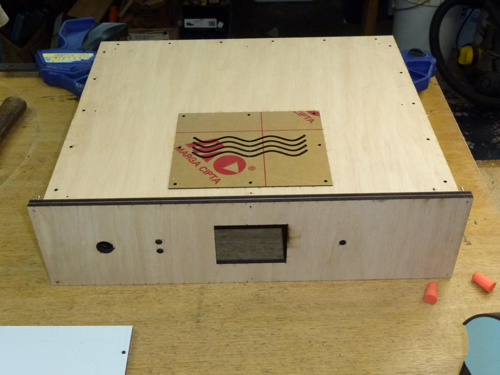

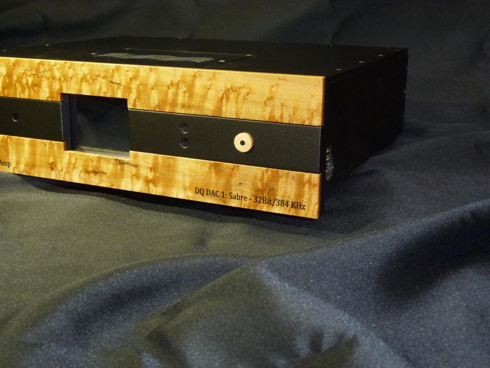

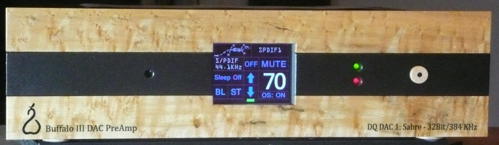

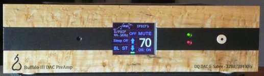

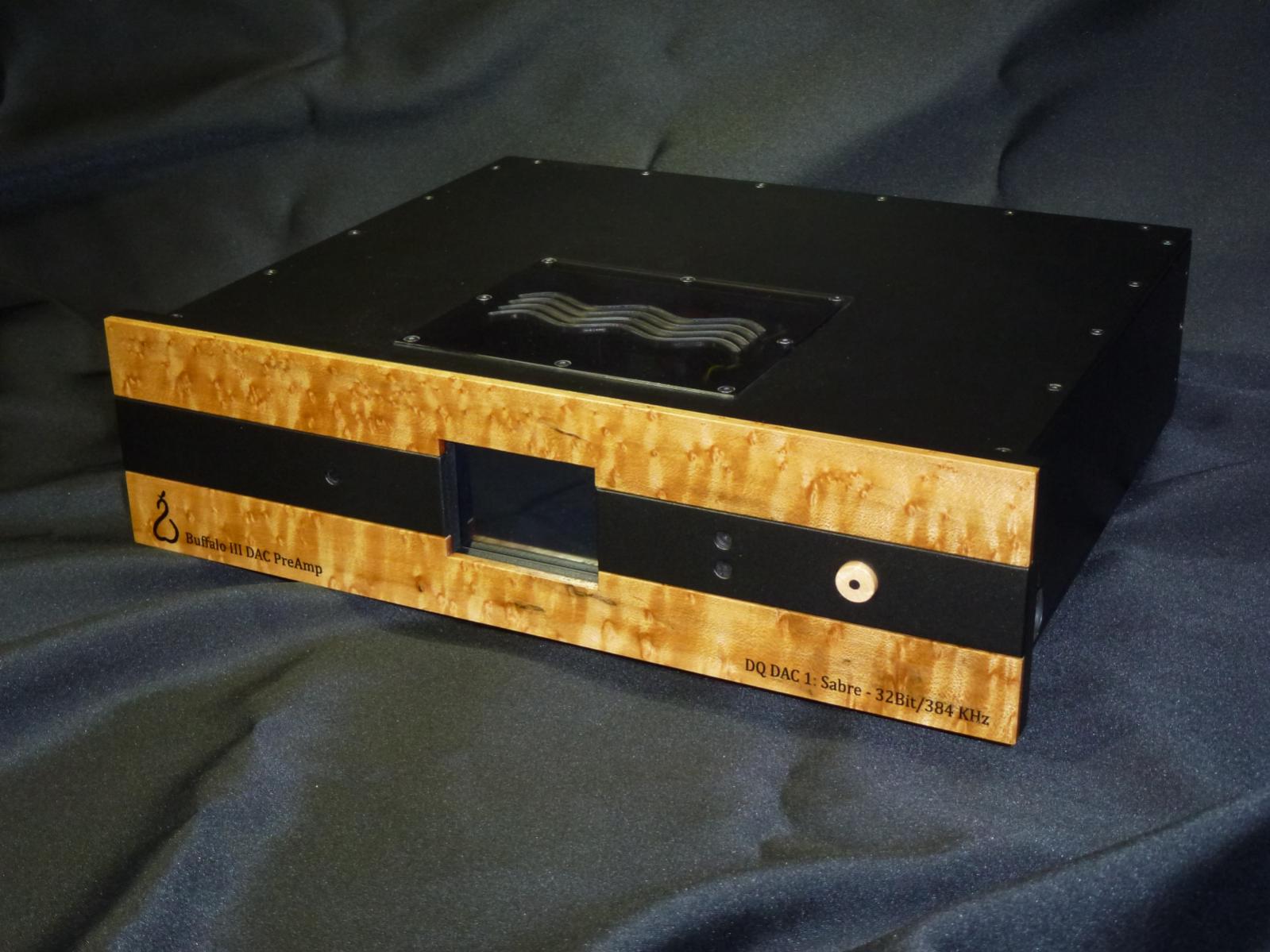

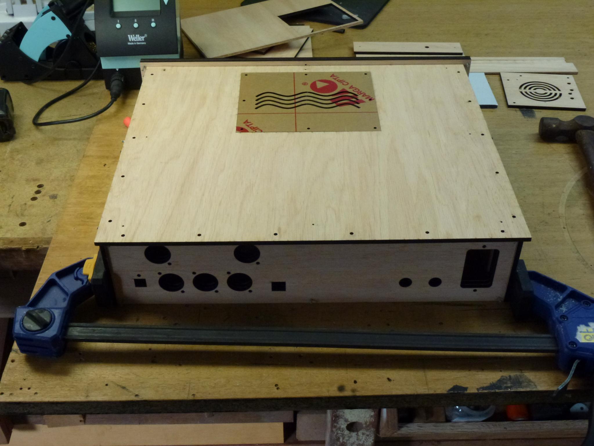

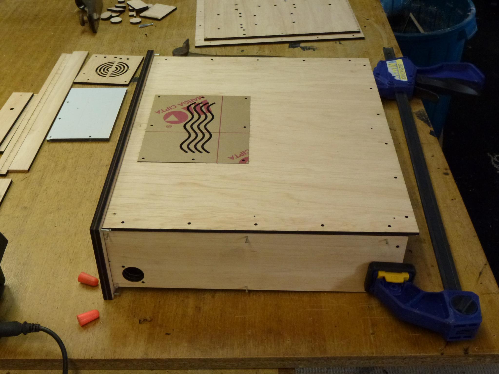

Finally it's time for the case, plywood, carbon fibre, perspex & Birdseye maple
I did manage to draw the top outer leaf & the bottom outer leaf the wrong size but fortunately I made them too big.
This will take a while I imagine.
