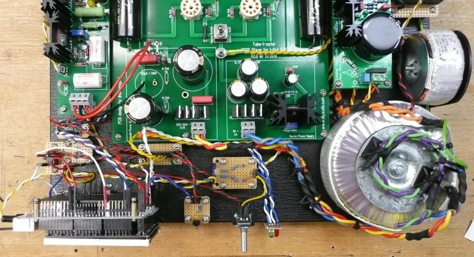

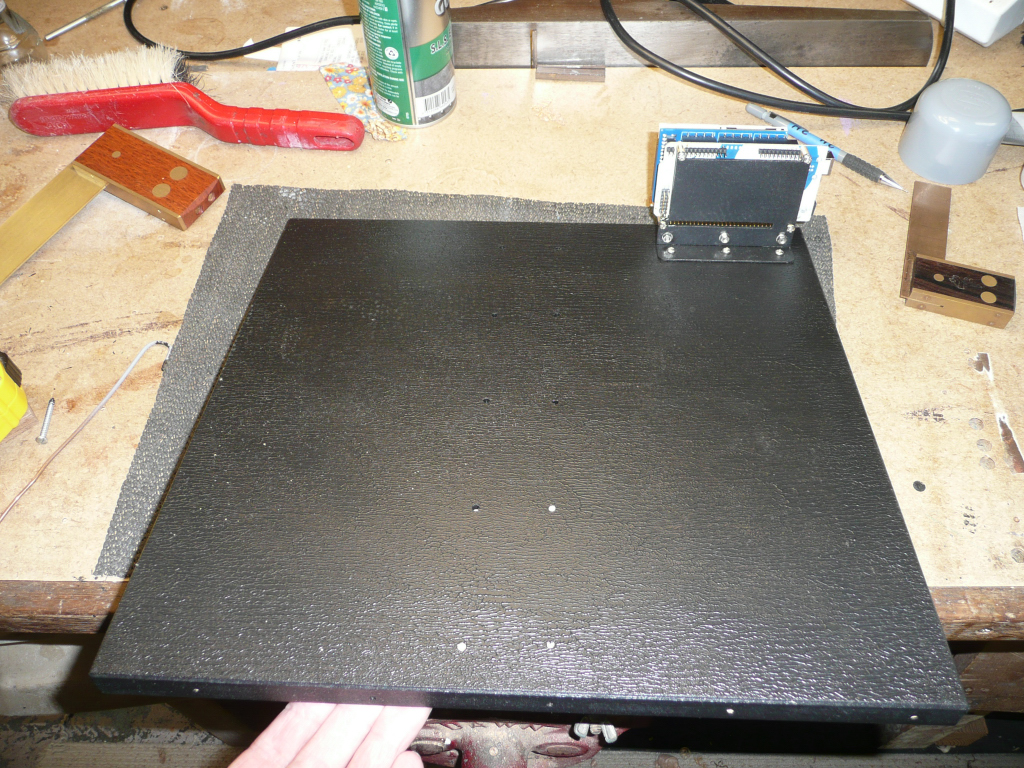

I've made the prototype board the same size as the planned internal dimensions of the final build.

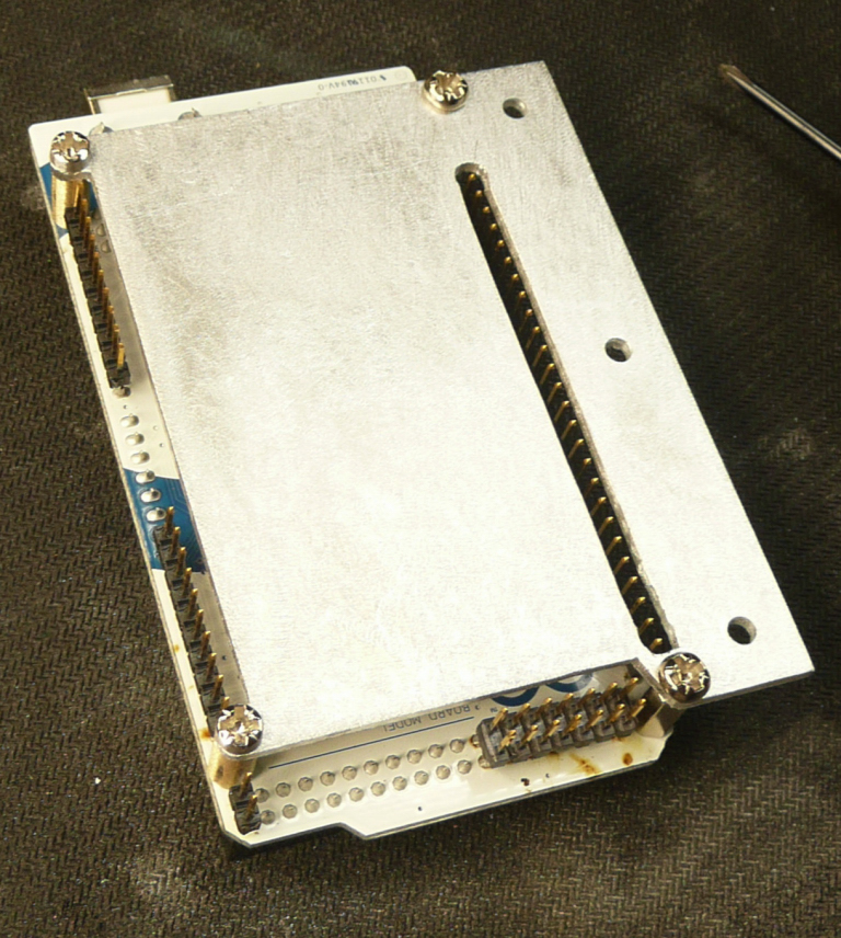

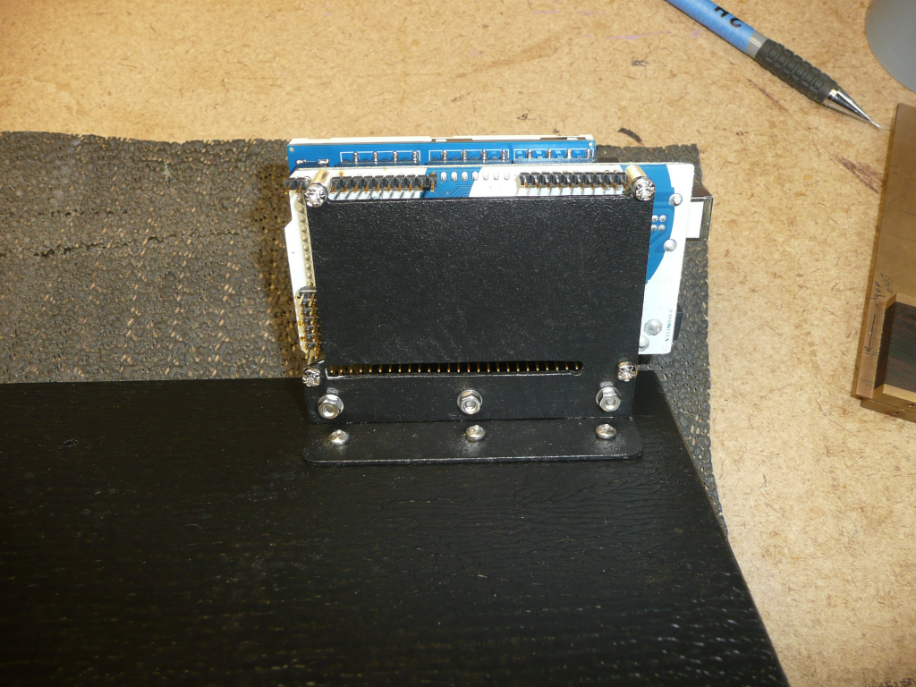

I have soldered header pins onto most of the Mega pins that aren't being used by the screen and made the bracket so they can be easily accessed.
I wont have much time in the next couple of weeks so it is going to be slow.

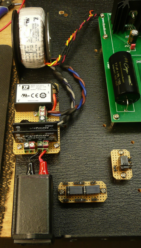

I am using a soft start module from here: http://www.hypex.nl/docs/softstart_datasheet.pdf
This allows me to use a push-button on/off rather than mains switch but your arduino solution is much more elegant. I will have to check out the whole arduino thing as I can sense a stage 2 and 3 coming to this project!

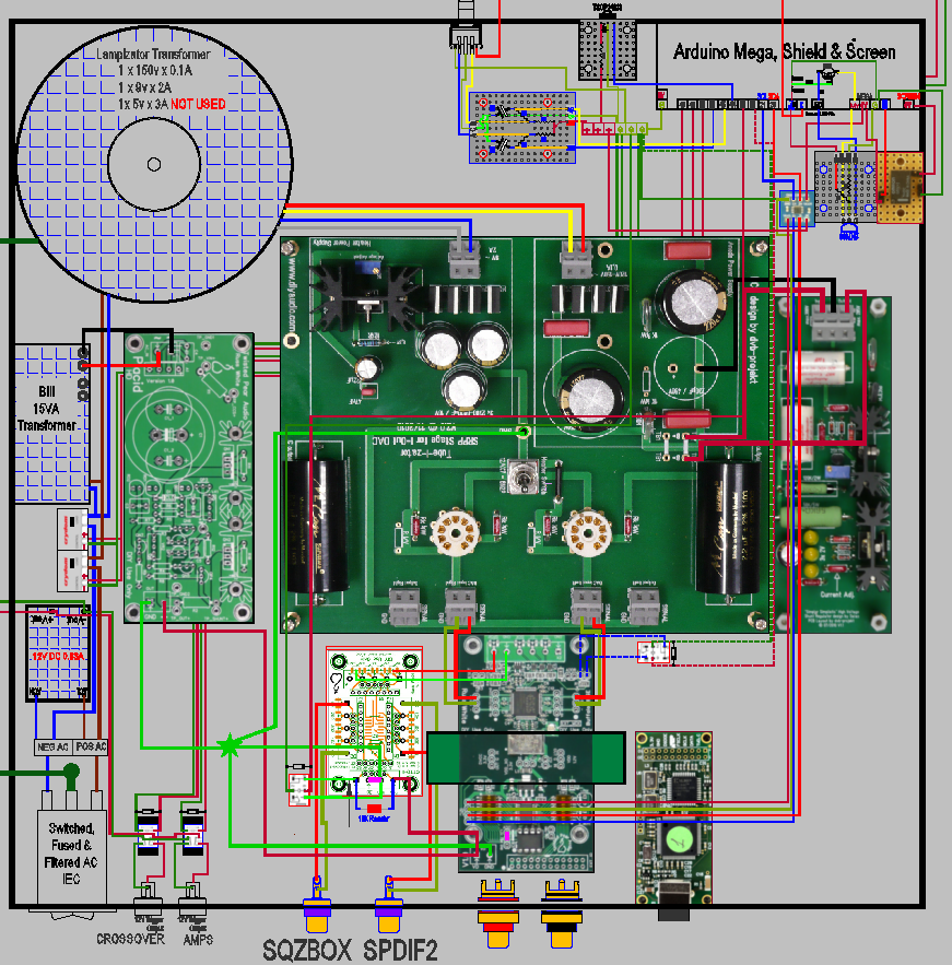

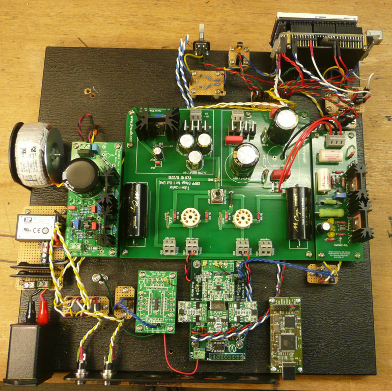

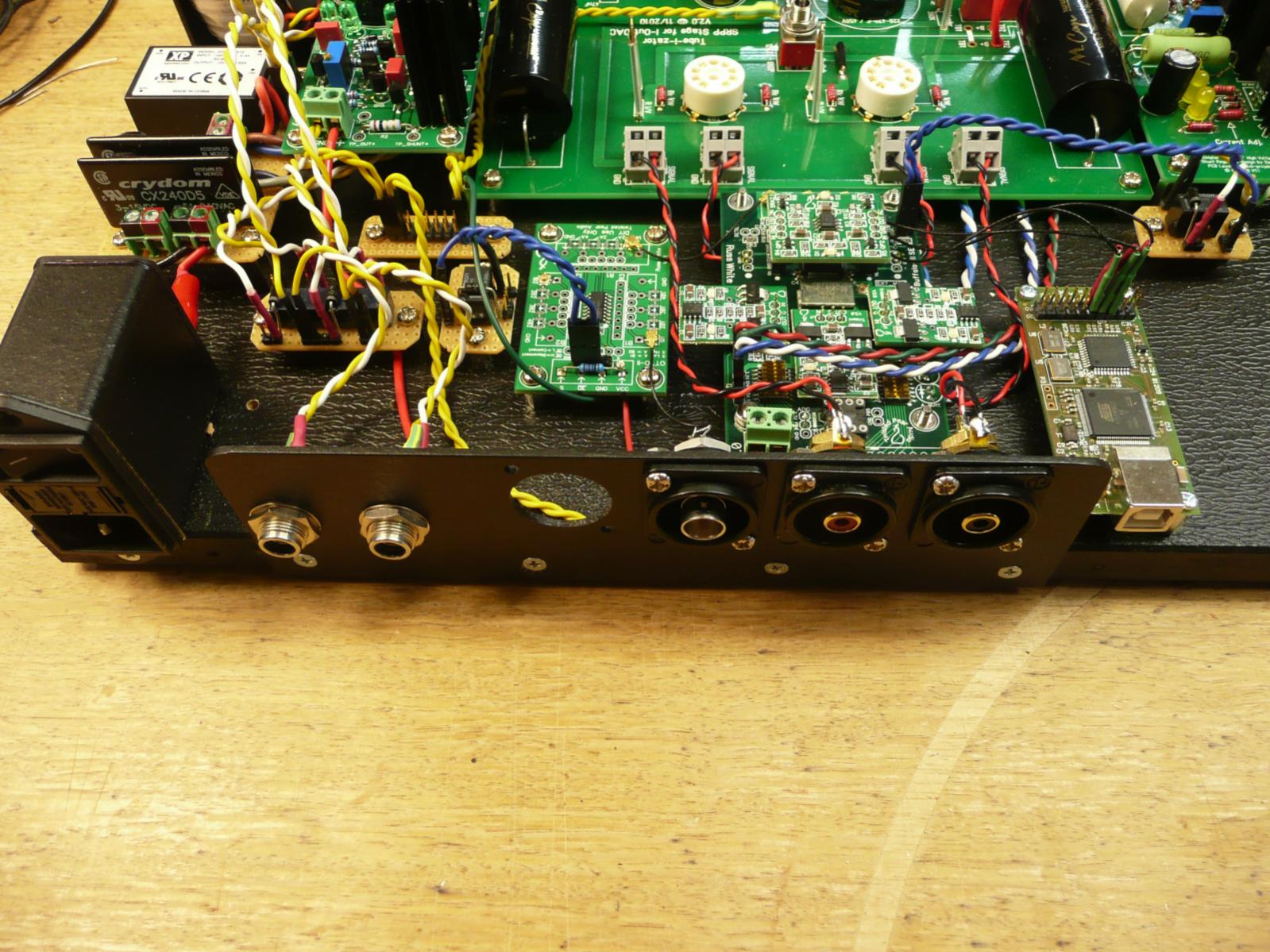

In the first instance I have decided to go with Version 5 & will move on to V5a once it is up & working.
V5 uses relays for the Source switching & the SPDIF/DSD switching. The Arduino & BIISE are isolated except for the I2C connection, V5a will have an isolator on the I2C. The Amanero will not be isloated in this version but will be in the V5a version.

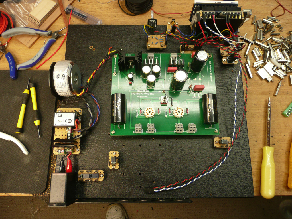

Have made a start on the wiring but things will progress slowly due to time constants, my fancy soldering iron stopped working last night so this morning I dragged out my old iron which came directly from China, what a difference, can't wait for the new one to be fixed. Fortunately it is still under warranty 🙂 It's a bit disappointing that the new Weller which cost 3 x the Chinese one stop after 11 months of light work & the Chinese clunker is still going.

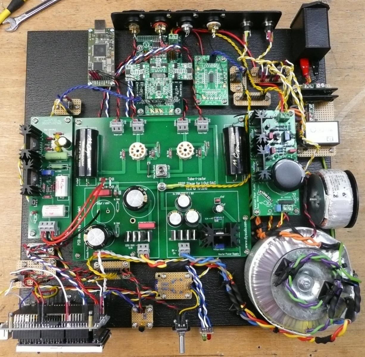

I noticed one thing missing on the wiring of the shunt to the tube-i-zator board. Shouldn't the return wire be connected to both sides of the audio out put stage (basically, the next pcb-hole to the left of where you have your return connection coming back from the shunt)?
Just saw your version 5...looking good ;-)
The wiring got the tick of approval from Oliver so I assume it is ok. http://www.diyaudio.com/forums/group-buys/156149-tube-i-zator-professional-pcb-74.html
The wiring got the tick of approval from Oliverhttp://www.diyaudio.com/forums/group-buys/156149-tube-i-zator-professional-pcb-74.html
Yeah, I saw that and I will be happy - and apologetic ;-) - if proved wrong but I do think it's worth another look. With the wiring as it is shown in your diagram, I can't see how the second valve receives any voltage. In other words, as I see it, we have to apply the return from the shunt to both points TB1 and TB2...not just one or the other. You currently have voltage going to TB2 which will supply the valve to the right of your diagram but I can't see how it would get to the other valve.
As I say, I'm only re-learning, having not built anything electronic in about 20 years, and I'm willing to learn and be told why I'm wrong...just trying to help.
Getting there slowly, I have made all of the custom bits & pieces, but it may not be until next weekend before I get to put the rest of the bits on the board. I'm also building a bedside table & starting a Sub for the son's birthday which isn't far away, too many things to do so little time🙄

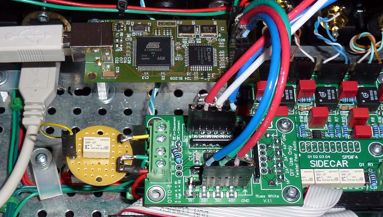

As you may recall I use a Sidecar and added an OTTO II to switch between my Denon I2S and Amanero USB to I2S module inputs. I am using HiFiDuino/Corpius modified code. Setting I2S for the input selection pulls Sidecar HIGH.
The problem I had was the OTTO II would remain switched to input 2 when connected to the Arduino whether pin HIGH or LOW. When the Arduino UNO pins are set LOW, pin 7 had .009v DC. So does pin 6, etc. (Kind of surprised OTTO will switch with that low a voltage). To fix I made a relay board; now zero volts to S on OTTO when Arduino pin pulled LOW.
I added code to the input to switch OTTO HIGH for my Denon and LOW for my USB module. Worked great as long as I went clockwise with encoder or remote. If I went CCW, the OTTO relay would remain HIGH. This is what I did to fix it; add digitalWrite(OTTOPIN, LOW); to all other menu selections. Now I can go in either direction wih source selection and it works properly. You may have to do this too.
This code is located under:
void setAndPrintInput(byte value)
case 0:
digitalWrite(OTTOPIN, HIGH); //Switch OTTO HIGH to select the Denon. LOW for USB
lcd.print(no0);

I am pretty code challenged so it just hit me....I could have just added a LOW command to either side of the Denon input. Denon is case 0 so just add LOW command to case 1 and case 5.

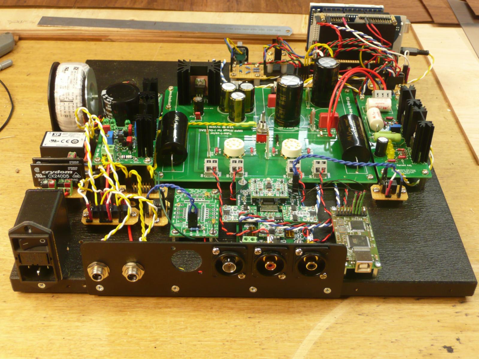

Getting closer all the time. The first TP/Arduino DAC that I build sort of evolved over time, where this one is straight to the end game, well almost. What are the chances of it all working first go 😀 Slim I'd imagine.
