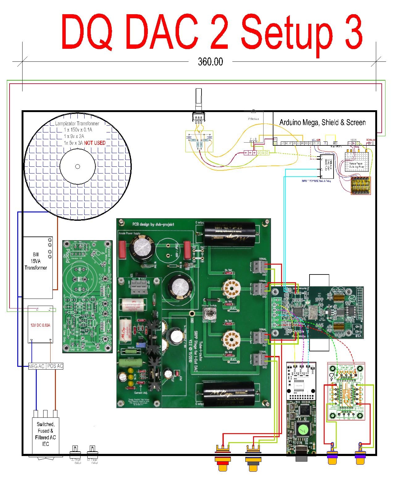

Before I get too far again I would greatly appreciate any input on the latest iteration. I have tried to get a good Jpeg that you can view from the thread but the only way I can get a reasonable quality is to save it as a pdf. There are a lot of bits that are not connected in this version but it is the general layout that matters. I have taken the advice given, to do this I had to make the case bigger than originally planned. I have added an OTTO to switch between the 2 SPDIF inputs. I'm not completely sure how the Isolator reclocker is to be wired to the BIIISE, or how the OTTO connects to the Mega or do I connect it to the BIIISE?
Hi DQ,
Looks good to me (I did originally comment on SNA but since qusp is replying over here it might be more logical to keep all comments on here, perhaps).
One thought, are you limited to height of the enclosure?
It may be worthwhile pulling the IV stage higher and slide the BIII-SE underneath it and shorten the BIII outputs even more. You could then stack the arduino level shifter above the arduino board and run longer lead wires for the spdif switching into the enclosure, say on the 'front' side of the BIII-SE rather than currently close to the back of the enclosure and pull the case narrower if you wanted? That way the amanero board would be on one side and the otto would be on the other side of the BIII. Does that make sense? It has been a long day here so I might not be as clear as otherwise :/
What dimensions of the enclosure are more critical to you? Height/width/depth?

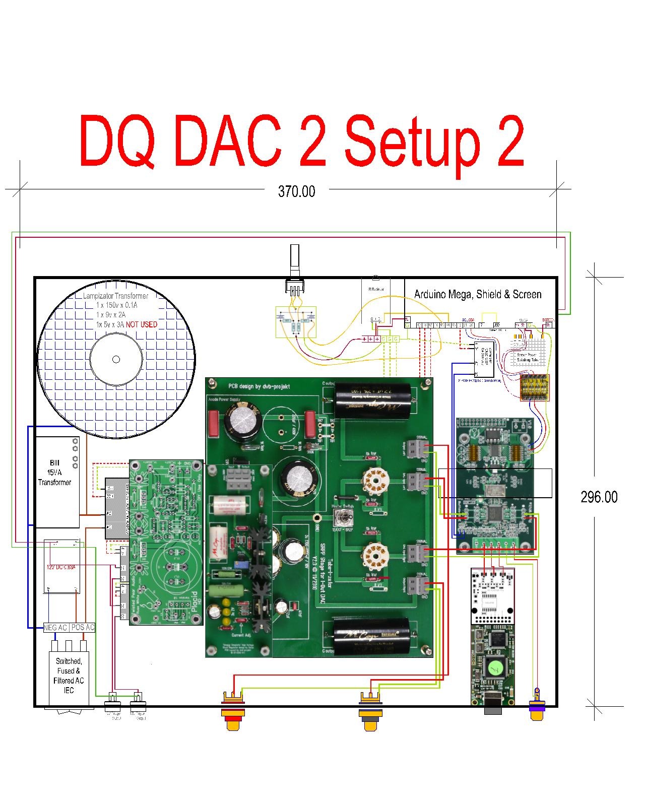

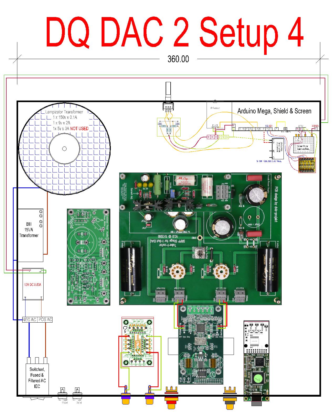

This is the best I can do re resolution, here are versions 2, 3 & 4

I caught your advice on SNA & applied to to one of the versions, It's getting confusing 🙂
I'll read through your last post after I post this, thanks

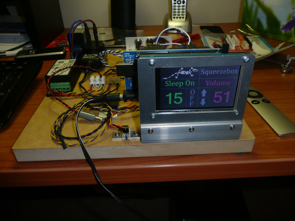

Setup 4 looks the best to me as long as having long I2C lines to the BIII from the Mega isn't a big problem.

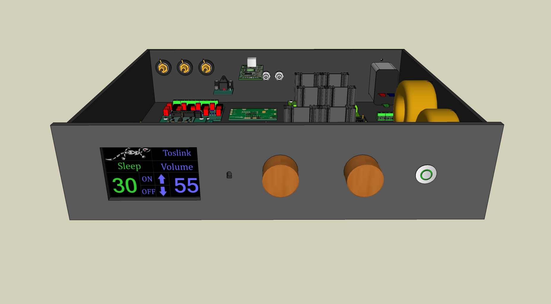

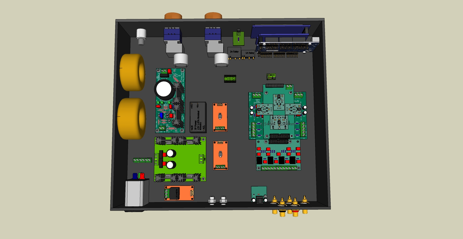

The idea with the Mega is to have it at the front corner as per the Sketchup Jpeg so I can connect the USB with ease in the future, the Sketchup Jpeg is of DQ DAC 1 which is playing at the moment but still in it's prototype cloths as per the photo.

I was wrong the dimensions of Setup 3 & 4 they are fine 360W x 355D the internal height needs to be kept to 75mm as the finished design needs to be no bigger than one of the amps I built.
If I move the BIII under the I/V stage it's going to make getting to things difficult & I hate that 😀

And the tooooooobs out the top of the 75mm enclosure or included in the 75mm?
I am familiar with the aussie amps enclosures that you built from your SNA thread but man they look good, still. Didn't know they were 'only' 75mm tall. I just received some 151mm x 300mm conrad heatsinks arrive here this week for my next amps 🙂
I like the idea of the Toooobs out the top but I dont think it's going to happen, fortunately the tubes are only 45mm high (Full Music 12AX7)

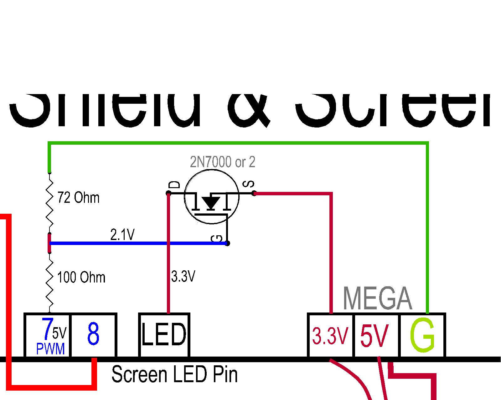

I want to dim the LED backlight to the screen I will be using, in the past I used the Arduino PWM output with a resistor in series to dim the backlight.
The manufacturer says I should ideally be using a transistor to do this & was kind enough to send me a mud map of how to go about it.
In the drawing below I have shown what I think I should do to make this work but I am not sure I have got it right.
The theory is that the LED backlight is supplied via the Drain & the Collector is supplied by the Arduino 3.3v output.
The gate voltage is dropped from 5v to 2.1v by the voltage divider and the gate voltage is pulsed using the PWM function to turn the transistor on and off, the frequency of the PWM is changed to dim the LED.
Can anyone confirm I have this right

Looks OK
