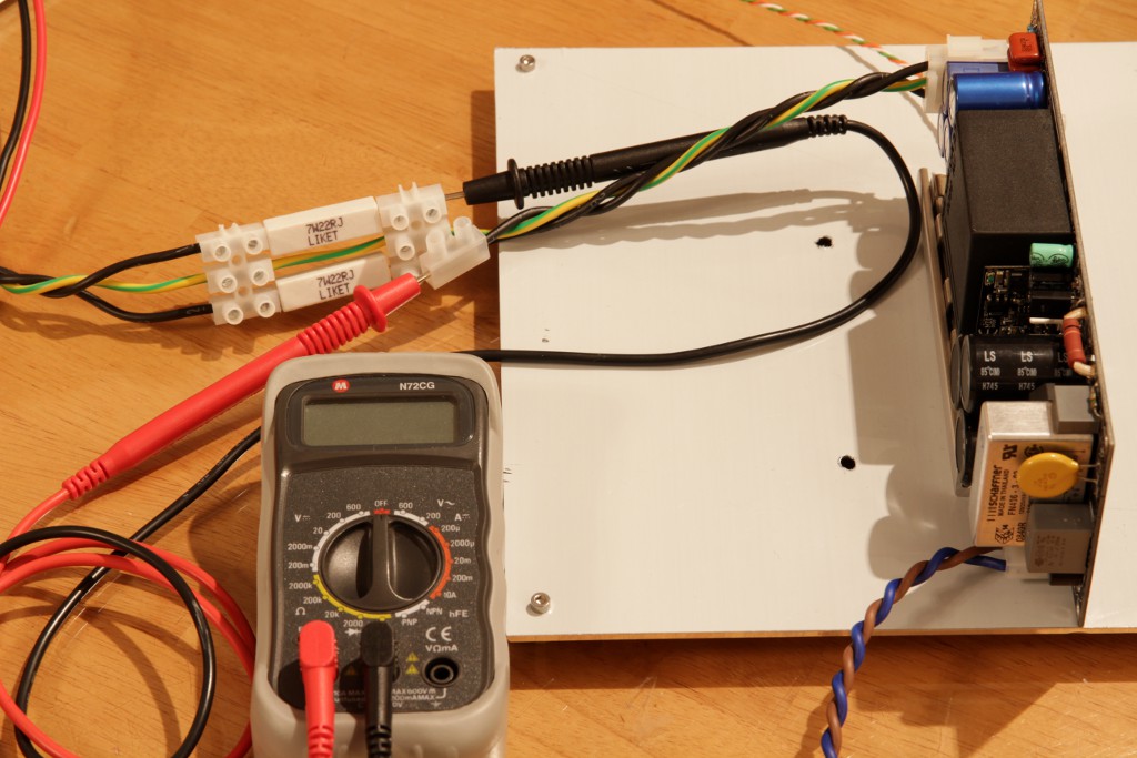

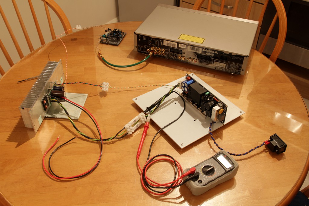

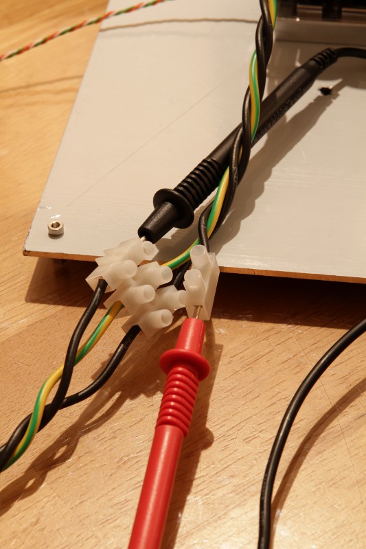

Those pics of how it was wired...
Not included the speaker [Mission 78cse 8Ohm] or mains leads.
Ran the setup friday night & saturday night for roughly 2hrs total with the resistors in place. Sunday; removed the resistors and it started fine without the O2/cd player connected. On for roughly 10 seconds before it was turned off. Connected the O2/cd player and turned on source - O2 - dps-600. unit started up then after roughly 6 seconds shut down with both led's blinking.

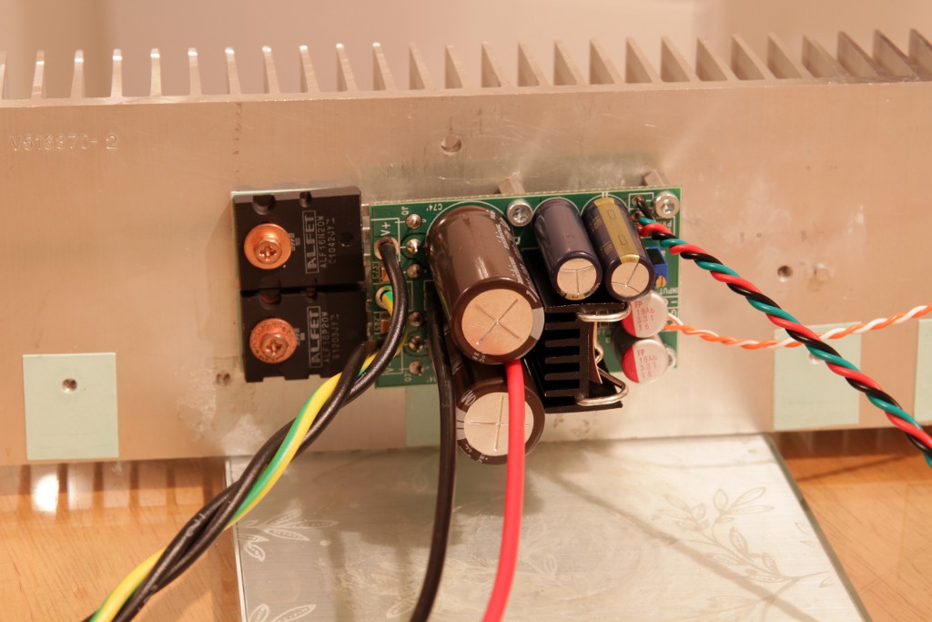

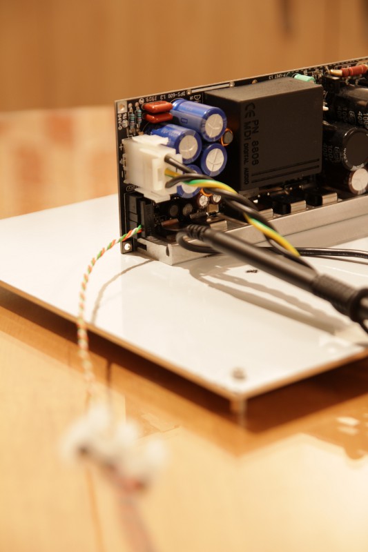

Some advice independant of all:
HeatSink is better connect to base panel of dps-600.
Connect heart of dps-600 (see my old pic for this) it is necessary,specially in this your connections.
Bias measurements:
in the measurement of bias, considered that the flow is transverse (not affected the load (speaker).
At 400mA,with your voltage setup, wire-amp dissipate 38-40w (only Mosfet) ..simple info.
