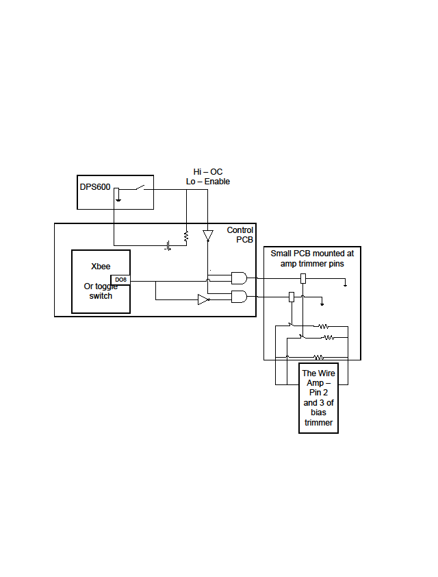

I had some time at lunch today ... and drew this up quickly. So I need 2 inverters not the one I thought I needed last night. This allows the resistors to be selected for each bias level. Does not show decoupling caps to smooth switching transition on resistors or on logic lines. Low EMI optically coupled NC relays for switching bias resistors.
The attached obviously doesn't include the remote control section that you showed in your drawing Roberto, I have drawn that up at home already, and included opto isol NC relay (so I did not need the inverter on input of the relay). The part I am thinking of using there has 60V contact blocking voltage and 1500V input - output isolation. I am a bit concerned about the 60V rating, is that sufficient?

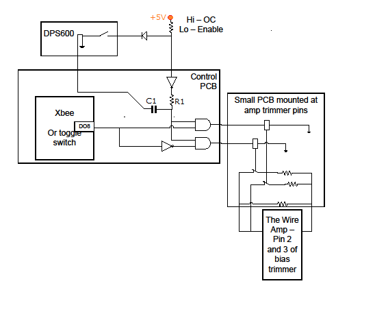

DPS-600->EN_Pin is float. independant of this, a simple small signal diode can offer a good isolation.
sure, you can do in this way for switch bias.
sorry if i modify your scheme, RC need for correct delay, you can play with low voltage smd caps eg. 1uF to 2,2uF.
becouse pin switch low after 250ms, it's not good for bias set.
Consider balanced time of caps filter and amplifier. a good value delay,i think 1,5-3 sec.
for remote control, it play in low current/voltage range, as i said before. obvius need high voltage ISO.

Thanks Roberto!
Sorry about asking the same question twice, was in a hurry and didn't think it through.
I had misunderstood the EN_Pin in the DPS600 datasheet, I had thought it switched low when voltages on output are stable. But with its operation at 250msec after power on, then like you have said, we can just add an additional delay with RC, so it is not a problem.
I'm not planning on using many through hole parts for this anyway. A few SOIC logic chips and a reg or power it all with battery since it will not require much current at all in standby, I am targeting less than 5mA for all the logic circuits. Probably MUCH less than this in standby. Xbee temp sensing and remote adds 50mA during transmit but that can be scheduled or left out entirely if not needed.
I have a few other jobs to do for the next few days. (I have a new DAC/headphone amp to finish assembling) I'll be back on the weekend with a more complete schema and in about a weeks time my first pcb layout hopefully ready for comments/suggestions.
I am trying to keep the design such that it should be easily applied for all DPS600 + LME49830 Wire users. As described in earlier drawing, I am targeting a 2 pcb solution: 1 mounted to front panel; other small pcb directly at the bias set trimmer position.

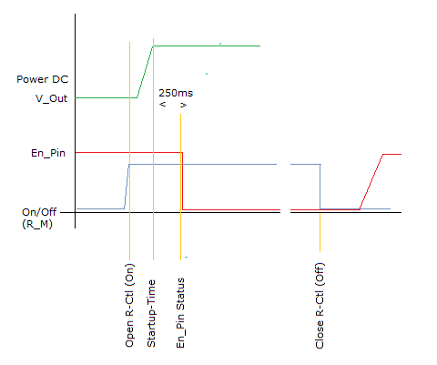

First of all...Ops! in your case not need delay becouse start ever with low bias. delay need if you use simple circuit for switch bias (auto after startup) in this case a simple bjt or mosfet or 555 (with delay 2 sec.) can drive a mini relay for bias. eg. start with 80mA and go to 400mA after 2 sec.
see startup timing, En_Pin switch to low and remaining low up to switch off smps.
This En_Pin is used in DPS-600/DA for enable driver in D Class.
I think is good if you and qusp shared complete your project.
maybe others see some solution.
Regards

Daydreaming at lunchtime again and I have just realised, we need to have feedback from bias setting relays such that the DPS600 remote on can only be triggered on when bias is at minimum. I have idea on using some of the spare logic gates in the hex-schmitt trigger inverter and hex and gate chips. No more chips needed to implement this logic.
This will mean that on power off, while RC discharge is happening, we must wait at least the period of high-bias power on delay period (1.5 - 3sec) before we're able to power amp on again.

Some simplifications:
analyze the logic states, assuming a cold start.
1-bias have preset to low;
2-Remote control switch to open (ON smps) (software reset bias condition to low).
this mean That Is not necessary hardware feedback with bias.
also, is good that smps switch off while the bias is high.
(this load, help to clean shunt down).
an idea may be (depending if you use the amp for a party).
Bias automatically switch to a low value, if the volume remains high more than 20 sec. (this should be a time of peaks).
however, I'm well available.🙂
my curiosity .. what happened to Owen? I can not hear from him for a long time, even by email.
Well, i wait your scheme.
P.S. for circuit bias control, is better a solution with small pcb on amp.
signal on pins of trimmer is not DC current set, but critical ac in driver circuit of amp. is better not use long wired.
Regards

Hi Roberto,
Later we will add temperature sensors to each heatsink as well as ambient case temp, and allow remote control to have logic to adjust bias/shutdown based on these values 🙂 In our part of Australia, despite our terrific weather, we do get some VERY hot summer days, want to protect against high ambient temps taking amplifier out of design temperature range.
Interesting that high bias is better for turn off for smps, will not worry about altering that prior to switch off. Will keep this in mind.
The bias control circuit was always intended to be close to amp 🙂
I have attached my thoughts on what a preliminary schematic and layout for switched bias pcb might look like. Opto-isolated relays are to be NC.
The bias pot has 2.54mm pitch between leads and a 2.54mm pitch pin header can easily slot into this position and allow 'auto-bias' pcb to be swapped in on a socket or soldered in place with almost no difference in proximity to pcb. With opto-isolated relays with minimal/no EMI I think this is a drop in solution with almost no compromises on performance of Owen's circuit design. (that is provided we get the R and C layout correct to eliminate transient issues during switching)
What I am not certain about is where best to place caps for smoothing any transient when switching bias resistors.
Chris

I saw good your drawings are correct. for the solid side of the relay, can not produce that "tick" or other noise when it changes state, because the circuit is already under bias current.
regarding the side of logic gates, it is best to test the outcome.
Honestly, I am opposed to the classic capacitor that is present in almost all of the amp's, right in the bias circuit (connected between high side and low side),especially if large capacity.

I have sorted out the remainder of the logic side design and qusp and I have talked it through over the weekend. I will try to build a prototype on a breadboard in the next week or two and test it with an 8ch logic analyser to ensure that all of the different scenarios check out and timing is correct. After that we'll get a prototype pcbs made.
Once I know it works at least from timing and logic perspective I will put a write up in here about that part.
Regarding the capacitor in parallel, Owen's build recommend to not populate that position on the pcb. On the bias adjust side, I was only worried about using something to stop transients in the switching period. I might just leave positions for it on the pcb and can populate them if they are required based on testing.
