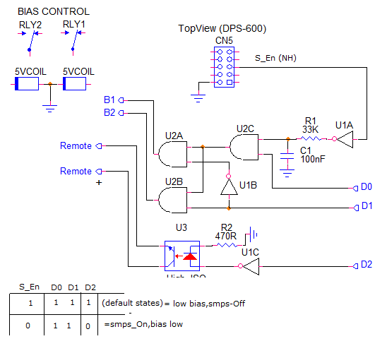

Roberto,
What is the max contact resistance for the remote on/off switch? I am designing for this switch to be an optically isolated solid state relay and some of them are specifying contact resistance of up to 30ohm max. Will this be an issue or will it turn on with up to 30ohm between these pins? What voltage/current spec would be appropriate for the switch? Is 150mA 60V sufficient?
Of course I could pull my DPS600 out of the box and test, but might be easier to know your answer directly 🙂

Remote control requires a low contact current (in the range of 20mA), so it may go well with 30R. I tested with 100R also.
the voltage on this pin is from 3V to 24V.

Moving discussion from main thread to here because this post will be mostly about DPS600 implementation.
This switch bias can be good for many reason.
In my opinion, it makes no sense to set 300mA-600mA, since with simple switch delay from startup. (another thing is, if you change dynamically), then I think start with 80-100, just for no stress at switch on.
High res= high current bias. (reason becouse is not good change two single res).
it's better that relay close a resistor in parallel at original. (calculate sum of res for low bias)

Thanks for confirming that on the bias resistance Roberto.
Here is my idea so far:
In terms of bias levels required, we really want 3 I think ...
Or something along these lines:
Startup - 100mA
Summer bias 400mA (use this if season setting circuit has failed)
Winter bias 600mA
Which could be done with one output from a microcontroller/xbee or just a SPST toggle switch to set high/low depending on season and a few logic chips for triggering solid state relays.
DPS600 pin connects to gnd when it hass started, so I think I can have a pull up resistor on it and run this through a buffer/inverter in the hex inverter chip I'm using for momentary switch debounce/latch circuit to trigger a relay for the DPS600 remote on switch.
This produces high for on and low for off which simplifies the logic for the bias switching.
Truth table ...
Season (1:Winter, 0:Summer)
DPS600 on status (0: OFF is open circuit, 1: ON is closed)
Season | DPS 600 | Summer | Winter | Startup
0 0 0 0 1
1 0 0 0 1
0 1 1 0 0
1 1 0 1 0
Can do this then with 2 x AND gates and 1 x inverter gate as follows:
winter is Season=High AND DPS600=High
summer is NOT(Season=High) AND DPS600=High (which should trigger every time DPS600 enable pin closes)
I write this just now (if I have understand well your ..logic target)
D0-D1 change 3 option for bias.
D2 for remote control.
i suppose that cpu (in default) start with all port high.
hope can help you.

Thanks Roberto, indeed that is quite similar to what I had in mind. A few small changes though, I will post my schematic tonight once I am at home and have time to tidy it up, I only have what I sketched out at 2am at the moment.
The one question that I do have is regarding the DPS600 enable pin. When PSU powered down is it normally high or normally floating? If it is high what voltage should I expect?
IMO CPU should default low and assert IO high as required, using NC contacts to connect extra parallel resistance for lower bias setting. This should also mean that if control power (battery) has failed then the amps will start in the lowest bias setting and stay there. Seems like the best 'failed' state possible from a controller.
