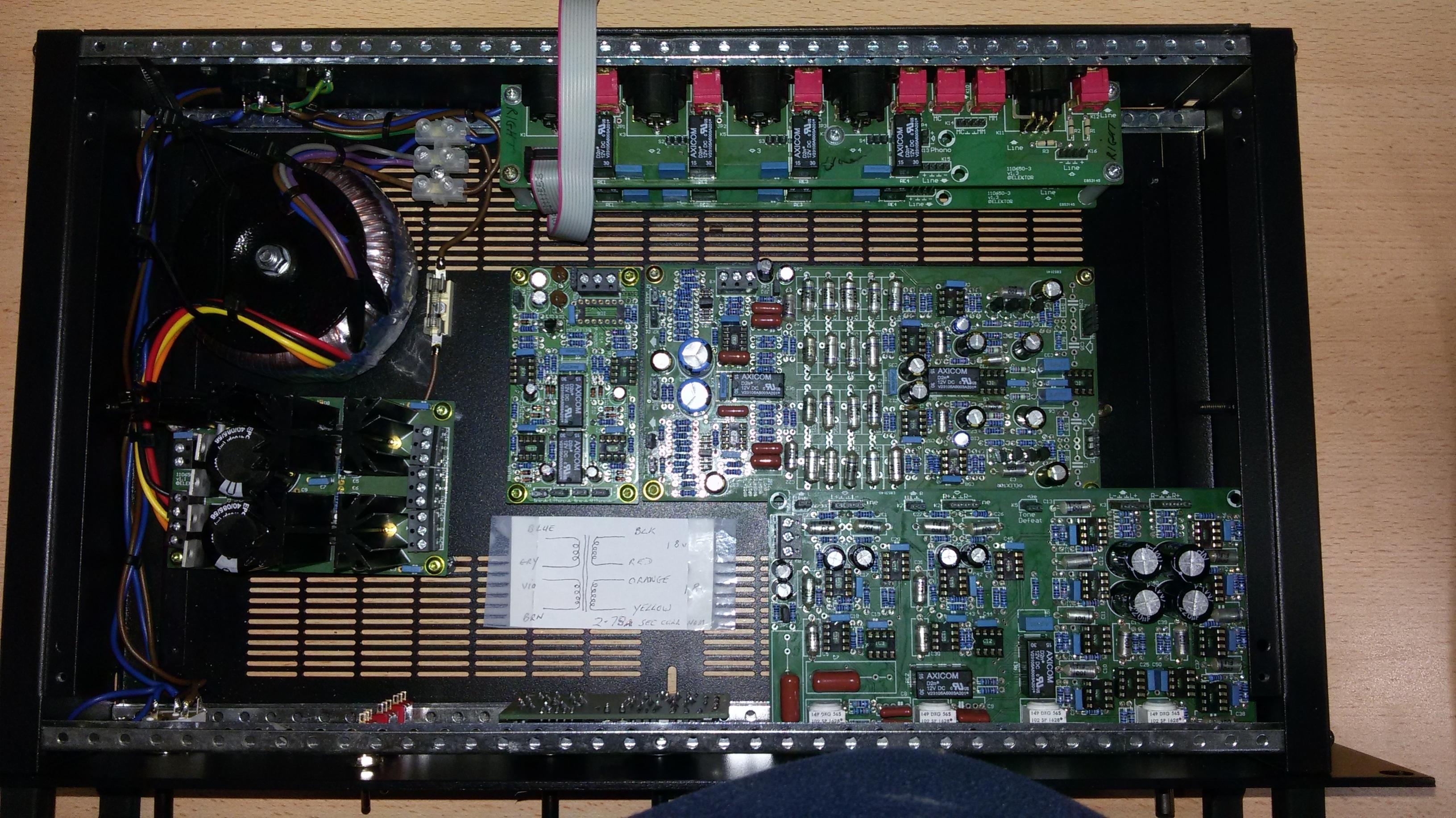

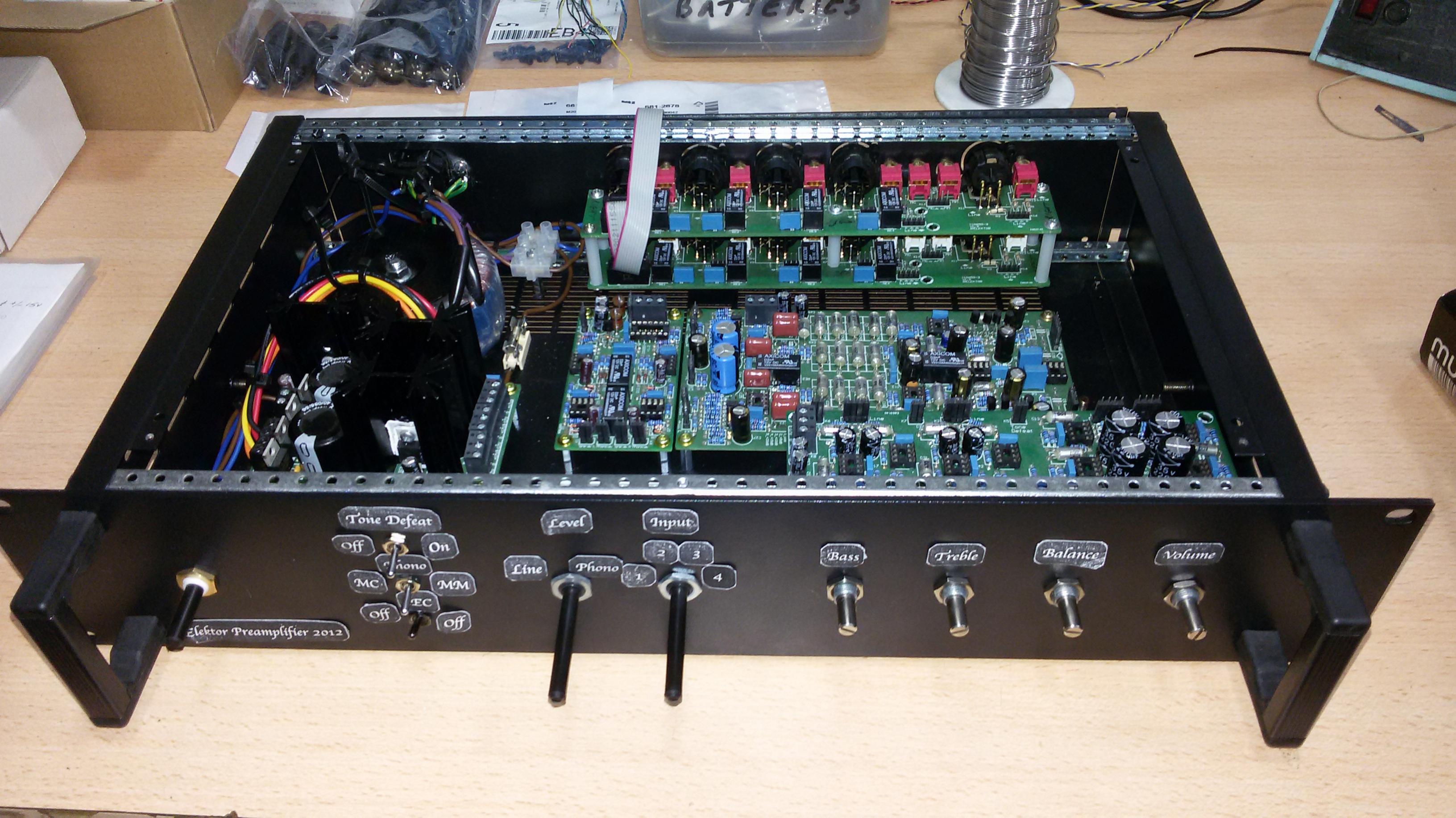

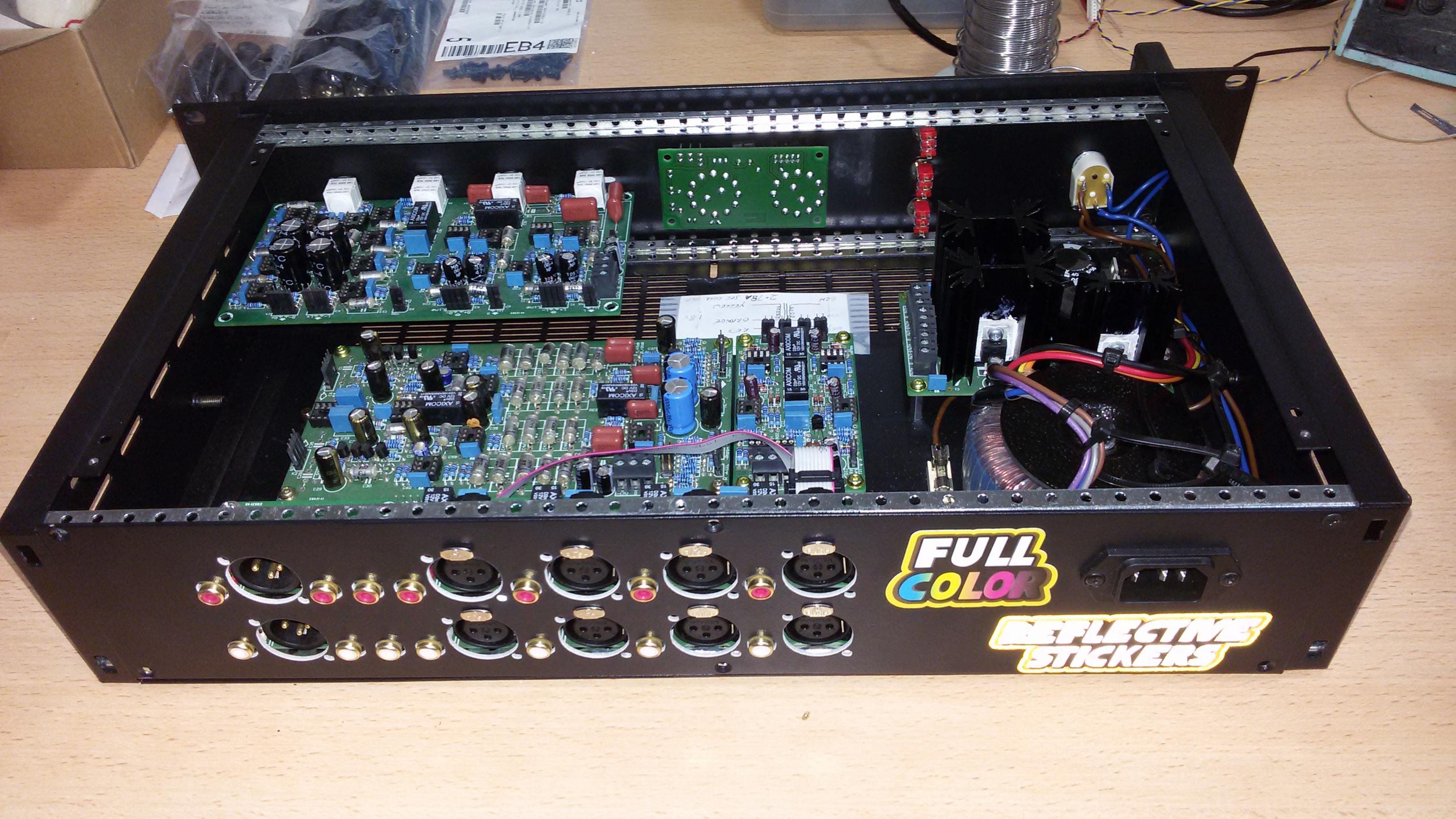

More.... Input PCBs with ribbon cable and some custom 2-pin interconnects.
Redjr, may i ask about the ribbon cable and connectors you have used?
Ideally, i would like to have a similar set up as yours with the Left & Right input pcb's, one above the other.
What connectors and cable have you used to connect the two K17 sockets together?
This cable then connects to K1 on the Front Panel pcb.

Good work and thanks for the photos!

I used Harwin connectors available through Mouser.
Headers & Wire Housings
Contacts to match
Use the Series Number M20 to find "number of positions"
And I bought this crimping tool on Amazon:
Engineer Inc PA-20 Precise Universal Wire Terminal Crimping Tool
You can get these connectors and crimper tools on eBay as well.

For dc connections I just use salvaged PC desktop hook-up wire. Three color coded wires twisted together.

Did you notice the Harwin connector housing has pin 1 marked with an arrow. Just make sure you follow the same wire pattern on each end of the cable. Most of the connections from one board to the next is pin specific. The silk screening on the board will guide you.
