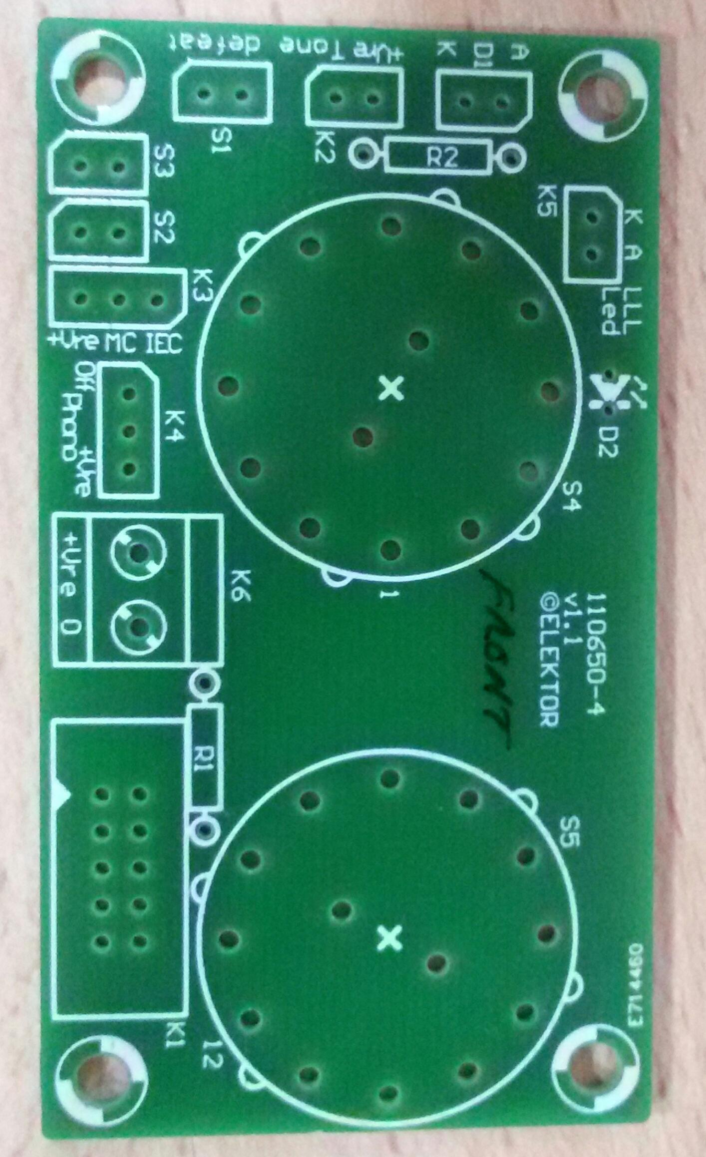

Front Panel query
Switched on this afternoon, without sucess
A question please of the two switches S4 and S5
What is the correct way around to mount these switches on the pcb?
Having powered up, i get no sound output.
The supply voltages are all ok, +17, 0 and -17v.
D1 led also lights when powered on.
D2 led i have not seen lit, despite numerous combinations of S4/S5 etc.

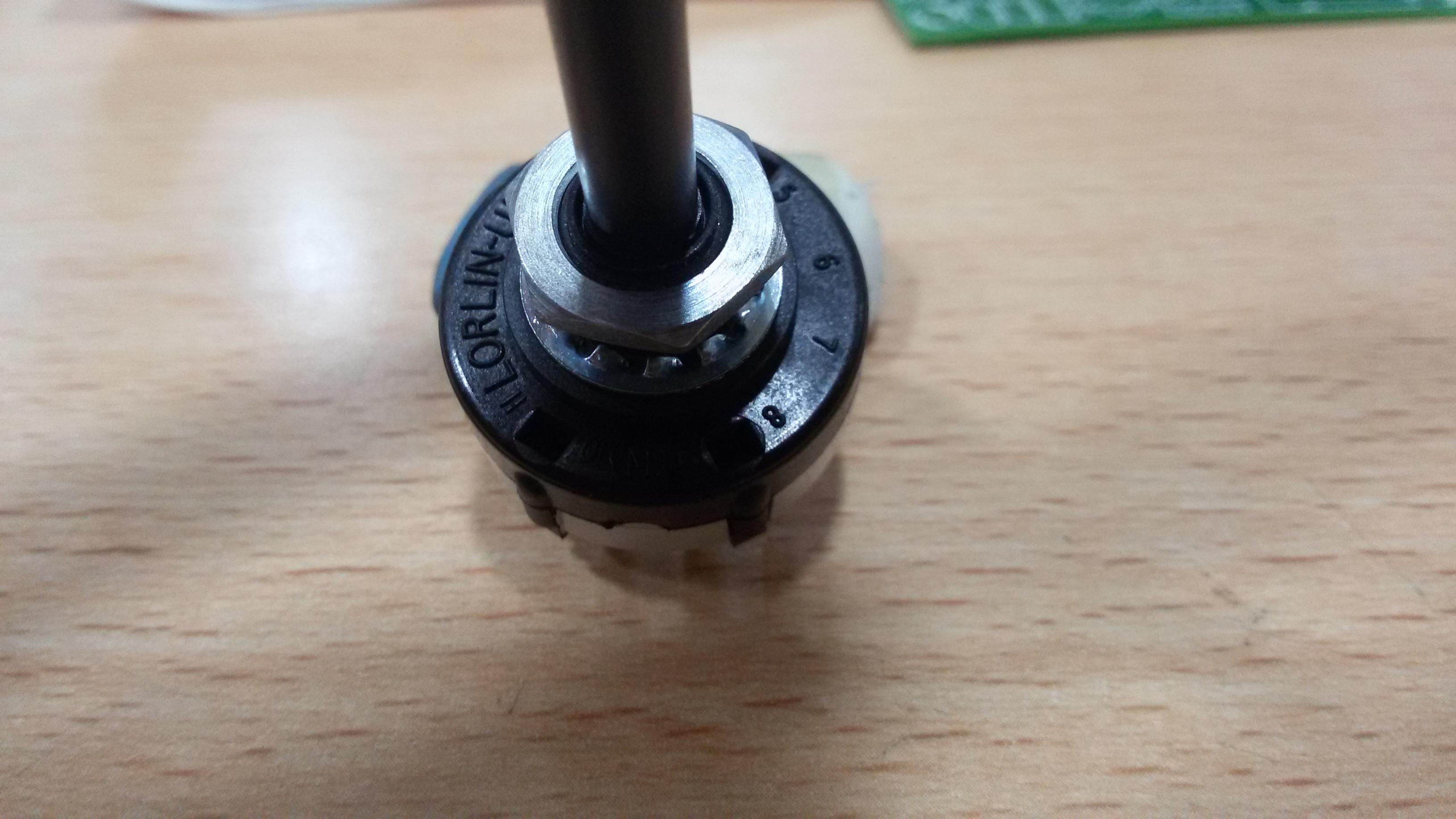

My question is to try and clear up the position and mounting of S4 and S5.
Both these rotary switches can be mounted any way on the Front panel pcb.
Can someone please advise?
I see no one has replied.
I've not studied the switching arrangements but those Lorlin switches would be symmetrical electrically as regards the contacts. I am assuming they are a two pole six way switch and not a one pole twelve way.
You can prove that yourself by simply measuring which pins connect to the centre terminals on the switch for any given position.
Rotate the switch 180 degrees and confirm nothing has changed with regard to the way the switch will operate. i.e. the same pads on the board will be linked by the switch irrespective of position.

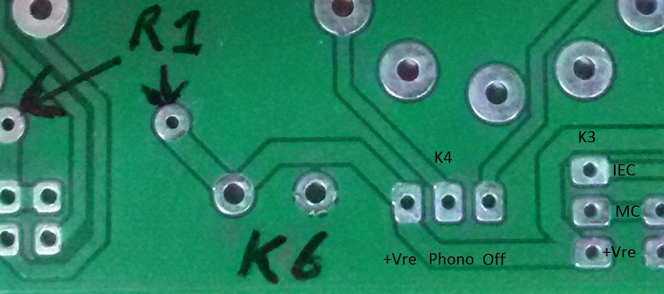

+Vre / K6 socket
Thanks Mooly for that.
I switched on my Preamp 2012, but i get no sound output.
Can someone please advise how exactly they should be mounted?
Lastly, to enquire about K6 socket and the +Vre/0 connections.
Following +Vre from the PSU to K6, you'll see that the +Vre on K6 does not go to R1 !

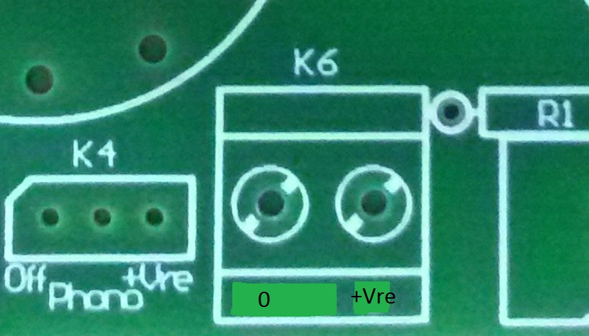

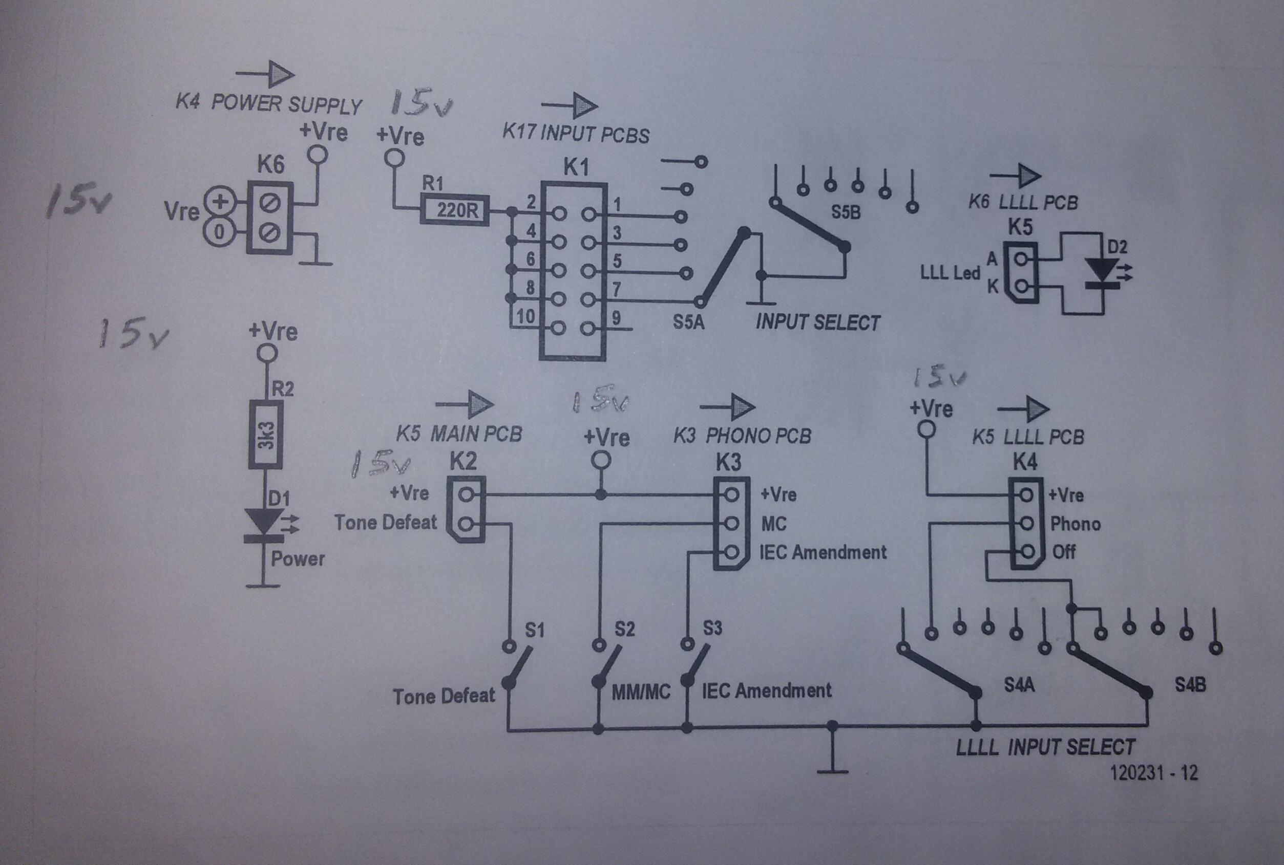

Front Panel pcb
Cct attached.
K6 has to be wrongly marked!
The +Vre/0 supply (from PSU K4 ) is connected to the Front Panel pcb K6.
You'll see K6 is incorrectly marked on the pcb!
K6 on the pcb marking +Vre should be 0 and 0 should be +Vre
If it was incorrect, wouldn't everyone using these boards have the same issue ?
I think I see what you mean regarding K6 on the print view in that +Vre seems to be connected to the ground plane. What do the others who have used these boards say ?
Cct attached.

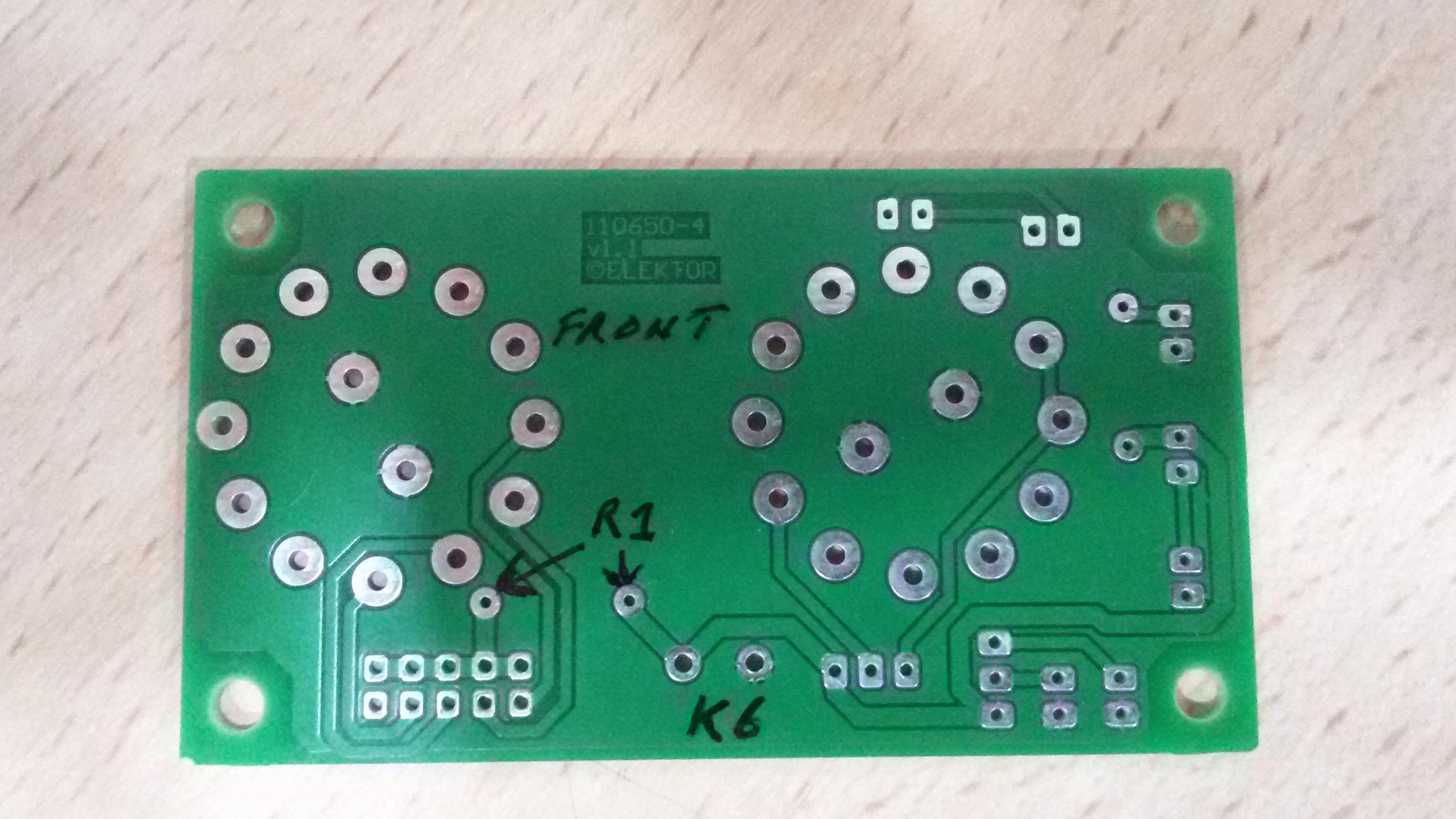

Not so! Take a look at the photo in the published article ( Elektor June 2012 P24). As viewed from the topside of the PCB, +Vre is marked as the leftmost of the two connections of K6 and 0V is marked as the rightmost connection. This is correctly shown.
Geoff
Yep,
on my Front Panel pcb, K6 is labelled wrong!
It's 0 that connects via the print to +Vre on K2, K3 and K4.
K6 should have been labelled looking at the top side (not print side) with 0 on the left and +Vre on the right.
K6 now labelled correctly!
Ive brought the matter to Elektor's attention seeing that the kit of pcb's were purchased from them.
Front Panel version
Direct from Elektor!
On PCB 110650-1 v1.1 the markings of K6 are wrong. +Vre and 0
should be switched. +Vre should be on the right side.
This has been corrected later in v1.2 of this PCB. +Vre should be connected to R1!
So i was correct! 😎
