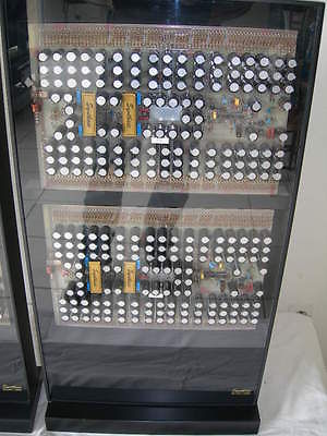

what is on the picture
Stereo amp from the early '90s, 2x150W, Belgium design (msrp of ~$10k here back then).
The sides of the amp boards have hundreds of TO-92 transistors in parallel as the output stage, NPN at one flank, PNP on the opposite.
No heatsinks, the back panel has four ventilation slot areas over the entire width in the bottom, middle, and top.
Single toroidal transformer in the bottom section of the amp 'case'.
(Nelson Pass mentioned he did a similar thing with small signal bipolars)
