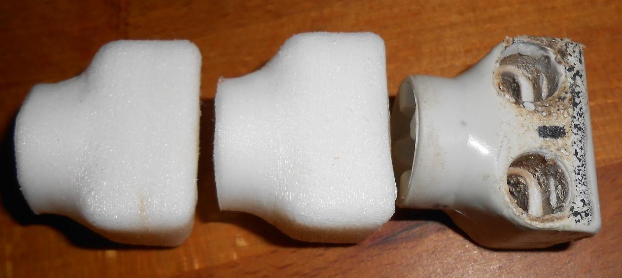

As a side note, modelling with digital cam images for 3D printing works like a charm by now.
Replacement mounting blocks for a shower door, lost one of the originals.
Also a better plastic, besides clean new ones on both sides.
Drilling the holes manually is more accurate, plus faster than adding them to the model.
(isn't this day and age fan-f-tastic

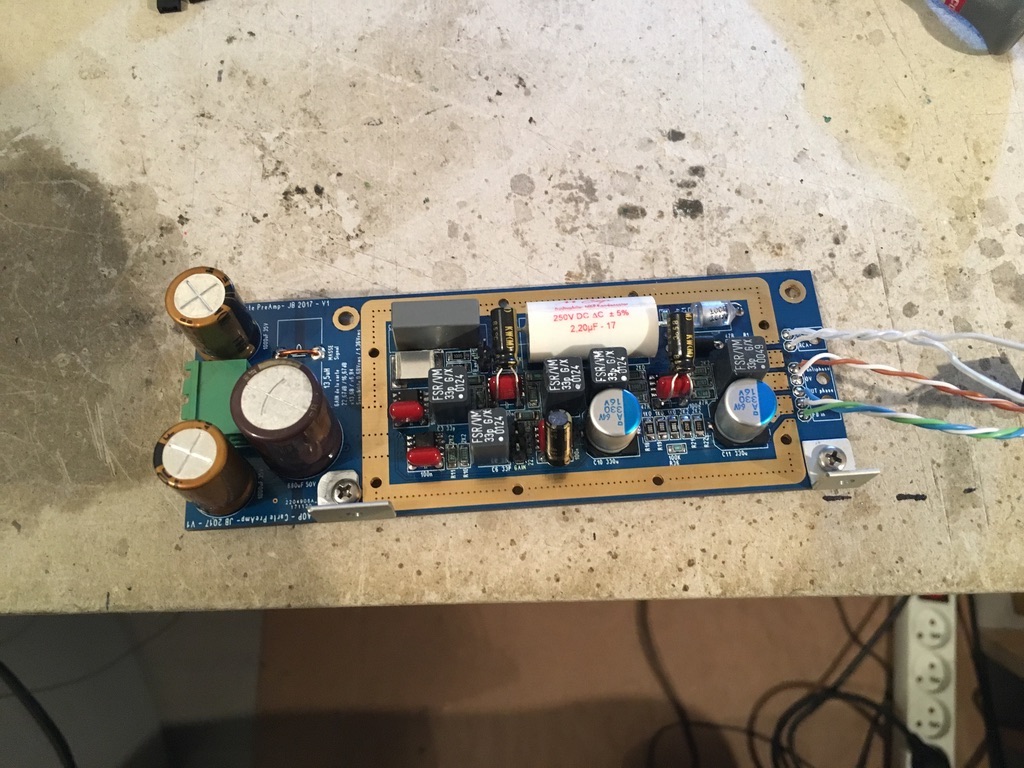

My 5532 Opamplifier build
Bought the boards from Elector some time ago. Originally had 2 power supply boards but that caused an insoluable (to me) ground loop. Chassis from eBay.
I like the sound. I seem to hear details that I hadn't noticed before. No A/B test though.
Paul

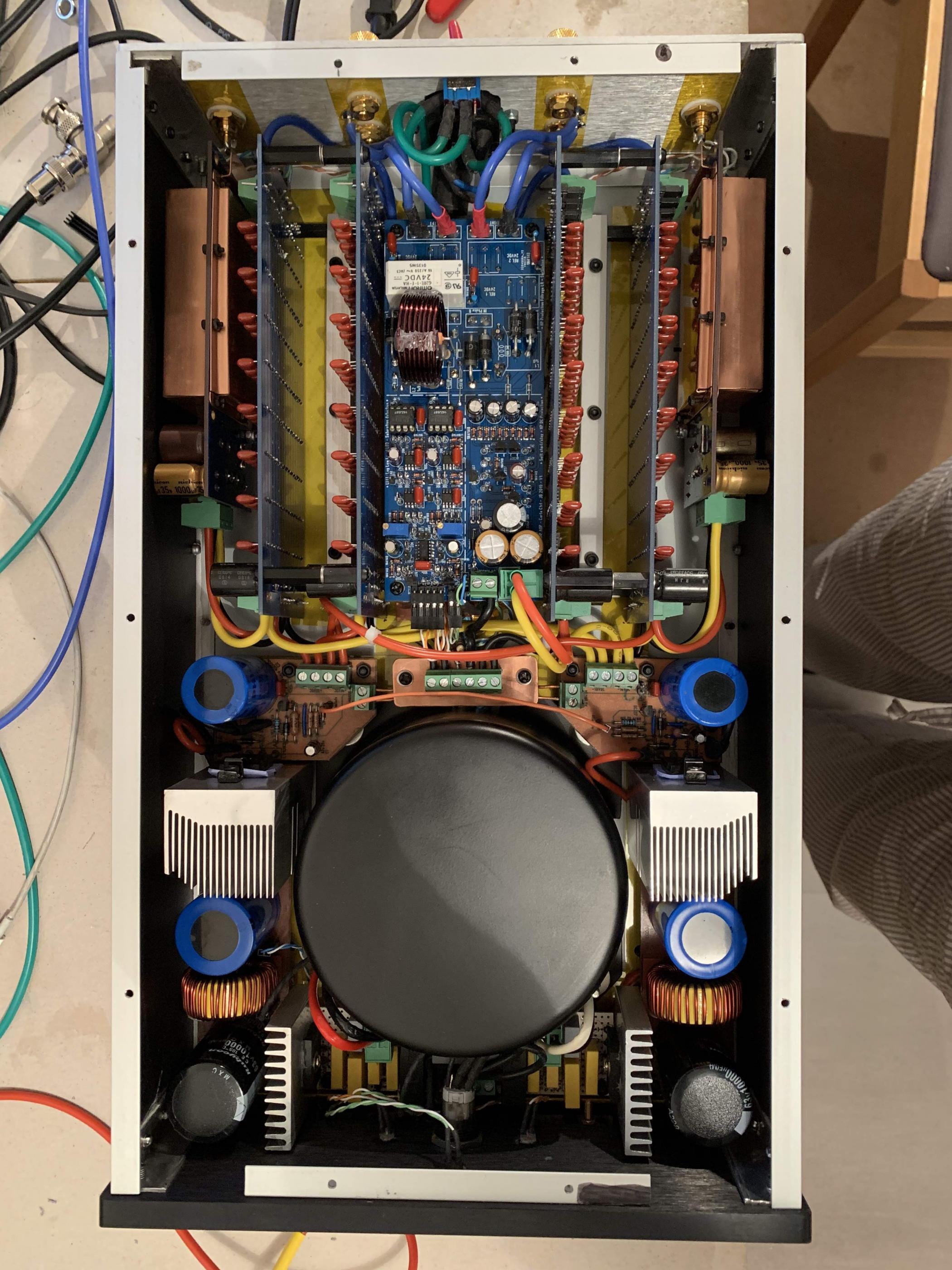

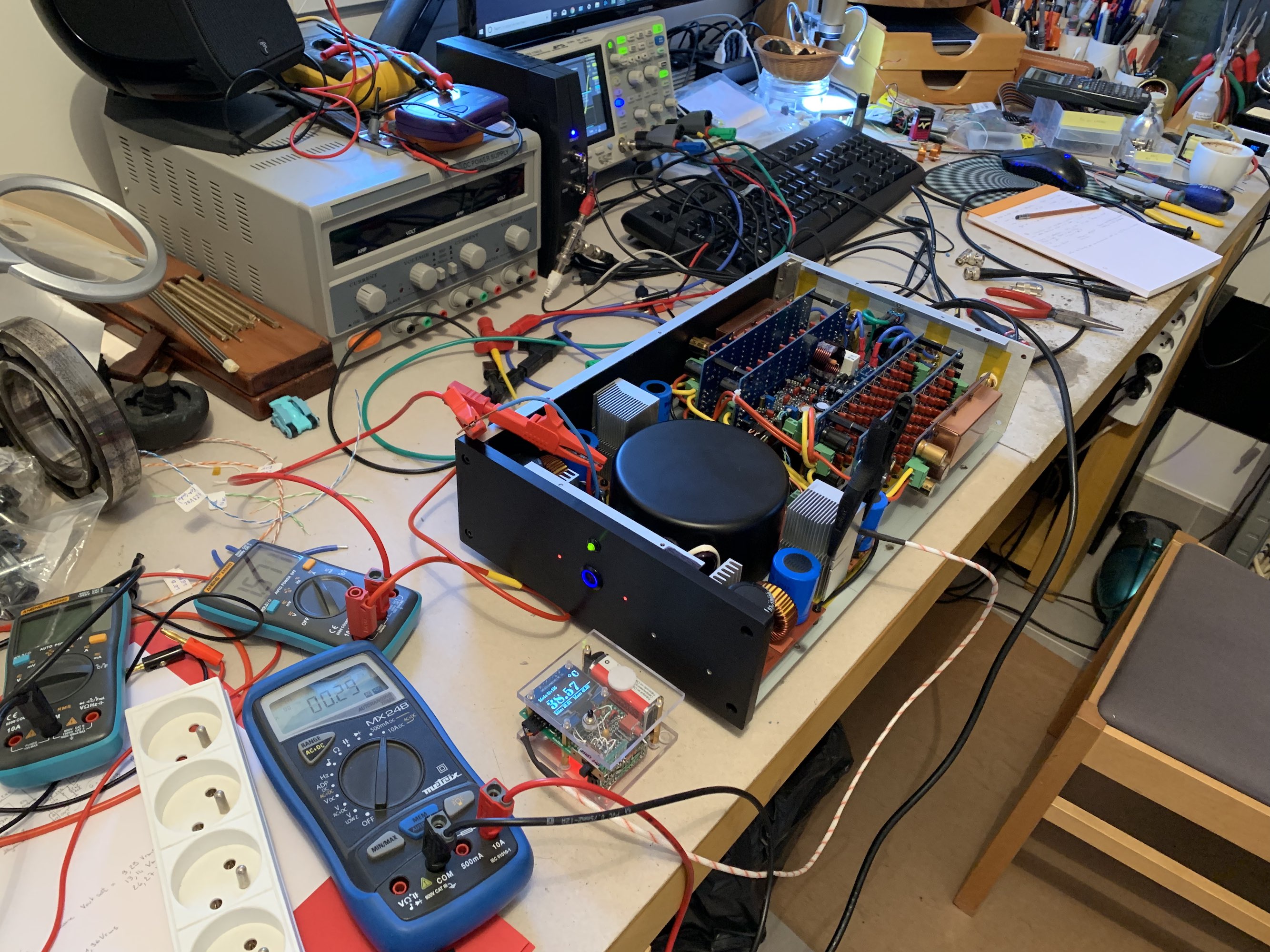

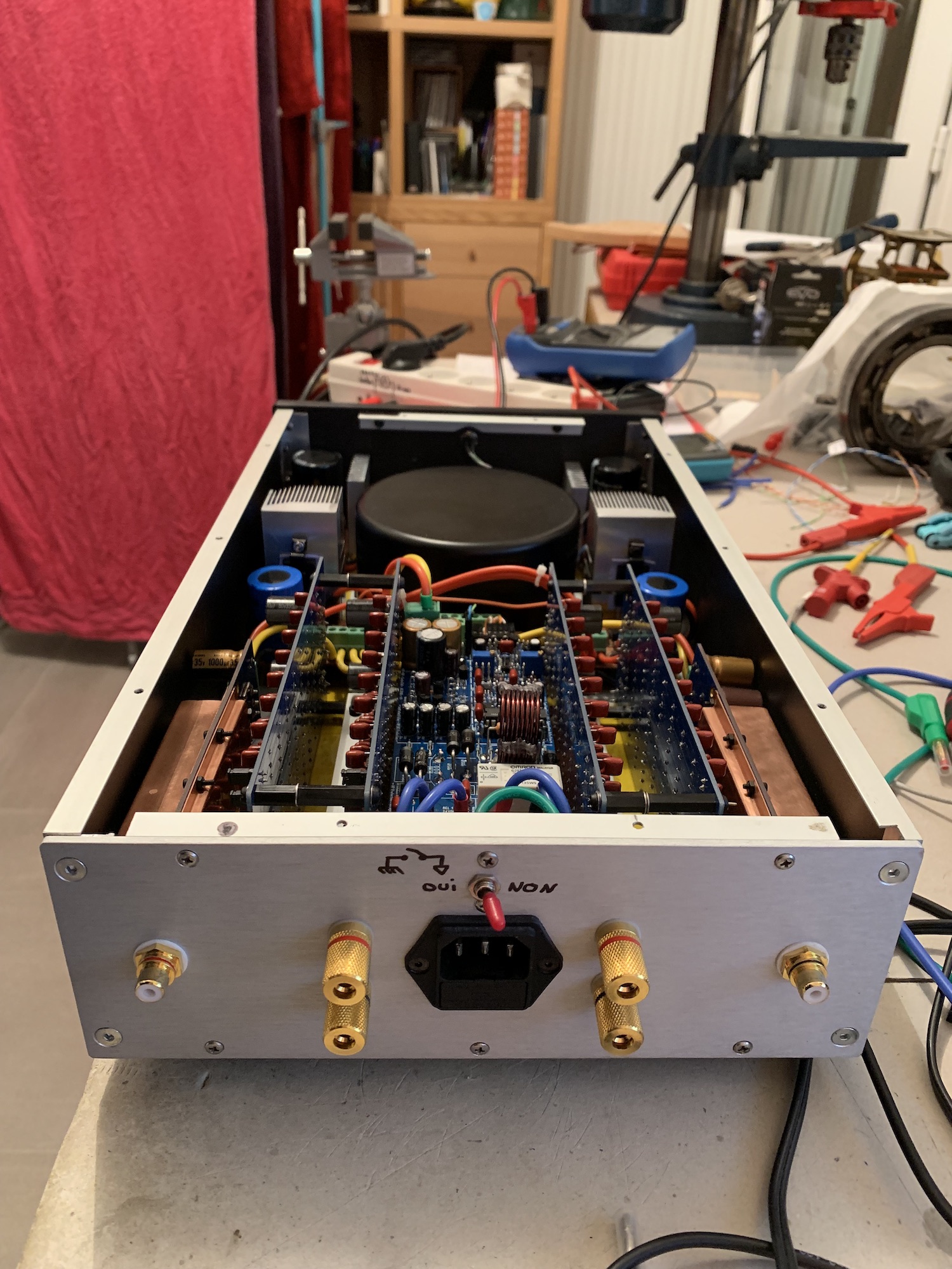

My NE5532 Bridge mode project build
Hy all,
I find this topic when I was in a NE5532 project myself and well, I finish it know and after all hours (days…) I pass on, I think it’ll be nice to share and show what’s going one.
I first see this design when reading D. Self “Audio power amplifier design” I find it very simple and interesting and decide to build my version of it with some “upgrade”.

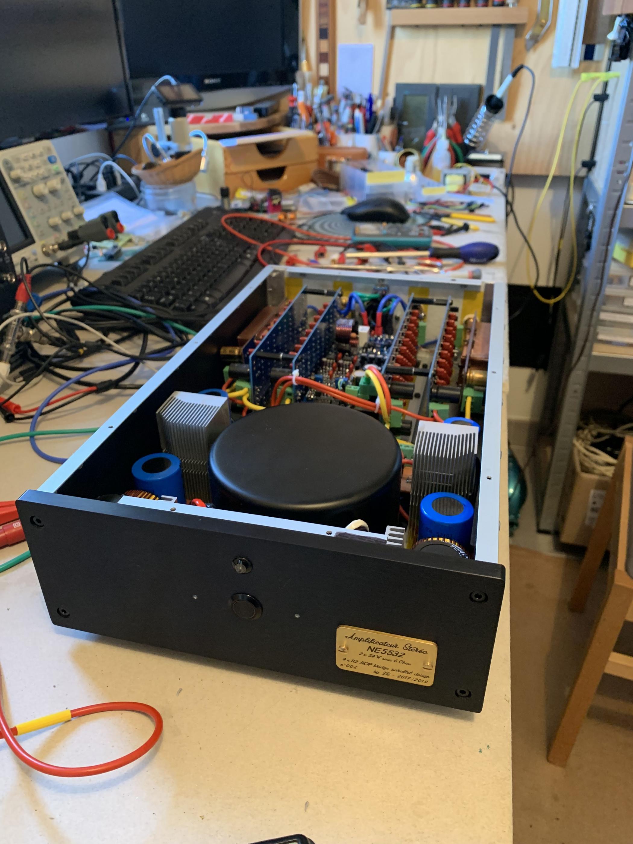

My approach was :
1- Built bridge version (I have 6 ohms speakers… and more comfortable with 60W than 16W…)
2- Use the best quality component for each part I can pay for (Cost no object approach, regard to my limited budget..) for the best noise / linearity tradeoff.
3- Make it with SMD component as much as possible (for PCB area an noise consideration)
4- Exit the balanced input (XLR connector) and keep only the unbalanced one (RCA connector) because first, he is noisier, and second I don’t have XLR output on my preamp.
5- Built it on a case that feet my HiFi furniture (case home made with steel and aluminum scrap)
6- Make a symmetrical casing, because… I like it ! I think it look nice and make me feel like everything is in order, and track and cable length are match between each channel if ever that change something (for me optimizing the star grounding scheme at least)

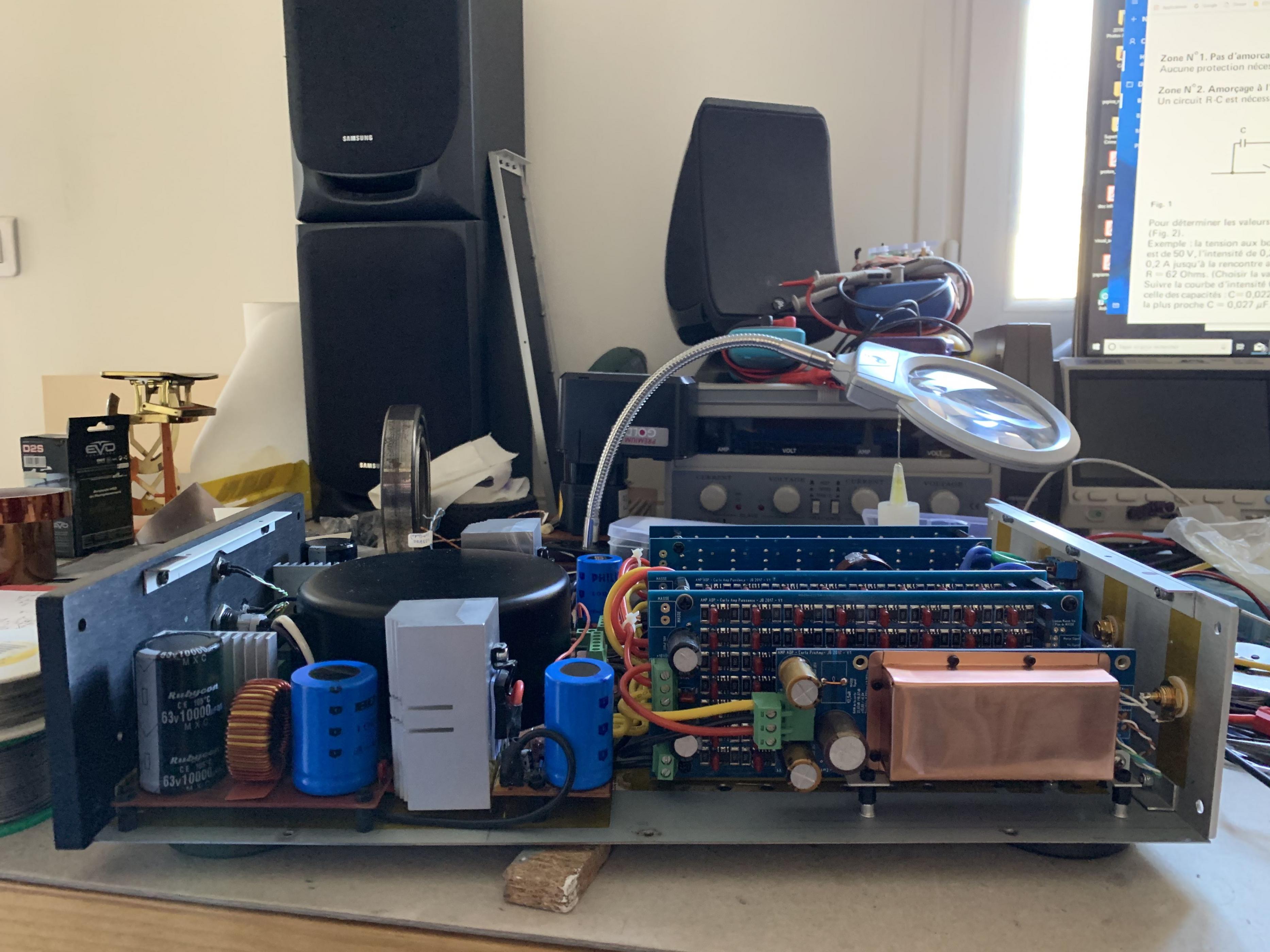

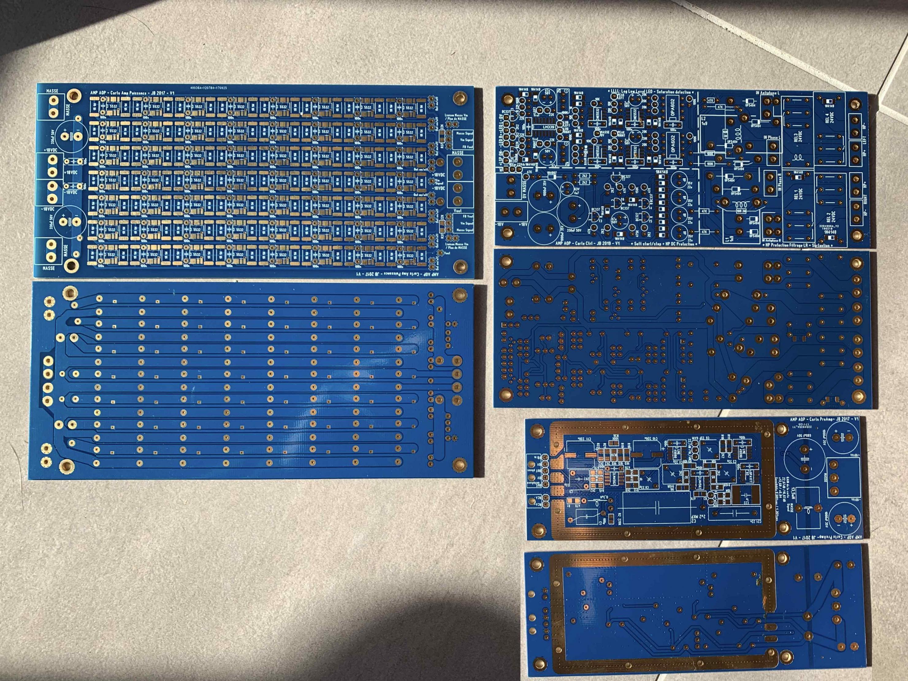

My implementation of the design was split into 12 boards (!) to fit these requirements as follow :
Power supply
1- Rectification board (Fuses, 220V filter, Bridge rectifier) x1
2- Filter board (2 Condos + 1 Self) x2 for +18V and -18V
3- Regulation board x2 for +18V and -18V
Signal
4- Input Preamp signal board x2 Left and right
5- Power board x4 (Bridge version so 2 for Left and 2 for Right)
Monitoring and protection
6- Ctrl board (Softstart, Faststop, diode+filter+DC speaker protection, LLLL saturation detection)

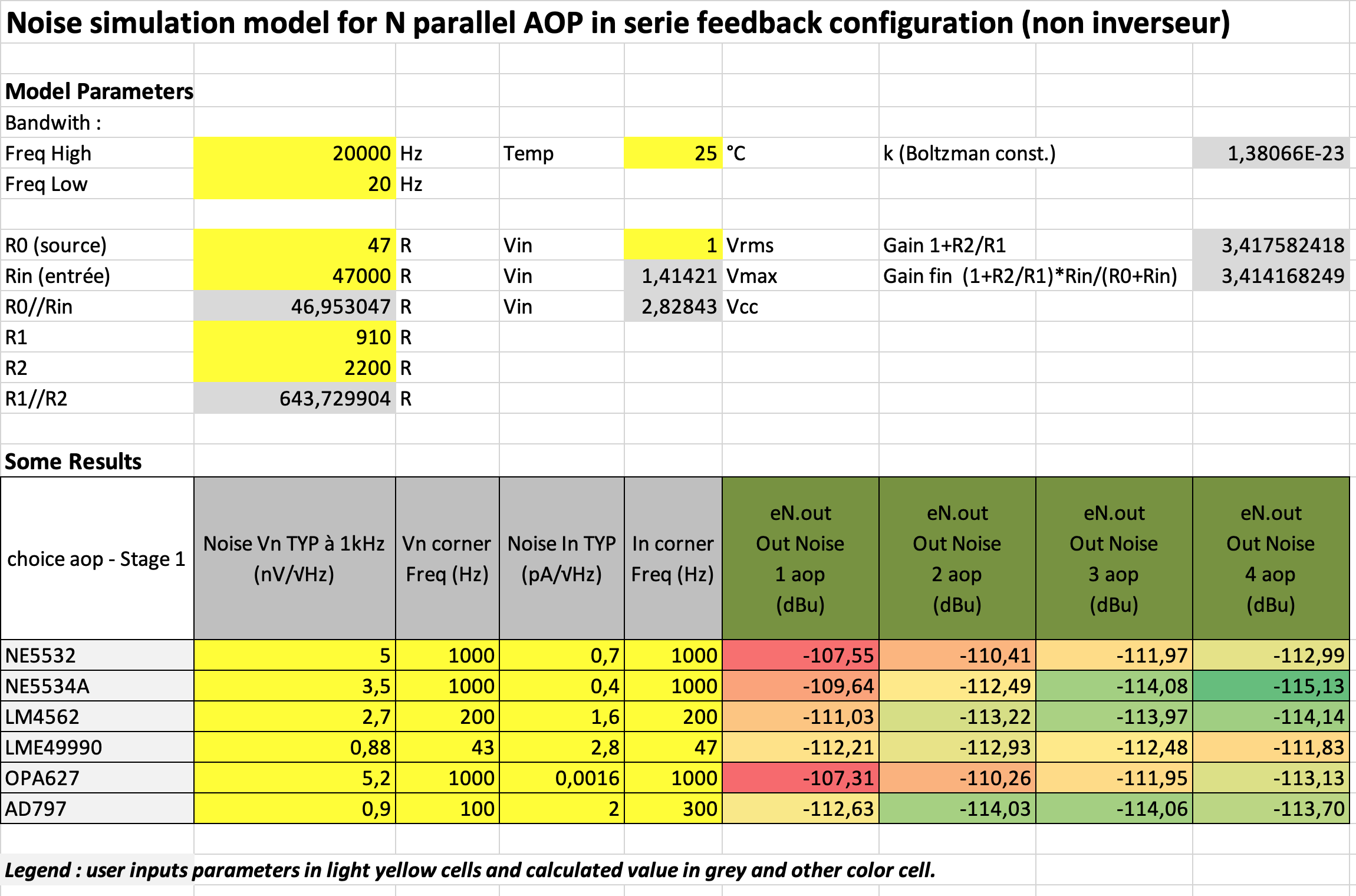

With this short list I went very deep in schema noise calculation for different AOP choice and configuration and I make a spreadsheet to calculate and compare option per stage. Some result for the first stage of that in Excel picture attached.
Here some ressources I use for building my noise model spreadsheet :
- Opamp noise calculator
- http://www.ti.com/lit/gpn/opa1656 (Page 18)
- https://www.analog.com/media/en/reference-design-documentation/design-notes/dn015f.pdf
- Book : “Operational Amplifier Noise: Techniques and Tips for Analyzing and Reducing Noise”
SEE ATTACHE SPREADSHEET SCREEN SHOT
Conclusion : for the first stage who use 2 parallel serie feedback AOP in original design. The best one is AD797, but it is not unity gain stable, and usually advise for bigger gain than only 3,41 in this stage. Datasheet advise matching input impedance too and we haven’t here so he didn’t suit well the need and I didn’t choose it. Second best choice (and first dual package choice) is LM4562 ! In fact it’s not the LME49990 because, the cost for his beautiful input voltage noise is the bigger Input current noise, and with the 47R source impedance, LM4562 is a better compromise between current and voltage noise for this source impedance. In fact all AOP have an optimum number of parallel device for noise figure and it’s depend on source and input impedance. Optimum is when Rsource // Rin = Vn / In. Exemple, for one LME49990 Vn / In = 314 ohms so for Rin = 47 kohms, optimum Rsource must be 317 ohms. Be careful, optimum Rsource vary with number of AOP in parallel, because current and voltage noise add themselves in a root square law, make some spreadsheet guy’s !
As you see, FET input OPA are out of the game for small source impedance because the beautifully input noise current came with “bad” voltage noise so we didn’t have enough noise advantage with noise current in 47R source for the voltage noise price of FET AOP.
And so on for other stage and the preamp PCB. I end-up with a mix of LME49990 and LM4562 for all the stage of this board and decide to keep the same number of AOP as original design for cost ($) and PCB area regard to benefit. I just change little things on input filter, and add input impedance matching circuitry on last stage from original design to optimize DC offset (see design remarque below). I find theorical -100,03 dBu of noise at the end of the board, SNR 124,94 dB.

On picture, Preamp board are in the left and right corner of the case, nearest from input connector and as far as possible from supply and “HP big current” flowing. I made both side copper shield for the two board (Home made from a copper sheet, a little nightmare to build !)

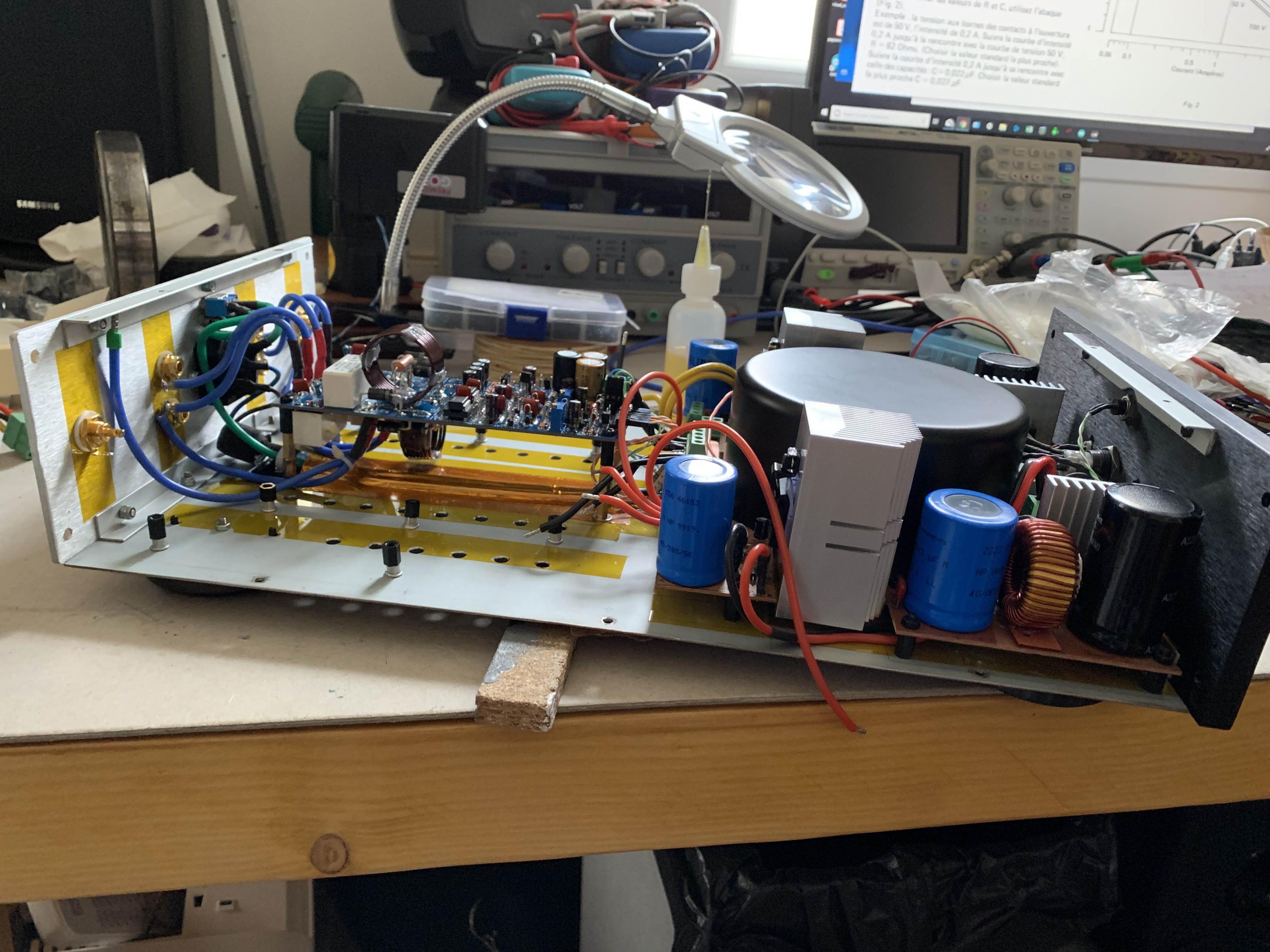

All signal board (6 of them) are put in vertical way in casing because it optimize the cooling with hot air moving from bottom to up the case. I made holes in casing up and down for that per power PCB.

Board 4 - Input Preamp signal PCB
I have to say, I pass few week-end and evening on this one ! I take the original design and try to optimize it from two way :
1 – Which AOP do I have to choose for each stage ? (5 stages (6 AOP) on Self’s preamp Design)
2 – Can I improve it by the use of parallel AOP technique here too ?
So I go very deep on AOP Datasheet for the “best in class” in audio use, and here are the shortlist I comeback from :

I make this board with metal film true hole resistor, since ctrl are not in the signal path, and thin film resistor are F… expensive !
All signal and ctrl PCB (all the blue one on picture) was design on 2 side PCB with ground plane both side. Just upper side of power PCB missing ground plane because it’s the first I made and didn’t know how to managing it on my software yet..
Casing
If front face I made only one button ON / OFF including blue power LED. (For instance, one button Hifi equipment have very good WAF ! )
And I had 3 LED, one light green when speaker connected (LSP ON), and two RED (one per channel) who blink when channel clipping.
Back face, 2 RCA input connector, 2 speaker output connector, one sector with fuse and one button who switch on and off the connection between circuitry ground and Earth chassis ground. I made that in all my Hifi conception, then I can play with for cut ground loop between hifi stuff if needed and then optimize total system hum.

First my preamp board oscillate like hell ! I spend hour and hour to find why. I change all with NE5532 and its work, but not with LM4562 and LME49990. I find that it was because I add a small self in ground path for “isolate” HF between preamp ground and power ground in my design. I think it’s because high speed AOP are more sensitive to ground impedance, and so with self on it, they oscillate. However, I was thinking it was common practice. Is someone have something to say about it ?
Competition AOP need bigger decoupling caps as well as they are faster and I forget that so I add electrolytic caps in parallel of MKP for decoupling them and remove self on ground path and all run ok with first in class AOP I choose.

Final conclusion
I start from a very simple design, but at the end so much work was done and I’m very happy with the result. My biggest frustration is that I didn’t have the equipment to measure THD, noise Etc, so I work in blind mode and cannot confirm my theorical work in practice and that is very frustrating. I dream of a Audio-Precision device !
For the sound, no precise measure I can do with my poor scope. I can just say, when ON and no music playing, my speaker are dead silent, even with my ear at 20cm far from the ribbon tweeter ! And the sound, clear, precise, far better than all I had at home (not so much..), so really happy with.
He was so quiet then now, my preamp dominate as hell the hum in my system, so I start to work on a new preamp as next project.. based on D. Self’s articles of course . My design “mix” Precision preamp and 2012 preamp article. Maybe a future article if they are a topic on it in this forum.
Thank’s if you read so far ! I hope this can help some of you to give a try to this very nice and comprehensive design, Regards Jean-Baptiste.
