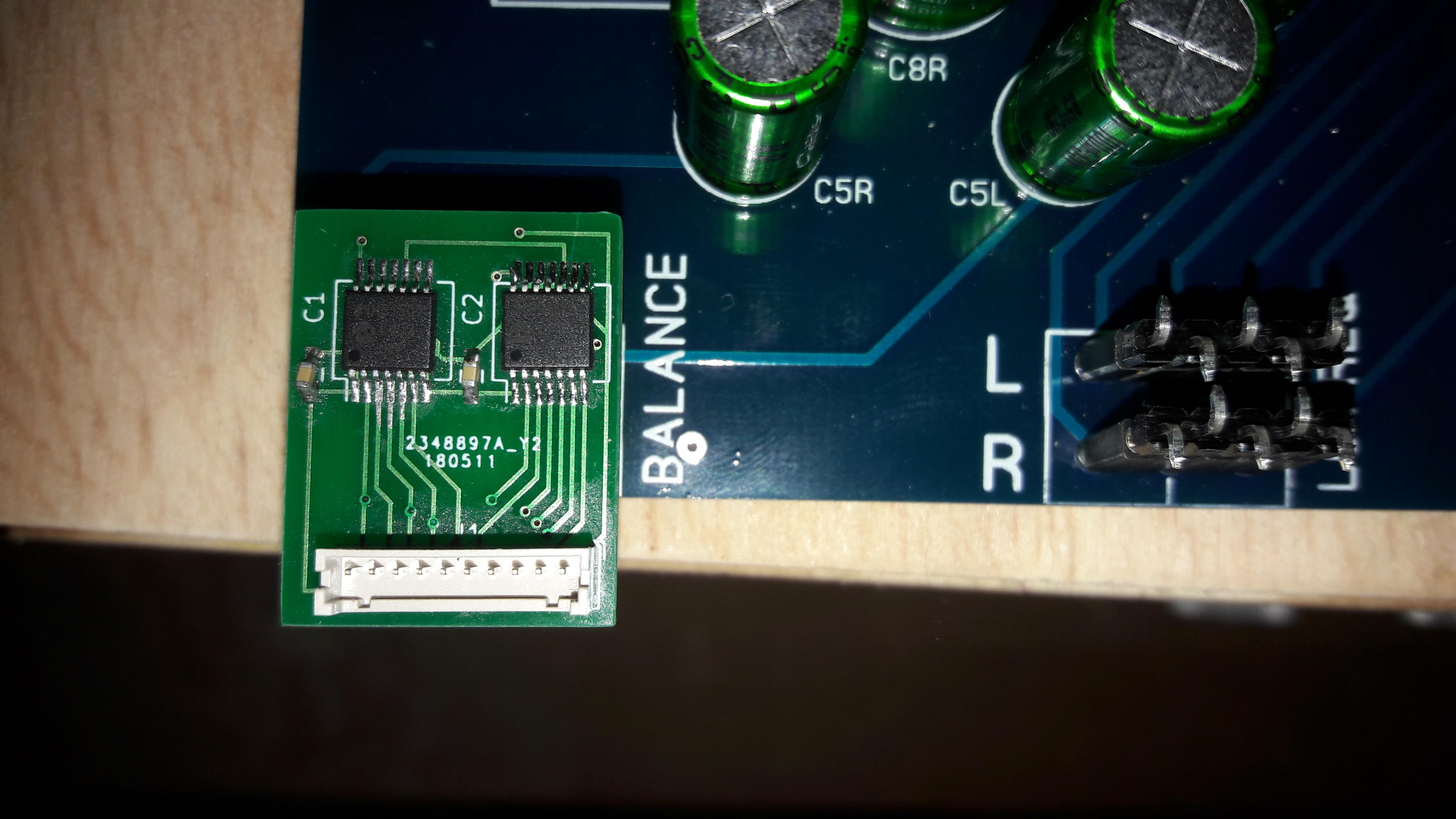

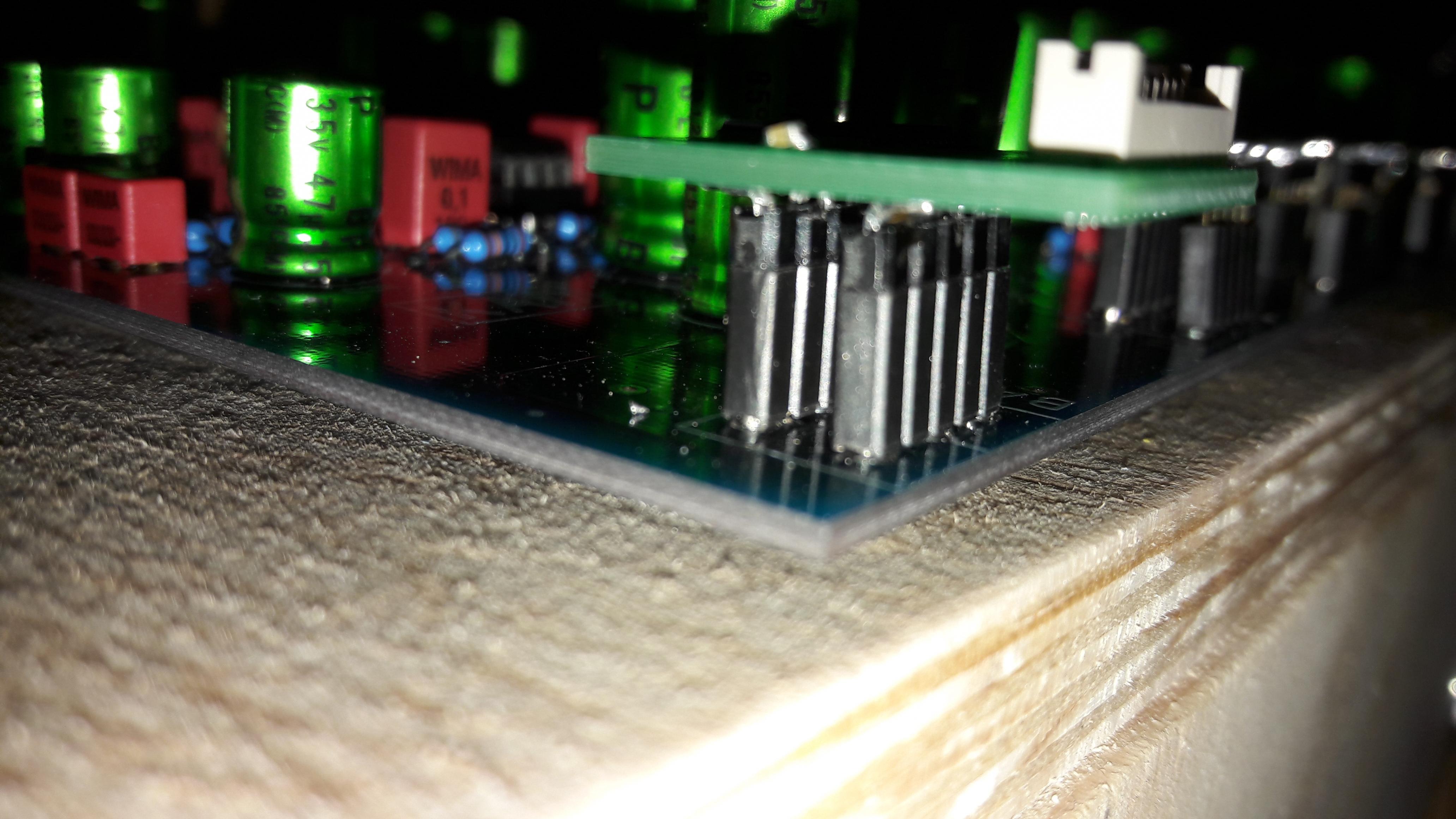

here is what I did with this gorgeous preamp. I consider this a functional prototype, so don't blame me for inappropriate wirings 😉 But I think, it is already a good example of what you can do with diy components. In this case, it greatly improved the original amp's performance.
What may be of special interest here is that I'm using serial potis to do all the tone controls with an Arduino. So far, I cannot hear any negative influences. But I must admit, that I don't have the equip to do accurate measurements.

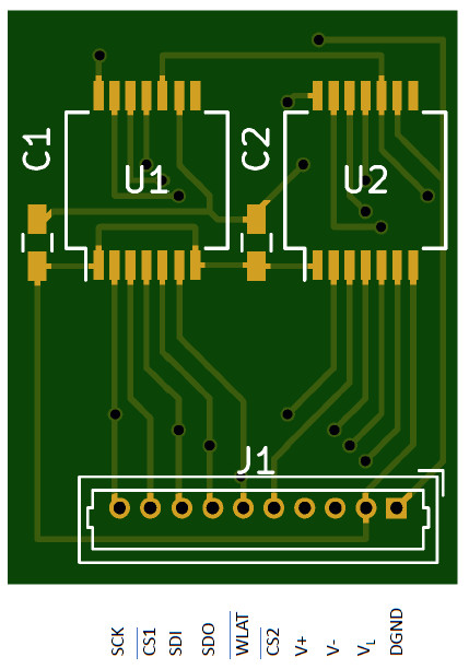

For the potis, I have used 2 MCP41HV51 devices per PCB to replace one of the original potis. These are high voltage SPI potis with separate analog and digital voltages.
On the PCBs, there is only the 2 potis, 2 100nF caps and the connectors: on the bottom two pin headers to fit in the original poti holes (s. image in first post) and on the top side a Molex Picoblade for all the rest. The pinout is given in the attachments, the PCB layout as well.
The wiring is pretty much straightforward: The HK3490 offers a 5.6V supply and a +-15V supply. The 5V (via diode) I used for the Arduino and poti digital voltage, the +-15V for the preamp and the poti analog voltage.

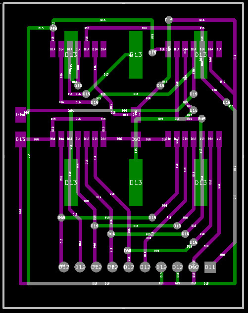

For those who are interested: Here is the Gerbers for the Poti PCBs.
Btw:
At the time when I designed the PCB, I had not yet completely read the datasheet. In the application notes they say, you should apply decoupling caps between the analog voltages and AGND. Without this in mind, I only applied one cap between logical supply voltage and logical ground. If anyone can tell what's the best way to apply caps here, please let me know.
