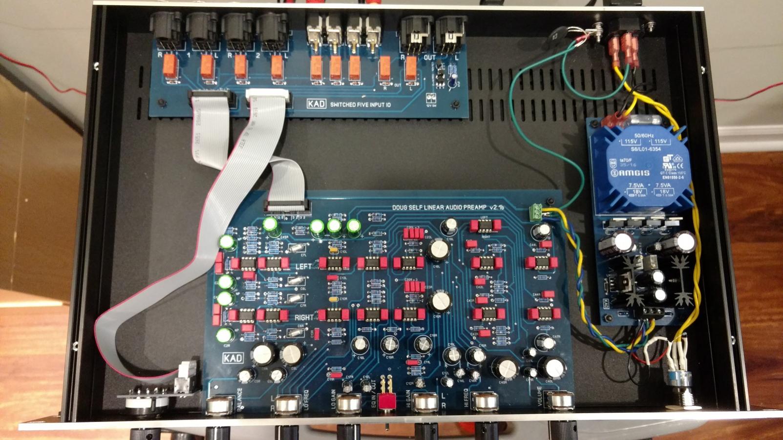

.................One question i have right now is that i think i will put the power supply in a seperate box and i'm not sure what to do with the safety ground. Is it OK to use safety ground on the power supply only or does the preamp chassis need safety ground as well? IE through the power supply line? If that the case, how does one keep audio ground separate? .............
There is an old Thread that includes this Safety discussion with lots of detailed diagrams.

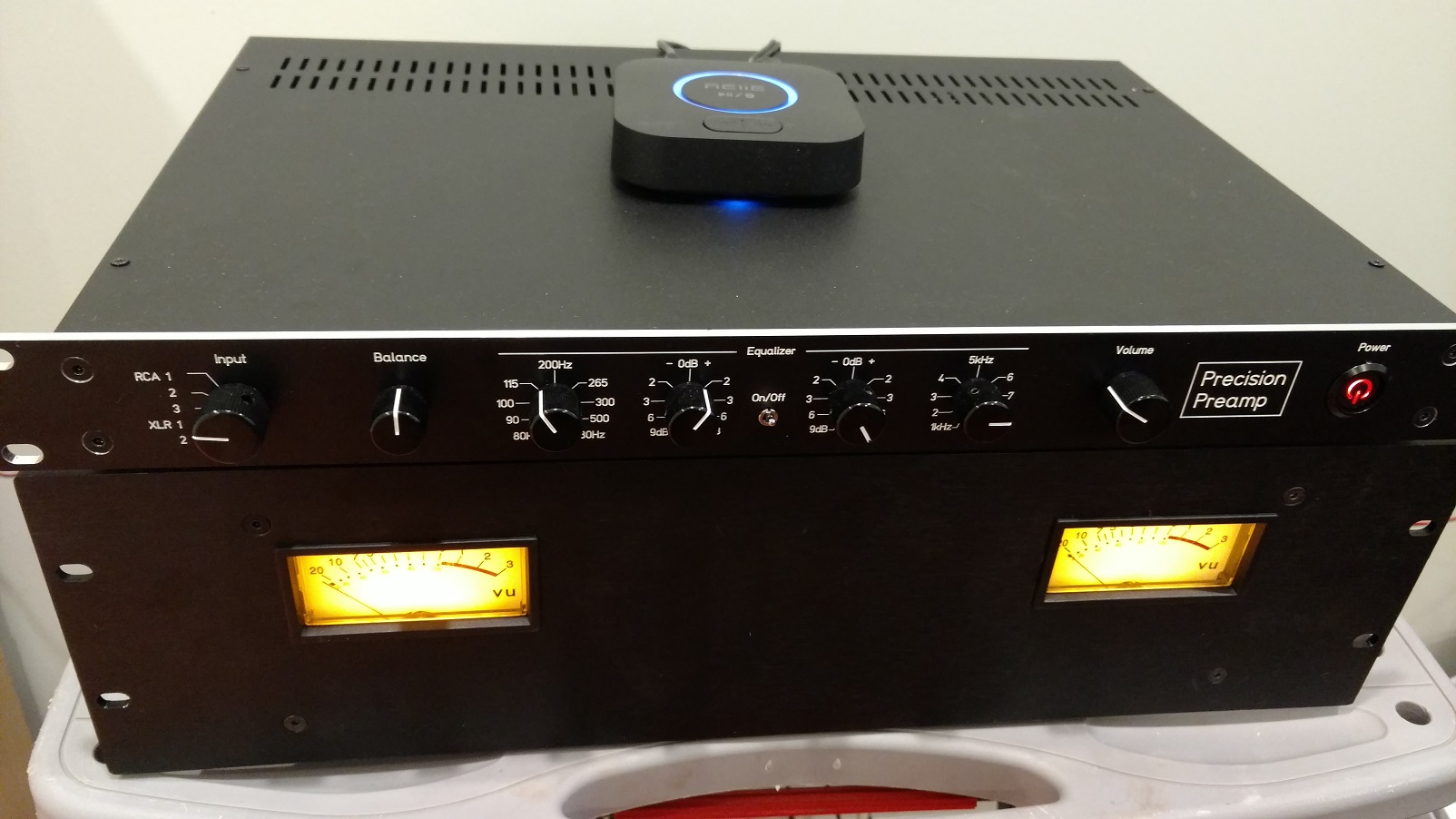

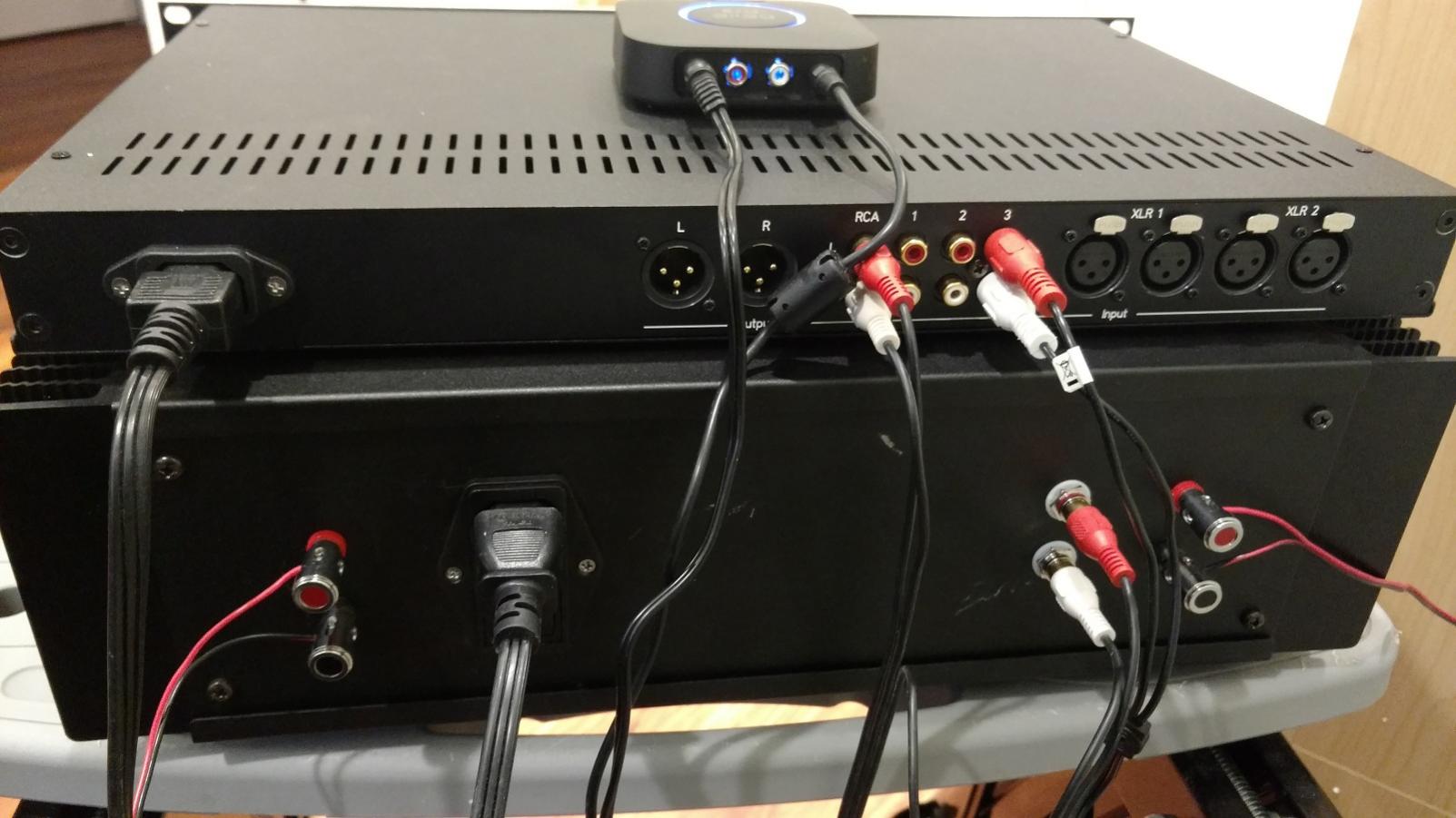

Honey Badger and Doug Self Preamp
Thanks to Doug Self for the design. Thanks Carl Huff for prompt PCB shipment and quick email replies.
Front Panel Express have done a very quality job with these panels. I highly recommend the company.
Thank you everyone for your help at the forums! I couldn't have done it without your help.

Having read the thread recommended by AndrewT a few post back and thereafter the article about audio component grounding and interconnection i think i'll keep it simple and use one chassis for everything, use star ground, and see if it humms. I thought i could skip safety earth in the two chassis solution but i now see that you shouldn't.

I do notice on many build photo's in this thread extra parts ie from rca chassis to ground or from power ground to safety earth. Is there a recommendation in this particular situation?
Also, how is the pin1 connection made? As i can tell from the photo's pin1 is routed to power ground through the main pcb. Is there something extra to be done around the XLR connectors to follow the recommendation to take the shortest path? Hope you guys don't mind my rambling or asking what should be obvious.🙂

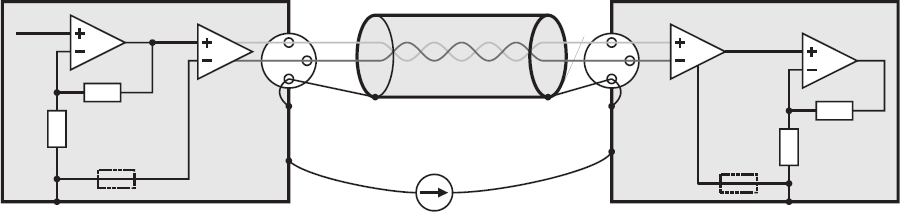

Pin1 is the connector for the screen of a cable.
That screen is an extension of the enclosure. The screen goes direct to the enclosure via pin1.
Pin1 does not get connected to the audio.

  • Grounding.pdf
    Grounding.pdf

Thanks Andrew I thought the same only the connector in the BOM are made of plastic so I wondered how it contacts the chassis.
A short wide wire made from many fine strands to connect Pin1 to enclosure. If there are two screws/bolts fixing the XLR socket then a lead to each screw would be slightly lower impedance.

A closer look revealed a small sharp contact to touch the chassis. It goes inside the connector where it contact the XLR plug's shell. On the pcb this contact is on an isolated island. The pin 1 is on the ground plane. So if one uses cables with the shield connected to the plugs shell and pin 1 everything should be OK right?
