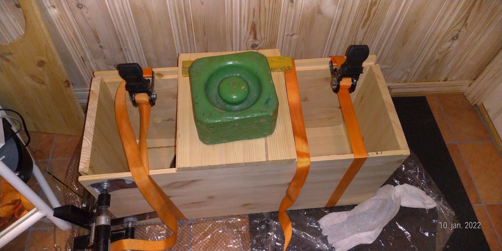

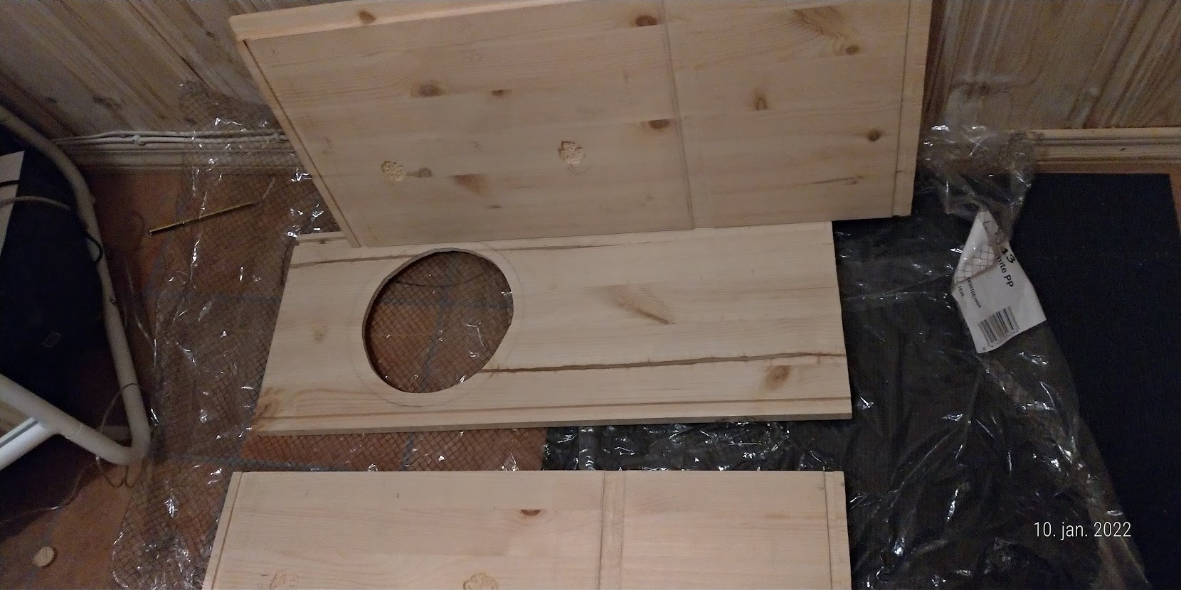

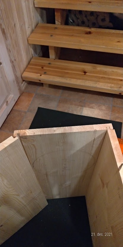

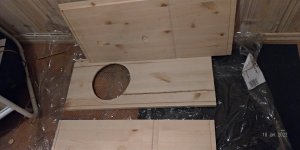

The building is going fairly according to schedule👍. Friday I was routing most of the 2nd speaker - and will glue them in a the course of the week. But family things are slowing me somewhat at times. And I am standing outside under a roof when using the router,, because of lack of a decent place inside, And in 2-6 degree Celcius and snowing at times.........
And since I use pine - I use joints that will keep its poisture for a long time - its more time consuming. Later today I will give you more pictures from the assembling.😎

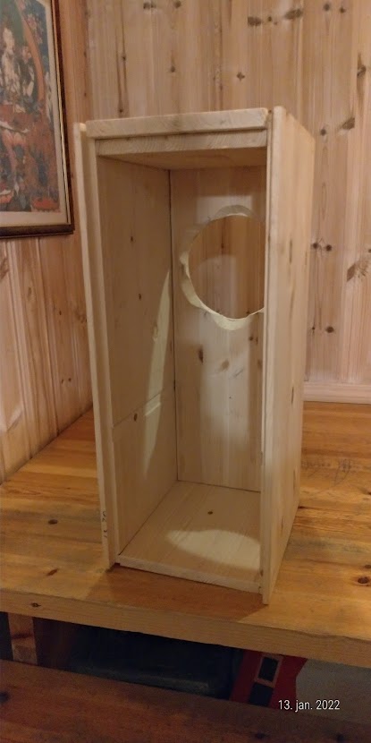

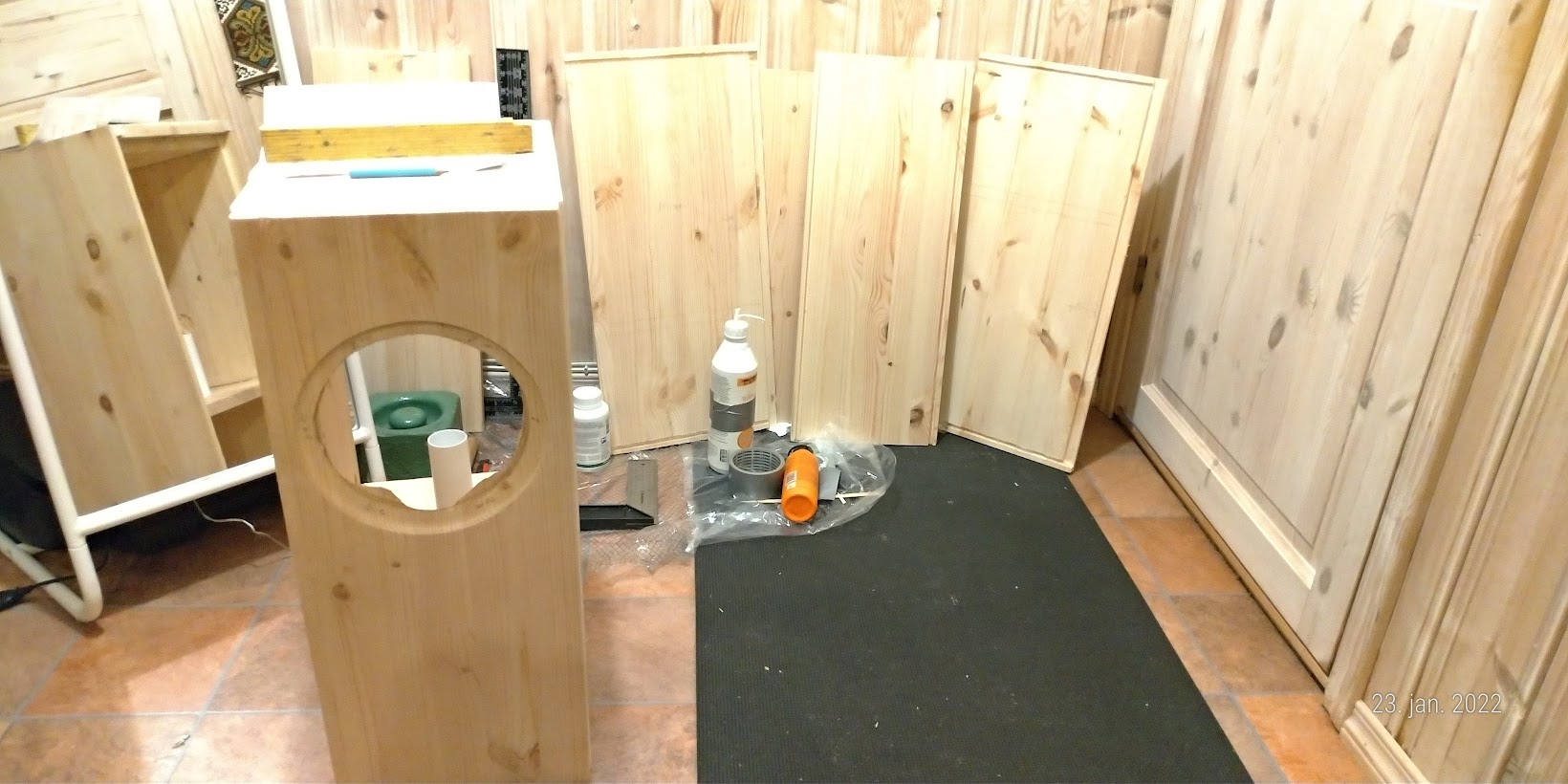

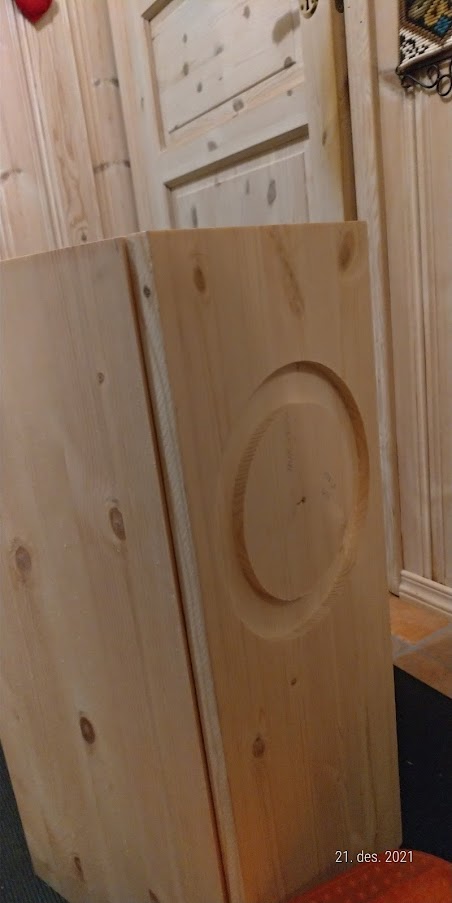

Here is a clue to the ongoing building. Some smalll routing/sawing and the glueing. Will make it a good box - so takeing good care in all cuts. But there is a birthday party this week which will delay my progress - but at 68 years old and off from work - there is no hurry. But I promise I will test the system BEFORE I do the outside makeup (oil, varnish or whatever)🤓

Some delays in my building. Family affairs you can call it . Next week I can guess I will be finished to test the result. Except for the finishing touch...

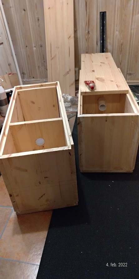

I was hoping to be finished tomorrow or sunday - but I had to step in and support my daughter with a sick child. So my 68 year of age will have some rest and then back to the finishing touch. Not much work left now - the back with ports and then some stuffing. the bracing I can do at a later tme. Also the outher finish will be done later. Looking forward to the testing of the Juliet from Scott 🤓 👍

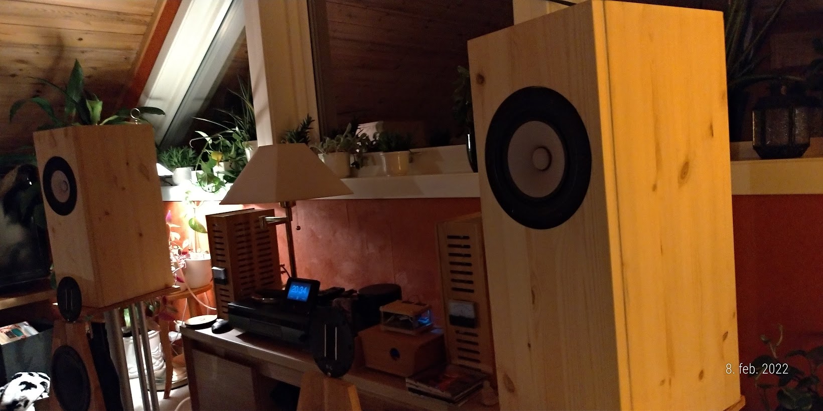

Hi to all🙂

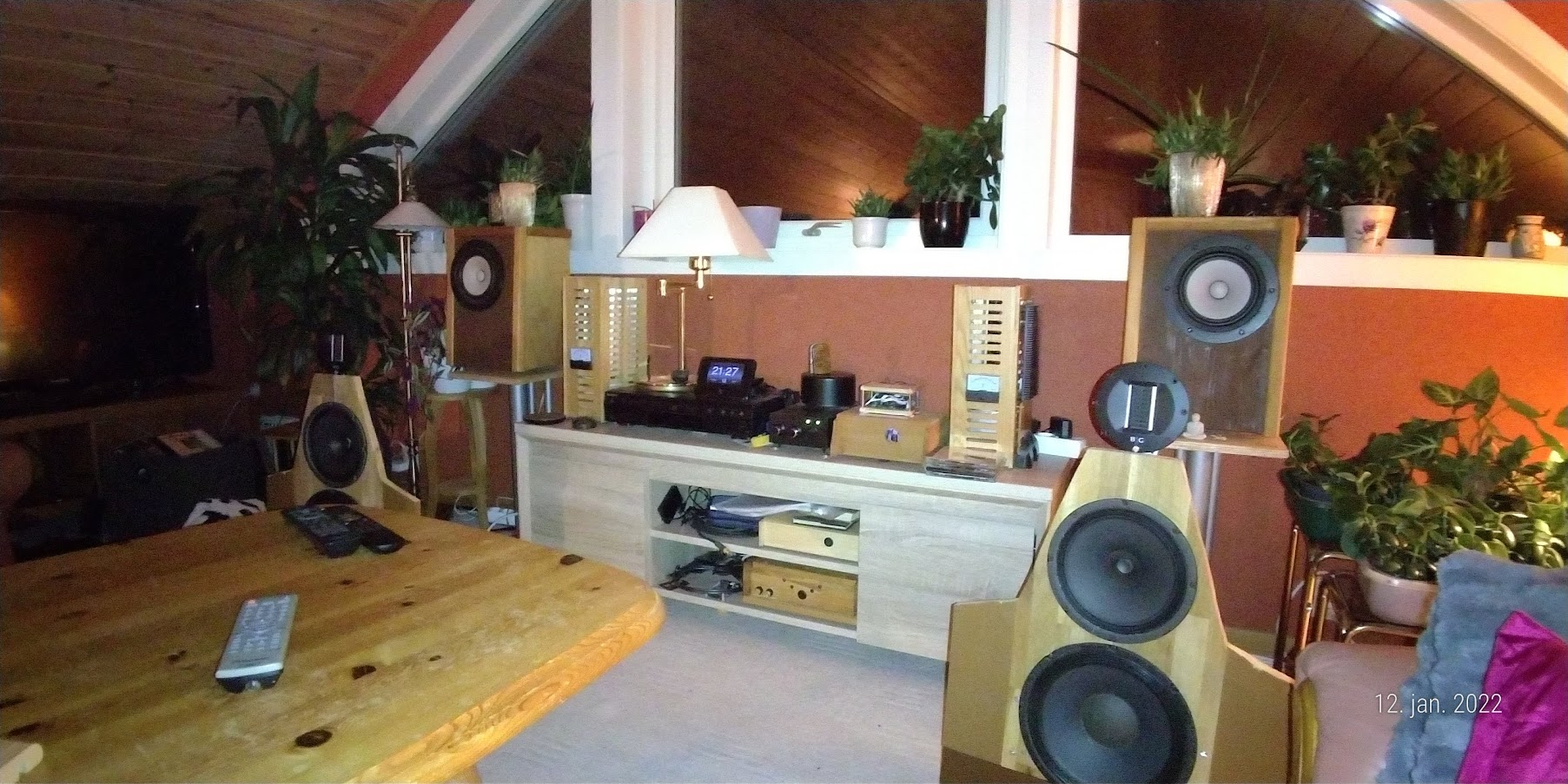

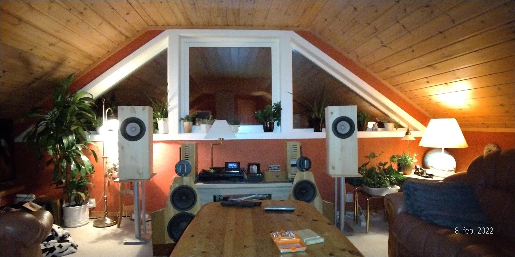

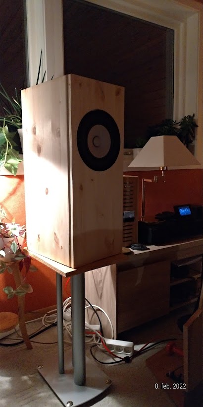

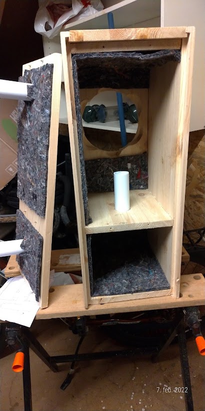

Here are the first impression from my refitting of Aalp12.2P in the Twin Chamber Box. The finishing outer touch and Bracing will be done at a later time. Also new stand or support is on my to-do list. The building is done with sheets that are fixed in thickness and width. Front is 25 centimeter and sideplates is 30 centimeter. Then i used a router to make tracks so the sheets nearly were jointed together. Some simple math were needed to make the inner measuring accurate to Scottmoose original.
Yesterday I was finished and made a late night testing. I need some better internal wiring + remaking the old good cabel to the open baffle speaker (which today is connected straight ttto the OB). And that will lift sound somewhat more.
I used Willie Nelson - Across the Borderline (Don`t give up - What was it you wanted) as my test track, and Alexander Wollenweider - Book of roses - as my first late night testing. Both is very good recordings.
Sound Impression. I think it is very good. More full body sound and a fuller impact than my old smaller boxes. Ttthere must be said I have not aaaaaa complete seal on the back yet - some minor refitting I feel. The trebbble on the Juliet is nearly on par with the AMT (which is dipol and shimmering so clean - nearly electrostatic - but more tangible and toucchable). The AMT has a more seethrough character maybe. The Alp12 haas tthe same weightless quality aas the OB with AMT - but maybe a little boxy sound in comparrision.
Later today I will try a CD with diverse tones and testtrack to see how low the Juliet will reach in the bass region.
And one day when the house is empty I will bring them down to compare them to my Alp10.2 FHXL in the larger living room. I am more found of aa paper driver and the sound of Alp12.2 than the distinct metallic driver, but the bass from FHXL is so good......
By the way - My hearing at my age is still around 15 kHz 😳(but i will try that later also)😎
That`s all ffor now☕
Best from Olav

Hi again.
Forgot to tell: My amplifier upstaaairs is a homemade Luminaria SIT preamp - Two Mono SIT Resistors L`Amp (Homemade A-class) - I use a Sony SuperAudio CD and a couple streamers . This combination had no problems to raaise the volume to satisfactory late night level. Todaaay i will give even more powe when listening to Melody Gardot`s - The Rain (fabulous track).
Downstaiirs I use a Harman Kardon HK980 - Solid state 😎
