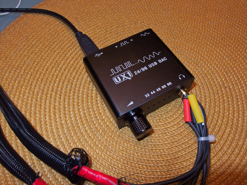

The HIFImeDIY UX1 is $70,- and trashes the TEAC in many aspects out of the box!
HiFimeDIY UX1 USB DAC (Sabre ES9023) + SPDIF/USB converter
Sure, its just 24 / 96 but for MP3 web streaming for example simply a great choice
