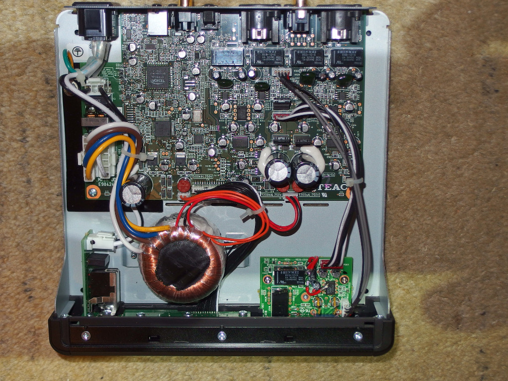

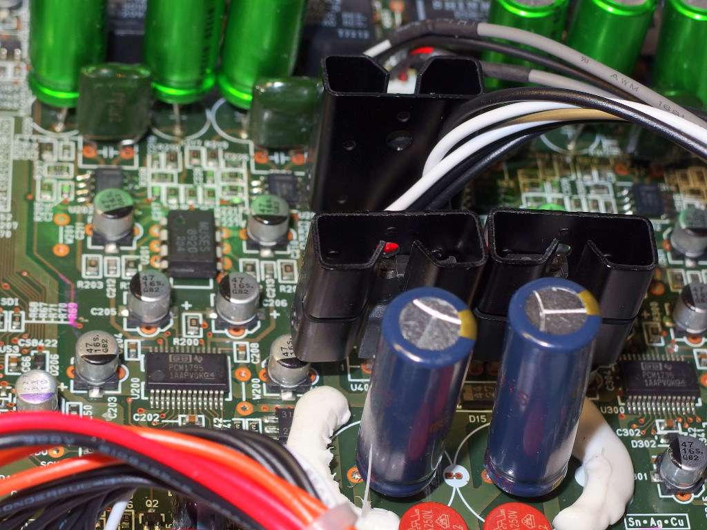

don't trash your TEAC UD-H01 DAC, pimp it!
This was the first hifi gear I deliberately bought to be modified.
Besides being advertised by lots of sells babble and having award winning specs, it simply sounds awful, especially on the headphone out. Protruding mids, anaemic, clinical and absolutely nothing to fall in love with regarding sound rendering.
But as those can be picked up pretty cheap second hand, which really is no wonder, and as they can almost play each and every digital format and have a nice footprint, I gave it a shot.

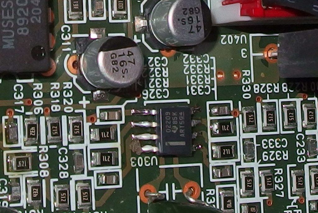

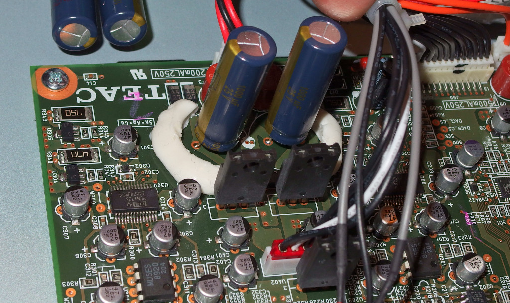

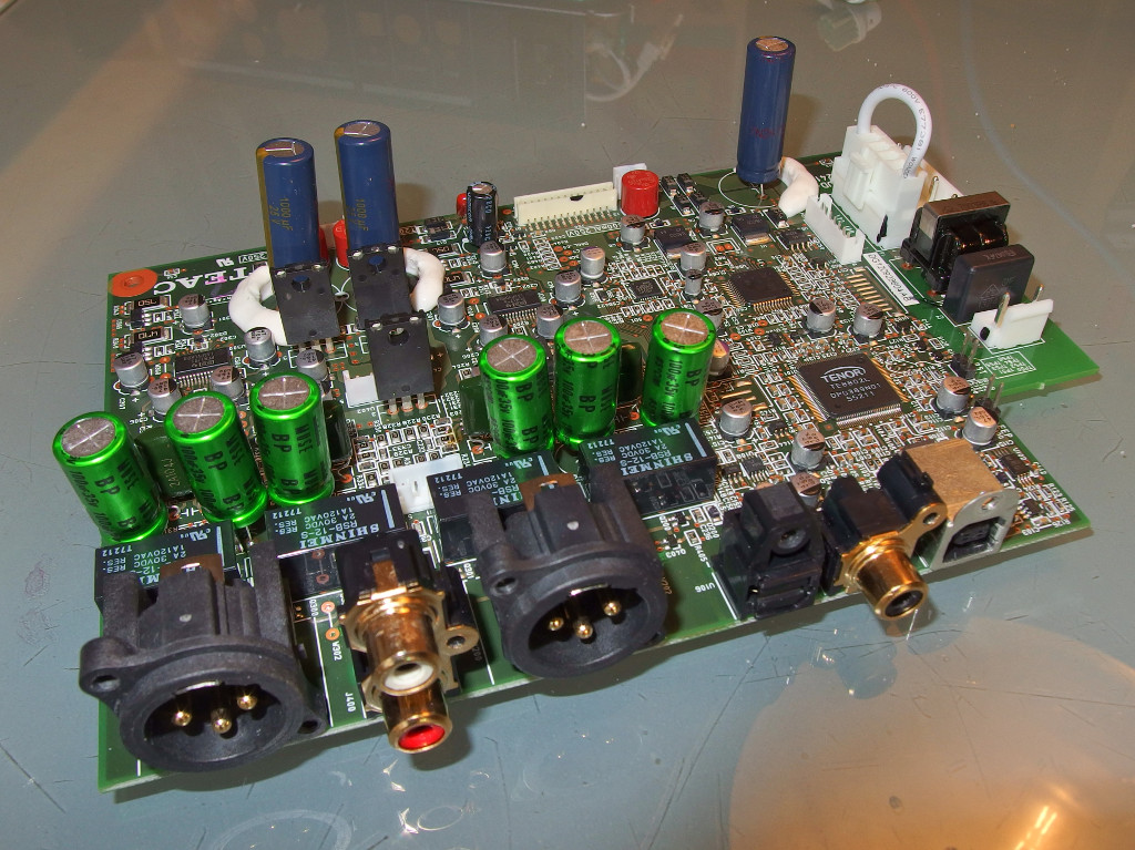

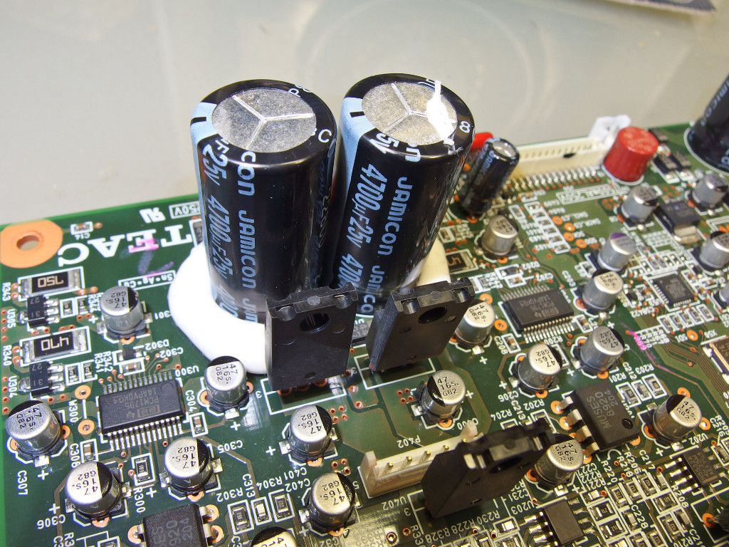

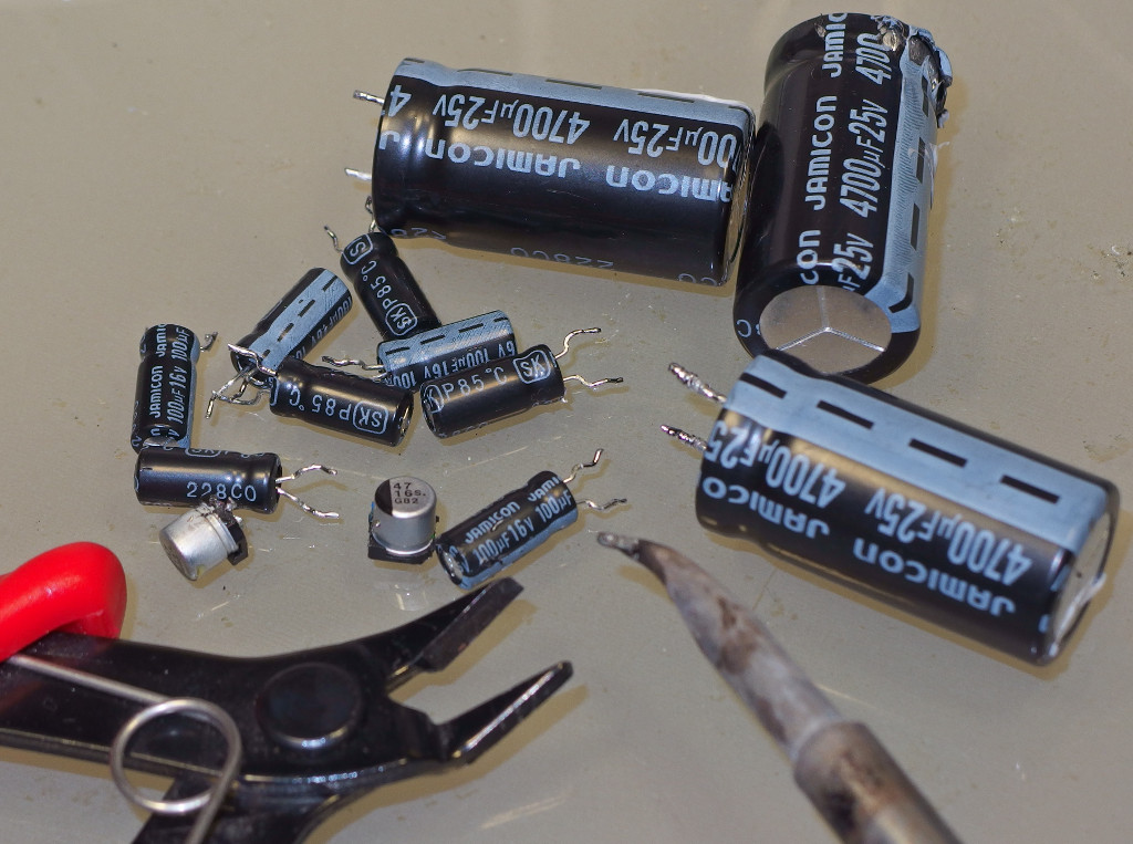

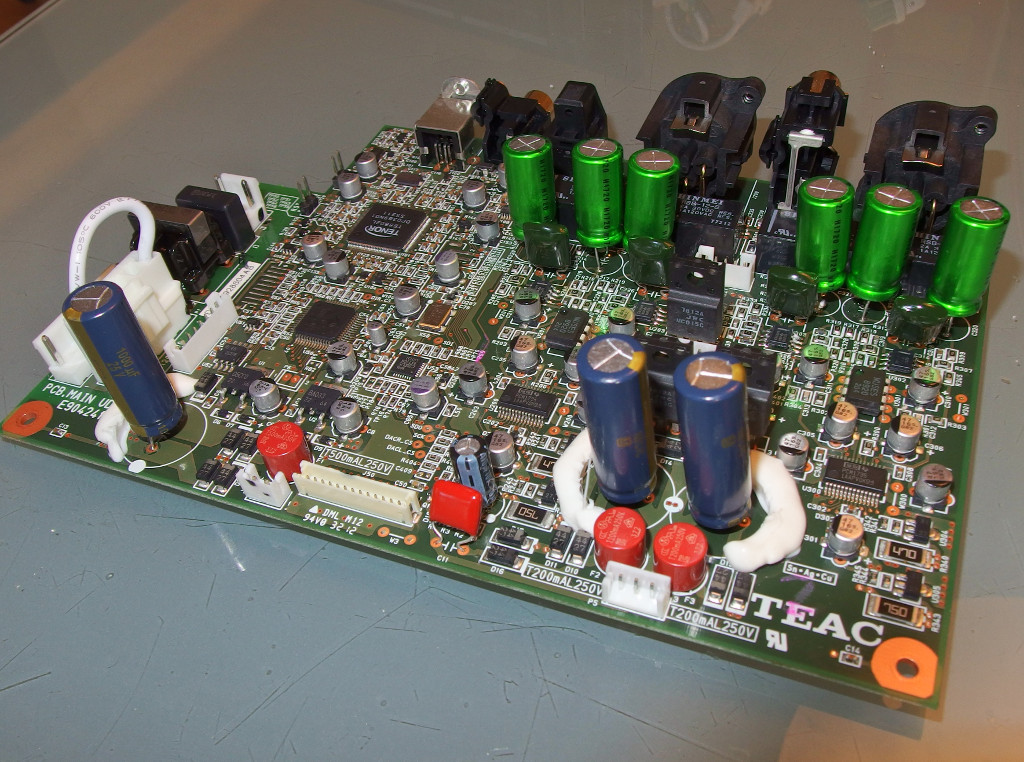

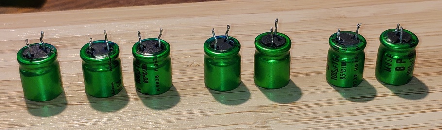

TEAC does use crappy Jamicon electrolytics not only as reservoir caps but also for coupling, hence it was a no brainer to replace them. Did use Nichicon FC and Nichicon bipolar ones for coupling. Quite any choice will be better than those Jamicon I guess.

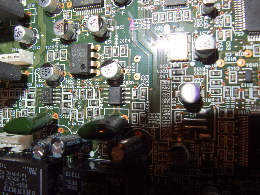

The HP section is built around the NJM 4580. Though not that bad, for cans of lower impedance and at rather elevated levels it runs out of steam. The logical choice for me was to replace it by the OPA1622 which can output roughly 140mA. I also bypassed the relay driven muting circuit as this adds roughly 100 ohm output impedance.
The symmetric line out section is built around the inferior NE5532 which I replaced by OPA2209.
All in all, presentation came greatly to live by above modifications. Love it already.

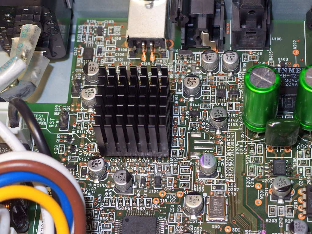

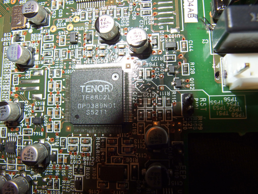

Heat sink for the TENOR chip, as this one runs really hot
Dig up and replace some "hidden" SMD coupling lytics. No schematics available so I have to spend same more time on that.

Why did you leave the I/V opamp (NJM Muse). I'd rather replace that for a high speed opamp like an OPA2156/THS4032/ADAU4898 and leave those NE5532 in.
You could also try to lower the Iref resistor from the PCM1795s to around 6k (designated R300 and R200).
Don't even have a clue what stock Iref resistor is in there. No schematics available

Having read the NJM Muse datasheet again, I'd really recommend to get rid of that and replace it with an opamp that has higher GBW. Solder the SO8-DIP adapter directly onto the PCB, those socket connectors do no good as I have experienced with my PCM1794a DAC (and likely I've seen on your HP amp board). Maybe you can re-use those "miracle opamps" somewhere other.
If you're on it, replace those 47µF 'lytics around the DACs with something like SMD polymer tantalums.
The Iref resistors (R200 & R300) are nominally 10k, according to Doede Duma (DDDAC) he's got best results with 6K8. I'm not sure since this applies to a PCM1794a and PCM1795 is different in that it output current is only half of that.

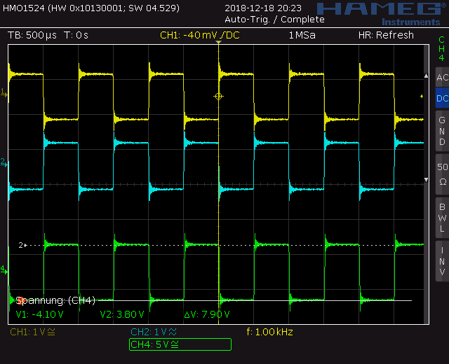

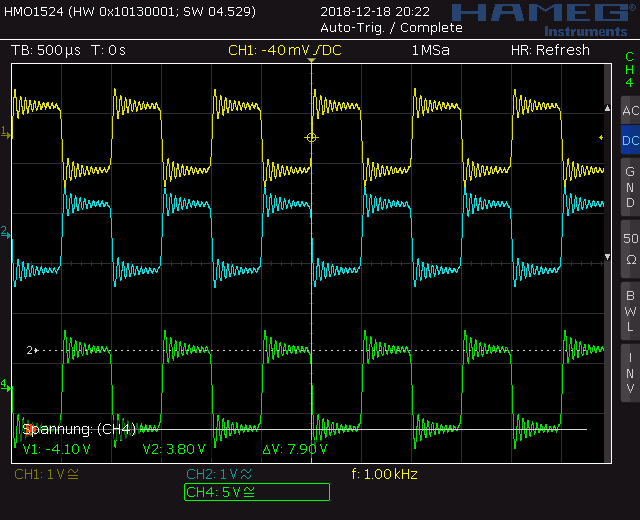

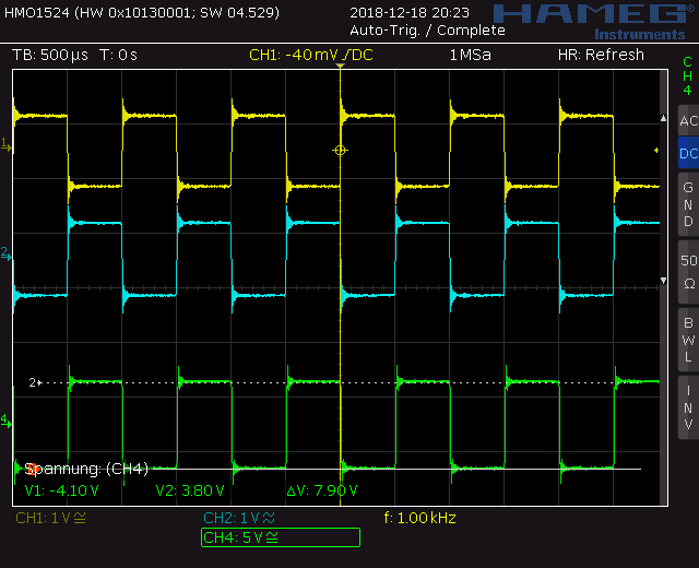

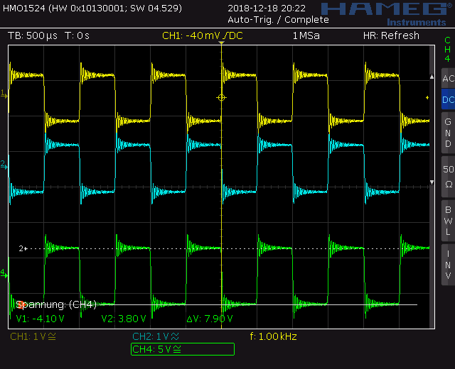

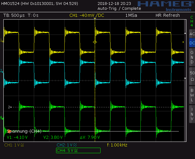

Now that I might have spotted the most delicate points in hardware and elaborated for me a way to improve hardware sonics - though not yet fully there - I started to dig into behaviour of reconstruction filters at various bit rates.
All measurements shown were taken with 16bit square wave files created by Audacity at 0dB (more to that later). Yellow and blue trace are XLR hot/ cold, green trace is HP out.
24bit output looks no different.
Here are given some easy to read explanations on the topic of reconstruction filters to compare with:
High resolution audio, asynchronous USB, oversampling, upsampling and stuff: The current state of affairs – Audial
All measurements are taken from the TEAC UD-H01 fed by a Linux/ Ubuntu PC through Guayadeque Music Player.
This one can be configured to output directly to ALSA layer, and thus circumvents the system wide used PulseAudio layer. PulseAudio seems to resample each and evertyhing into 48kHz before passing to USB, if any PC sounds must be mixed.
