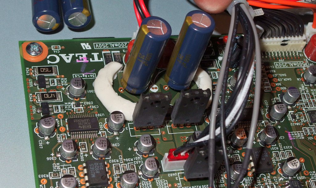

don't trash your TEAC UD-H01 DAC, pimp it!
No sorry, my former post was not meant for the UD-301. My UD-301 went back untouched.
But as for my listening impression, its stock form is quite a step up to the UD-H01 in stock form IMO mostly due to its more refined design, but not enough to come even close to my modded UD-H01.
So I rather decided not the go the same route again, especially as the UD-301 does not feature a dual clock and any 44.1kHz material (and multiples thereof) suffer from the same trans-sampling jitter as the UD-H01 does.
As for you modding, I would suggest to just do the same as I did with the UD-H01. Roll the capacitors first.
For the UD-301 there is a service manual and schematics to dig up in the web, so its a much easier platform for modding.
Good luck

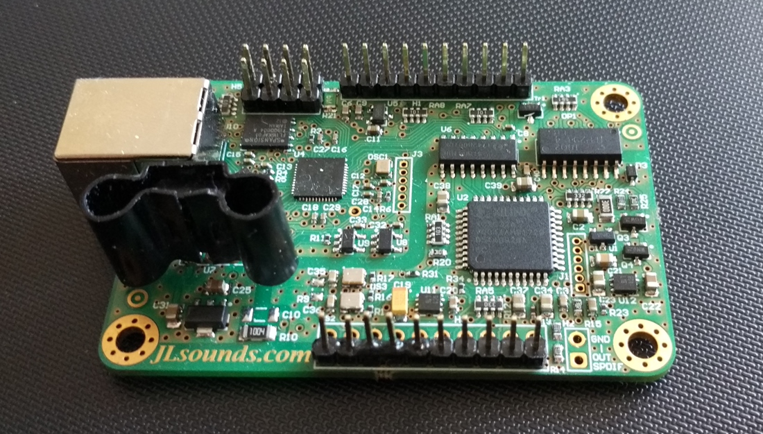

Chermann, If you're just looking out for a decent I2S (&more) interface, why not take a look at the I2SoverUSB v.III from JLsounds. It provides SPDIF out as well after reclocking and isolation. So no need for those "fancy" USB isolators.
do you mean this one?
I2SoverUSB - I2S over USB Audio
I would possibly give it a try as well. Any well documented mods available?
Not sure if that can be marriaged with the TEAC.
Yes. IMHO its worth every € (& I own a orig. Amanero and a lot of various Chi-Fi XMOS Interfaces. Lyuben, the designer, provides a TheSycon driver as well, something that is important as well. I'm just missing dithering for 16Bit output.
Edit: regarding the possible connection to your TEAC: forget it. even if there might be some arguable way of soldering all the I2S signals, at the end it will be a mess judging from the pictures that you've provided.

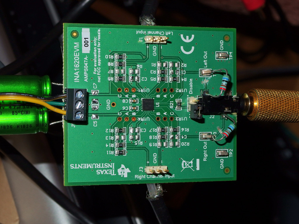

Also my subjective feeling is that channel separation isn't all that great as could be expected from specs. Would possibly gain further from a split PS arrangement.
Crap
Those INA1620EVM boards suck.
Its not that the channel separation of the chip is bad, its the crappy SMD (C1 - C4) capacitors that degrade common mode rejection to an unacceptable degree.
Not enough, once removed the somehow technical presentation further improves considerably towards enjoyable musicality, telling, that those capacitors were not only way off in tolerance but also severely degrading sonics by their make.
C5, C6 rail decoupling, same crap.
Best to also trash them and just place Nichicon bipolars 100uF or so at the power IN (superior to the 1000uF FC).
Also removed my input capacitors for best CMRR in a previous step.
Not quite there yet, but already way better.
Yeah, C1-C4 also left me wondering given that TI states the INA part has some kind of EMI filter already integrated in the chip itself. Instead of removing C5,C6 i opted to scratch off the paint an add a few more 2u2/50v X7R and very important to add a cross cap vom +Ve to -Ve. But still I haven't listened that much to that board.
Yes, in the data sheet of the INA1620 / OPA1622 they state, that they match the four resistors to 0.004% at best which translates for the 1k at hand to a max. tolerance value of 40 mOhm.
Any degradation beyond that degrades the speced CMRR, and its sonic outcome is even worse, when its not constant over frequency.
They certainly could and should have done better. At the very least they have had to provide an in depth explanation of the stock circuitry on the EVM board, discussing such gross design flaws 😡
I found the original rail caps to degrade musicality, hence I removed them.
On the other hand, I use silver MICA (at the bottom of the board) in parallel to the suggested bipolar Nichicon.
So, what upsampling chip is used there? Probably a SRC4392 or a AK4136 ... That would be a inserting point for an external USB interface.
PCM1795, after TINA, IMO no way to add external USB interface
