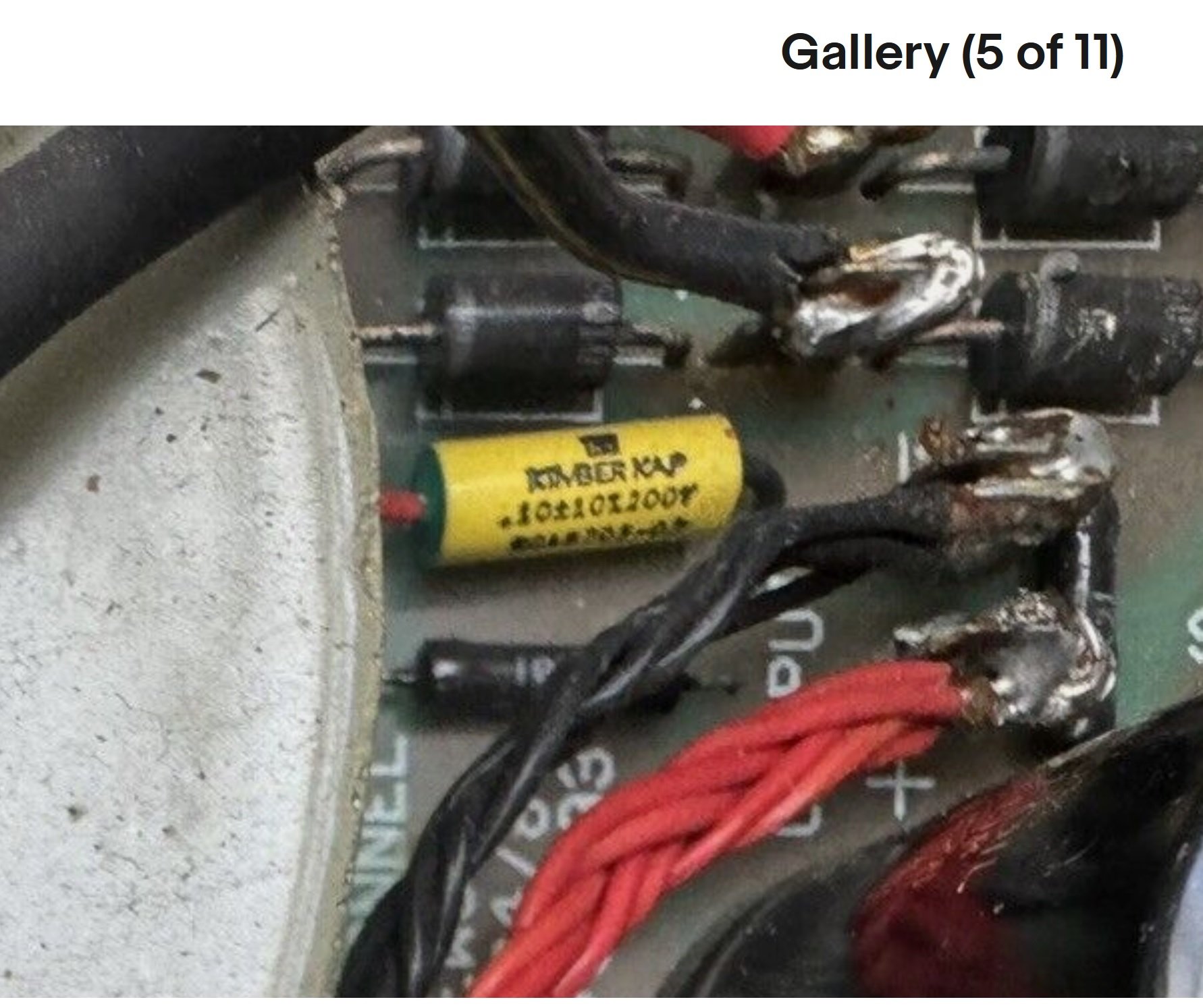

You can learn more about the Maplin (straight out of the Hitachi apps leaflet) in this thread: https://www.diyaudio.com/community/threads/maplin-mosfet-amplifier-ga28f-construction-thread.257488/Did the Maplin circuit have a proper set of drivers? This one has two little TO-220 heat sinks next to the power devices. I assume those are EFs biased in class A at several 10’s of mA, and should be able to do proper charge suckout, as well as push out the pole frequency caused by input capacitance (even boot strapped it is still a limiting factor).
The Htachi 7500 is essentially the same amp, but with a couple of tweaks. I tested one into a 4R7 load @ 10W and found that the 1978 amp could deliver well under -100dBV distortion at this level (I didn't go further in terms of load due to time, but I might revisit the project at some point for fun).
It strikes me as odd that the designer of this amp could appreciate the gate capacitance issue, yet fit heatsinks that cannot dissipate anywhere near 60W continuous. I wonder how hot the OPS will get in dummy load testing? It's a good job that they are Lat-FETs....imagine BJTs in this scenario...
Image from Ebay link. A £5.5K amp?
A 60 watt amp only dissipates a maximum of about 15 watts in each power transistor. The formula is Vcc^2/(pi^2 RL). Real world with music played “loud” is around half that. Stiffly regulated power supplies help this, because the unloaded supply voltage is lower. This reduces dissipation in the *backed off condition, which is most of the time. With a loosely-goosey +/-45V supply (that drops to 35 at load) the power (and loudness) would be exactly the same and the power transistors run hotter, with up to 25W each. Those heat sinks are a little small for that for sure.

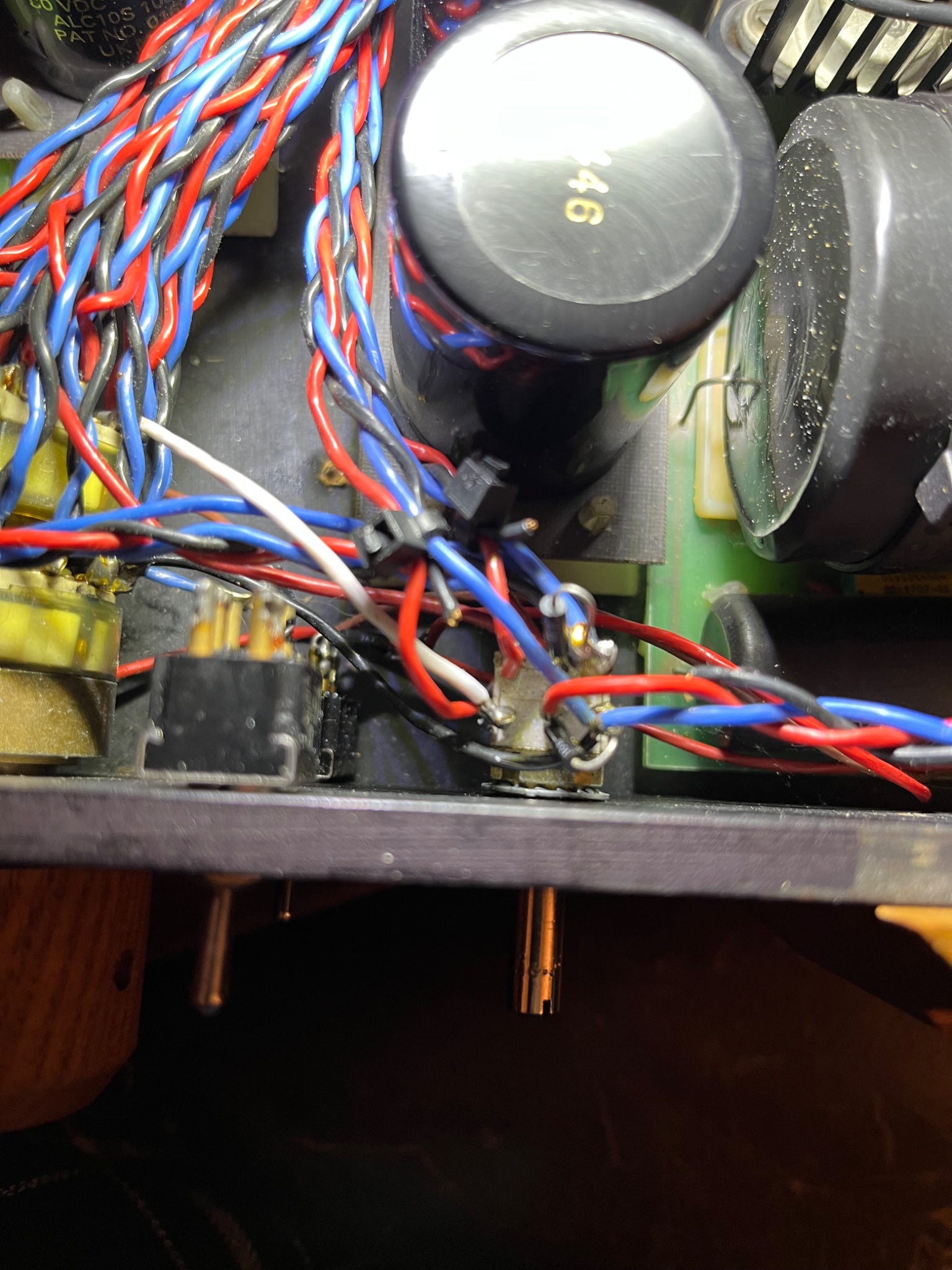

Well I didn’t try the Rata as a preamp because after tracing the cables from the rca’s at the back I can see that cables coming from the record and tape defeat switch have been disconnected from the volume pot .
- Don’t all laugh at once!
