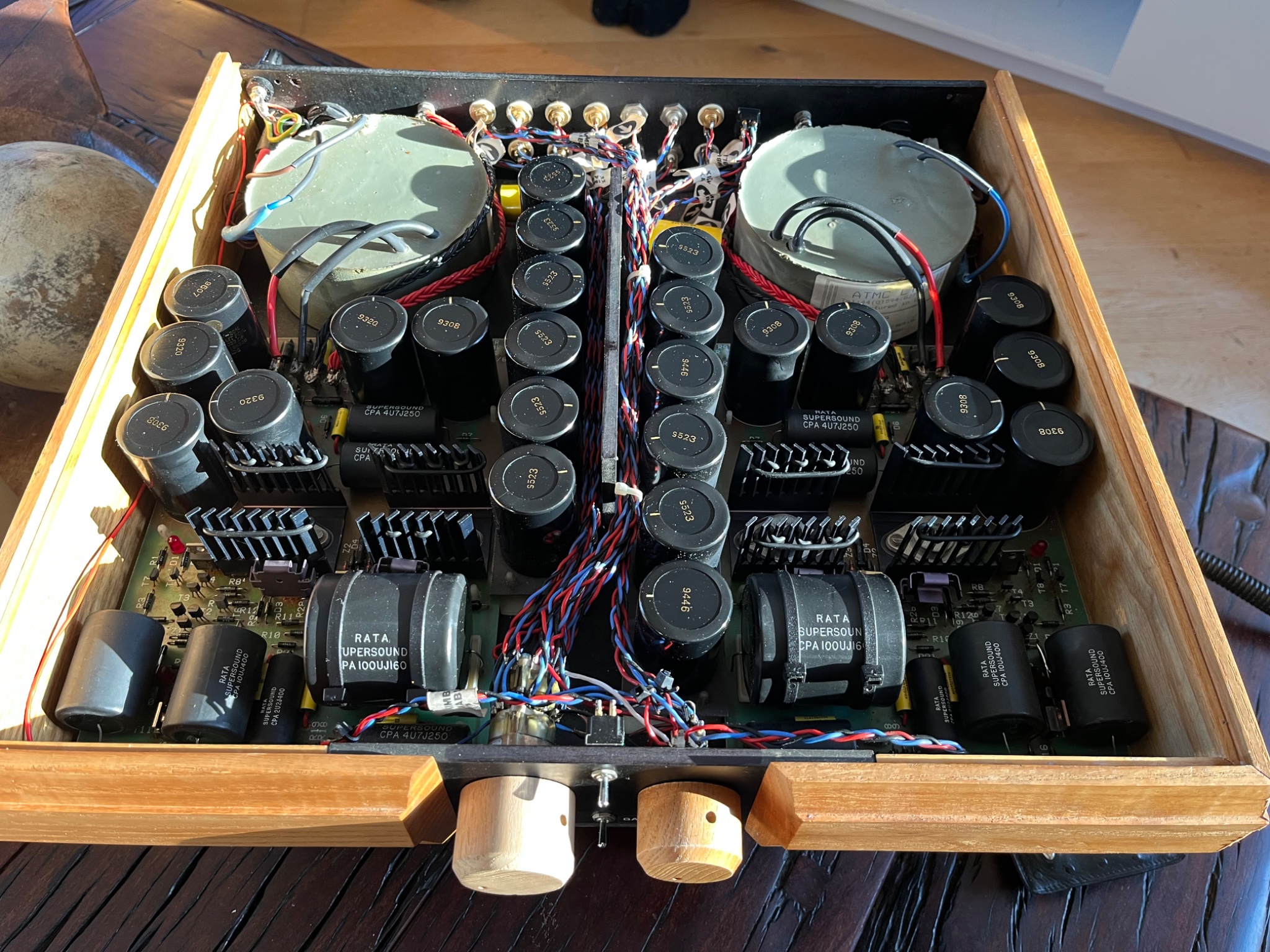

I thought it was large diameter solder wrapped around them. Probably a means of avoiding vibrations...Why the silicone O-rings on the heat sink fins?
I see TO-3’s with the old thick non-polished base. Who was still using those in 1994 (cap date codes)? Not any of the usual suspects, except for the Exicon or Hitachi lateral FETs. Everyone else who used that version of the TO-3 at all were only using it for TV horizontal output transistors, which, by then, were on the way out.
The leftmost fins are not damped, they can vibrate on the rhythm of music. What a negligence!I thought it was large diameter solder wrapped around them. Probably a means of avoiding vibrations...
Have you ever heard one of the old QSC USA series amps when you drop the unit? They ring like bells. And they just have very large versions of that type of heat sink. You know it’s to avoid vibration, and sounding “cheap” when given the thump test. The thing is full of overpriced capacitors, and the last thing a manufacturer wants is a defect that someone looking at aesthetics could easily spot.I thought it was large diameter solder wrapped around them. Probably a means of avoiding vibrations...
Not damping the last fin won’t really hurt by much. You’re still absorbing most of the stored energy and that last undamped fin won’t make as much noise as it would have.

it has 32 times the number of output transistor fins of another 60 w/ch amp, the dynakit ST-120. This has 64 fins, ST-120 had 2.So what is it?
Judging by size of the heat sinks of TO3 transistors, the maximum power output is about 10W per channel.
OTOH it has 5.9 times as many big capacitors. 23 instead of 4.
Transformer about the same. RATA 600 va, ST-120 575 va. I've always liked the bass response of my ST-120 with only one 3300 uf rail cap for 2 channels. RATA apparently similar.

I was thinking it was a JLH1969 style amp. In class B, it can push more.it has 32 times the number of output transistor fins of another 60 w/ch amp, the dynakit ST-120. This has 64 fins, ST-120 had 2.
It looks weird, that it has so many caps but the designer decided to cut the corner on the heatsink.

Does this amp have a CE mark? I wonder if it meets UL standards (interesting soldering in the Ebay link)?
The film caps are made by Ansar - they are made in the UK and are decent value.
Where's the copper tape on the inside for EMI prevention?
I wonder just how much it deviates from the classic Hitachi apps topology (sold by Maplin, inc. pair of Hitachi FETs for around £20 a channel - a far cry from the £5.5K this allegedly sold for)?
One suspects that the amp maker has gone onto more profitable ventures since this was made. It'd be really interesting to find out how much it shares with the Maplin (UK version of Radio Shack, defunct as of about 8 years back) design... The Maplin / Hitachi design sounds lovely (I have several), but I prefer mine with EM shielding TBH.

Did the Maplin circuit have a proper set of drivers? This one has two little TO-220 heat sinks next to the power devices. I assume those are EFs biased in class A at several 10’s of mA, and should be able to do proper charge suckout, as well as push out the pole frequency caused by input capacitance (even boot strapped it is still a limiting factor).

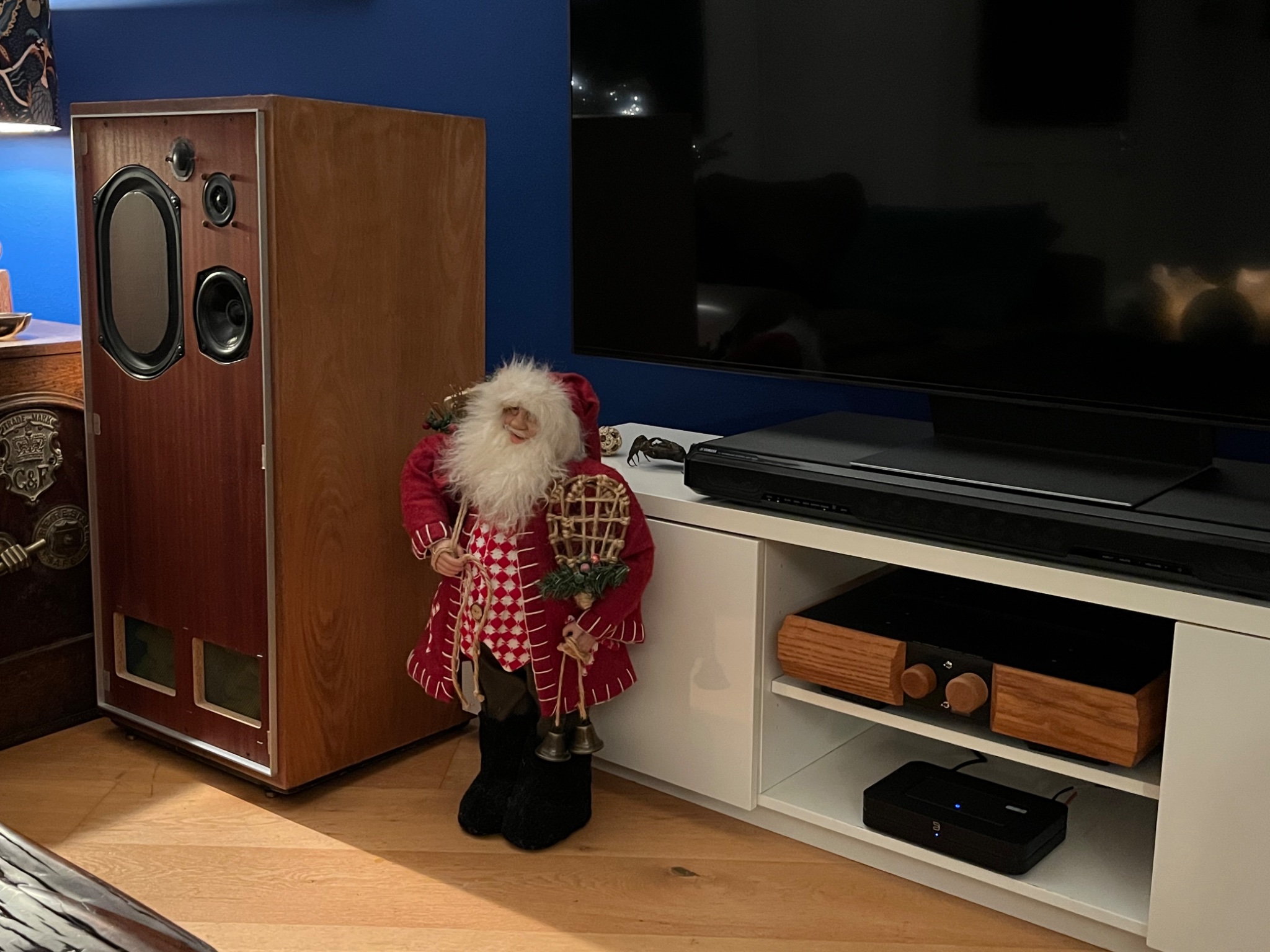

Those IMF speakers are probably the best transmission line speakers ever built - you should have good deep strong bass. I am surprised that the RATA amp drives them better than the Stasis2 though.
I can’t figure that out either Gary , the highs are sweeter and the soundstage is amazing with the Rata 🤷♂️
Could the Stasis be too powerful for the IMF’s perhaps? I know they don’t like going loud ( I think the kef bass drivers are only 50watts )
Oh yes the bass is just lovely, I prefer the sound of these over the Troels Gravesen ( not their looks though 😁)
