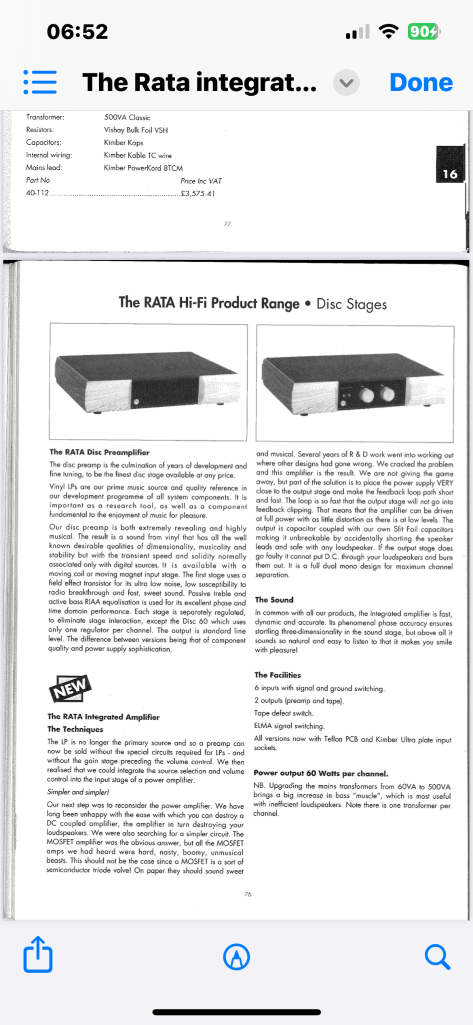

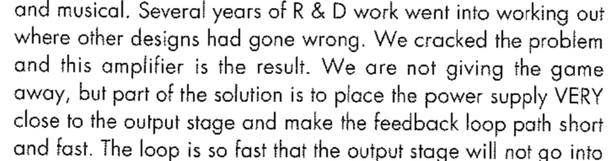

Well I don’t really understand the workings of amps ( apart from my Stasis 2 ) but apparently the use of the 2 x 500va transformers as opposed to the usual 2 x 60va transformers takes the amp from 30wpc to 60wpc without any distortion at maximum volume 🤷♂️( Sure is HOT > we've just started a week long heat-wave )

I'm thinking that because the amp. is capacitor-coupled output, the output stage is probably biased @ half the rail-voltage >
meaning the amp. is probably Class A. This would explain the 'massive' power supply and said sublime sound 🙂

None of this makes even the slightest sense. It's clearly a low bias amp using premium parts. OP has unfortunately failed to provide a circuit.I'm thinking that because the amp. is capacitor-coupled output, the output stage is probably biased @ half the rail-voltage >
Yes, I failed to look at the heatsinks > it couldn't possibly be Class A.
I now think this amp. is quite a curiosity.
It might just be a 'time old' design ( with modern premium parts ) that actually uses the output capacitor to block fluctuating DC offset.
What it would be is a stiff +/-35V power supply. That will put out the necessary +/-31V swing with realistic transistor and emitter resistor losses. It takes 500VA transformers to keep the supply stiff - any less and you either won’t get that much power OR you need more starting voltage. Those heat sinks should be good enough for 15 watts each, or (35^2)/(10*8) which is worst case at 8 ohms. Since it never goes that high with music, it will tolerate 4 or 2 ohms unless you’re turning it up to distortion.
An amplifier with a 100 or 200VA transformer, making loosesy-goosey +/-45V (or even 50V) rails would put out the same power, run HOTTER, and subjectively sound dirtier with less bass when run to clipping. And probably be marketed as a higher power amp.
