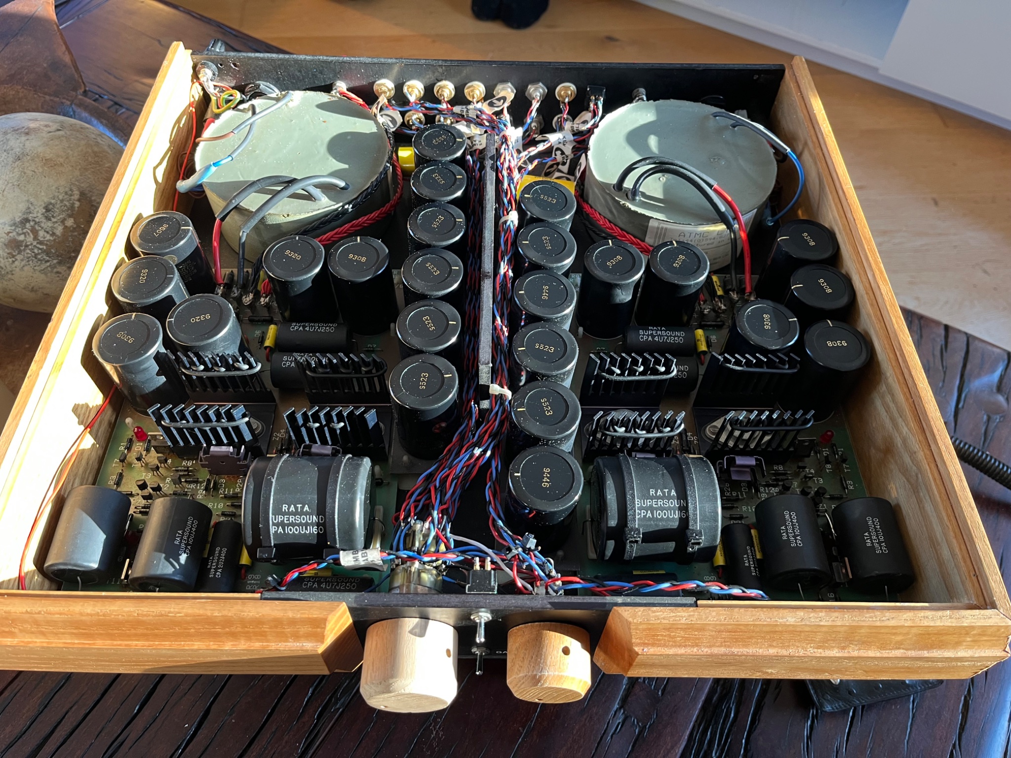

60wpcSo what is it?
Judging by size of the heat sinks of TO3 transistors, the maximum power output is about 10W per channel.
How much voltage do you get at the filter cap? Based on the size of the heat sink, it should be class b. From the supply voltage, you can get the theoretical max power.
If you were to drop the VA of the transformers from 500 VA to 60 VA (at the same no load voltage) the power capability of the amp would drop from 60 wpc to 30 due to excessive sag.
60 watts per channel simply sounds like it has more bass, when 30 is driven to clipping to produce the desired level.
