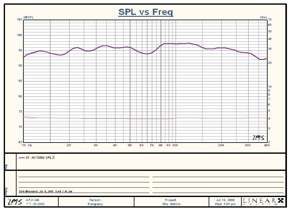

There are good and bad AMT's. The top of the line Mundorfs are superb in FR, smoothness and dynamic range.
How much smoothing was applied to the frequency curve?
I don't see it specified, so the flatness is difficult to judge.
Curt did the measuring not I so you can email him from his webpage if you want more info. Thinking it through, what purpose would there be to excessively smooth FR when you're evaluating it for a project? It wouldn't make much sense would it?
Curt's been designing speakers for several decades and he simply doesn't make many if any mistakes.
HTH
Jim
Aurum Cantus AST2560 frequency curve
Jim,
I don't question the quality of the AC driver; it certainly is a good one.
Your frequency curve looks very nice, very flat; however the vertical scale is 5 dB/division.
Here is the frequency curve of the AST2560 datasheet, published by Aurum Cantus.
Look at the difference in the vertical scale: 1 dB instead of 5 dB of your curve.
Now the curve looks quite a bit less flat, especially between 4k5 and 8k or so.

I think you may have misunderstood my response. I wasn't bragging about how flat it was. However Curt told me he did flatten the response with the crossover about 5 db to pull the top end up and compensate for the roll off. The crossover is quite simple. Check with Curt if you want more info. He develops ideas that I come up with and collaborates on driver selection, cabinet design etc. with me. But, he's the brains of the collaboration, not me. 😉

Note that the scale is 5dB per division. It is just barely maintaining within a 4dB window from 2K to 20K which isn't that impressive.Wow Jim, that AC is very flat, all the way down to 2khz.
