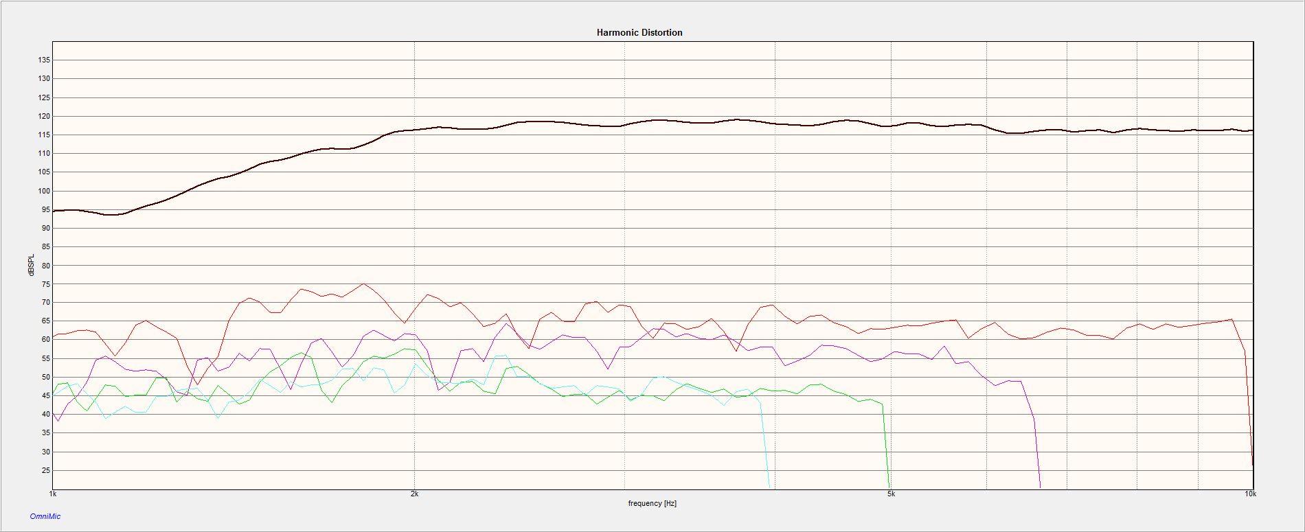

Here's a measurement at 2.8V. of the AST2560 we used in the Bordeaux.

Wow Jim, that AC is very flat, all the way down to 2khz.

That AC is not that flat by itself when I check the manufacturer's specs.
I guess that there is some equalizing in the crossover at the expense of efficiency, which is no problem in itself.

Nope, that was the raw driver with no crossover attached. This is real world testing, not manufacture specs.

How much smoothing was applied to the frequency curve?
I don't see it specified, so the flatness is difficult to judge.
