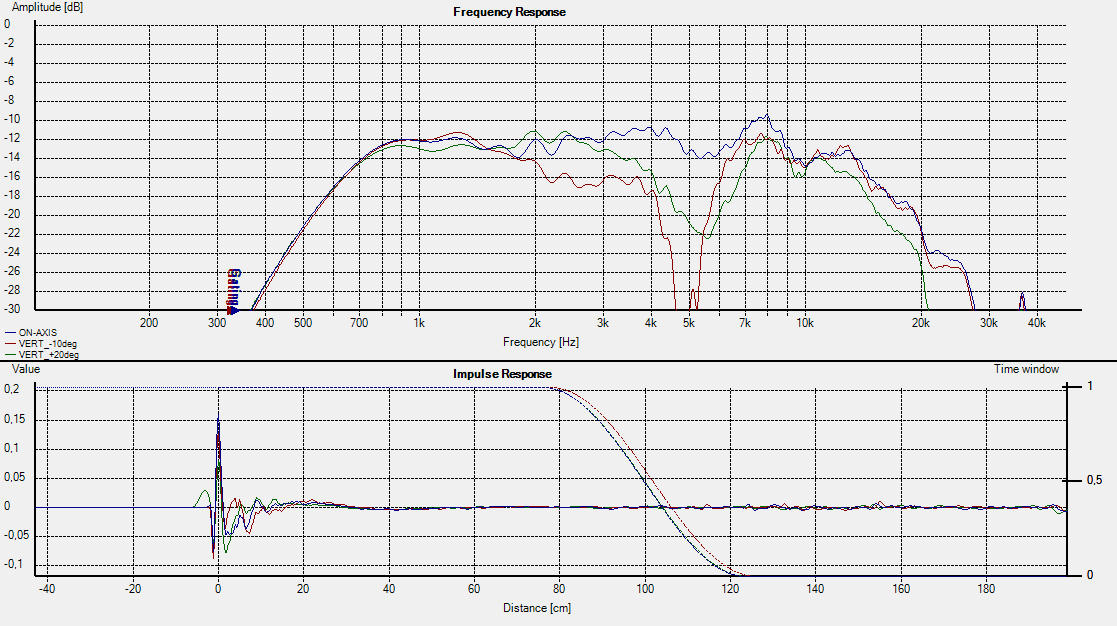

Also a lot of dome midranges have large face plates and/or magnets which limits how small you can get the centre-to-centre spacing with the tweeter and therefore how high you can cross to the tweeter without compromising off-axis response.
Tell me about it! Most 2" dome mids are as big as 5,25" cone drivers. Center-to-center distance 11 cm, x-over at 4,5 kHz and resulting vertical listening window about 10 degrees... But the horizontal polars, 92 dB/W/m sensitivity and that smooth 1...3 kHz make up for it.
Another con for dome mids is that they tend to give more diffraction effects in that 1...3 kHz range than cone mids due to their wide dispersion. You can see that from the below graph too (16x26 cm baffle with 1,2 cm chamfered edges).
