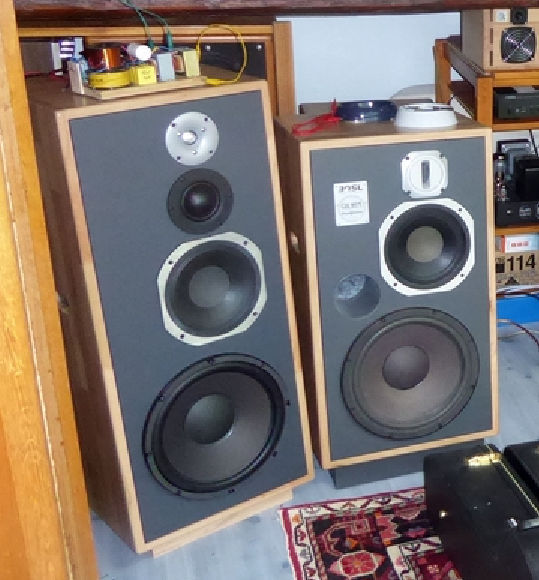

Below, my 375L (right) and 475L (left) :
For the 375L, transition frequencies are 400Hz / 4500Hz.
the Midrange is a BEYMA 8M60N.
For the 475L, transition frequencies are 300Hz / 4000Hz / 10000Hz.
The Low-Mid is still a BEYMA 8M60N, and the High-Mid is a SB Acoustics MD60N 2.5" dome.
Crossovers are Serie 1st order, with progressive slope going from 6 to 12dB/Oct.

Hi thanks a lot for the interesting informationFor the 375L, transition frequencies are 400Hz / 4500Hz.
To be honest i do not see the need for the 4th way Any decent tweeter can cover from 4kHz up Personally i would take the 375L solution
But i see a 300-400Hz crossing with the woofer and 4000-4500Hz with the tweeter

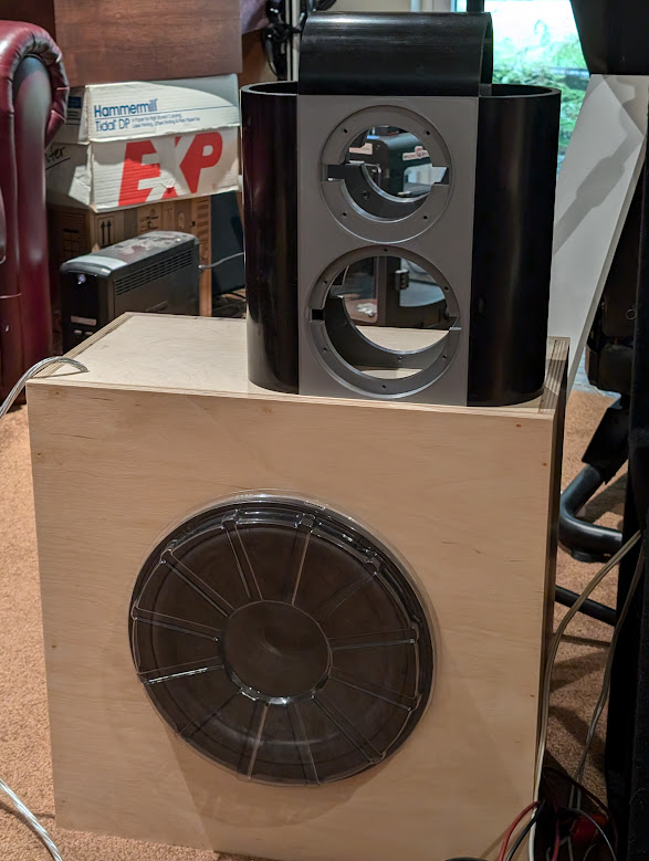

A few thoughts from my summer speaker build where I selected the BlieSMA 3" dome.
First you need to determine the dispersion that you want from the speaker and then the maximum SPL.
If you want narrow dispersion, that 6" or larger midrange and a tweeter with a waveguide will be a nice match.
If you want wide dispersion, a 3" driver with a 1" dome and no waveguide will give you wide dispersion.
Looking at 3" or 4" drivers, a cone driver with a 1' voice coil will be power limited for SPL vs. a high quality 3" dome that has a 3" voice coil.
I was targeting 108 dB or higher SPL max at one meter for the full range 40 Hz to 20,000 Hz. The BliesMA 3"
had sufficient power handling and Xmax to produce this level down to about 450 Hz. As I was going for very wide
dispersion I crossed it to the 1" dome at around 2,300 Hz.

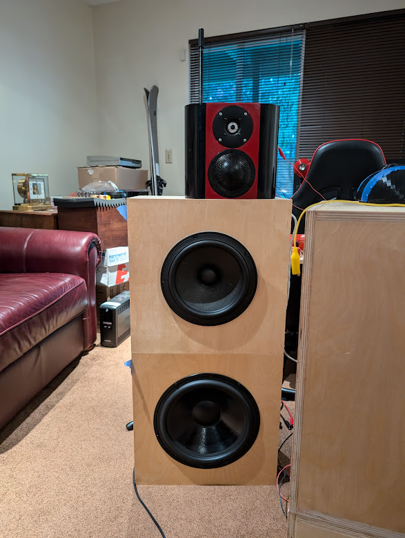

Here are a couple of pics of the build. Using low crossover frequencies of 450 Hz and 2,300 Hz the pattern is practically omni-directional up to 10 kHz, which was the goal.
Each cabinet has drivers on both sides. The top segment is red on the front and grey on the back.
