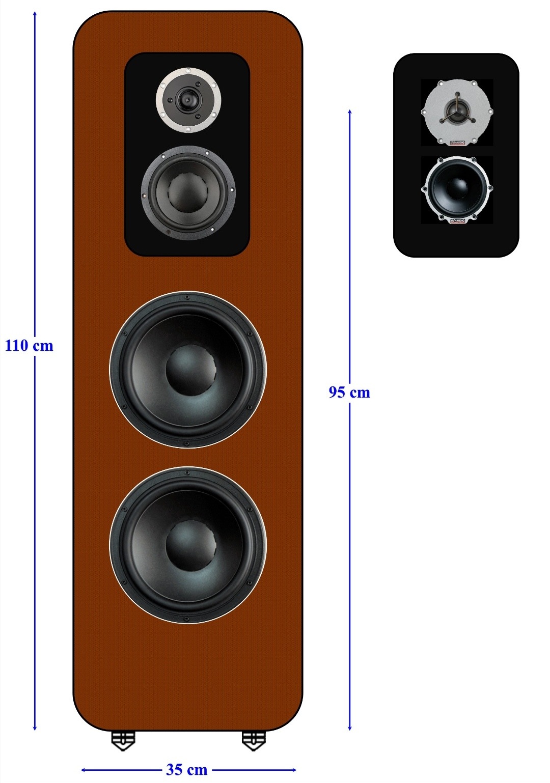

I'm ordering this new cabinet to my friend who owns cnc workshop, expecting to enable changing midrange driver 4"-5" with swapable baffle.
my newest acquisition for Dyanudio Esotar2 430 (2nd hand item but measured and look good) but have not tested it yet until this box completed.
my previous drivers : Esotec MW152, Alpair 10P, PRV 5MR450 have different characteristic. love and hate among them, but with DSP i can save different profiles for each drivers and swap easily.
my wishlist midrange for next test : Satori MR13P & SS 12M
