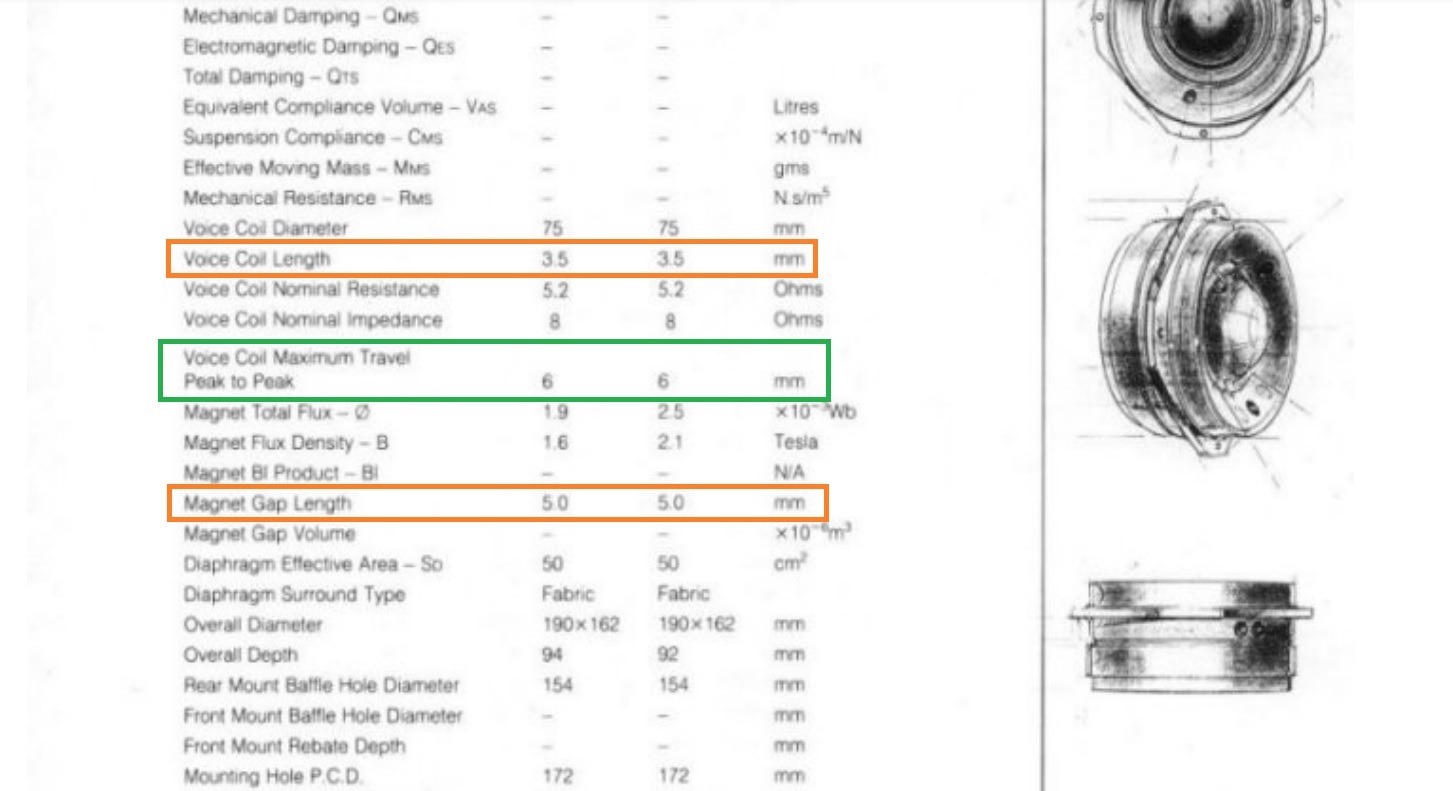

Nah, I found it, 6 mm P-P is the mechanical limit of the coil travel, not the (linear) xmax, which is +/- 0.75 mm (or 1.5 mm P-P) in strict mathematical term for an underhung motor (magnetic gap length - voice coil length)/2, or maybe a little more in the real world as specified by some manufacturers.6mm p-p linear, short coil in a long gap ie underhung.
OK thanks ! im always looking for recommendations for sealed woofers so I wondered thanks !It’s an old discontinued McBride vhp1500 that I have reformed the surrounds
I used Jeff Bagby's review of that driver here: ATC75-150S_JeffBagby.pdfNah, I found it, 6 mm P-P is the mechanical limit of the coil travel, not the (linear) xmax, which is +/- 0.75 mm (or 1.5 mm P-P) in strict mathematical term for an underhung motor (magnetic gap length - voice coil length)/2, or maybe a little more in the real world as specified by some manufacturers.

The data is probably incorrect in Jeff's review as we can see the correct numbers in the factory datasheet of the SM75-150(S).I used Jeff Bagby's review of that driver here: ATC75-150S_JeffBagby.pdf

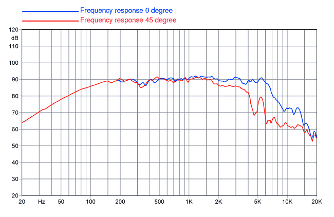

The Fane 5" driver mentioned by @fabricadetabaco caught my attention... I have been looking at a lot of 5" drivers recently.
FANE Studio 5FRK

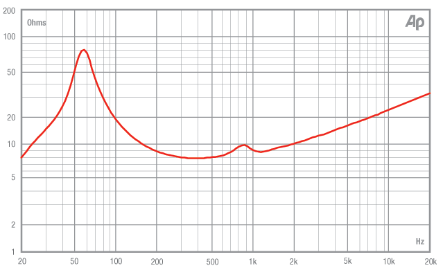

The -5 dB dip from 800 - 1100 Hz, coupled with the big impedance blip at 850 Hz, makes this driver less desirable for serious listening application. This kind of defect is probably not important in a live sound reinforcement application, where power handling, SPL output, and durability are the primary requirements. I can't see using this in a near field or mid field monitor, or in a serious home listening system.

Peak in impedance (850Hz) as well as not a very flat impedance.The Fane 5" driver mentioned by @fabricadetabaco caught my attention... I have been looking at a lot of 5" drivers recently.
FANE Studio 5FRK
j.
Unless you need it for specific reasons, but both are a no-no for me when performance is important.

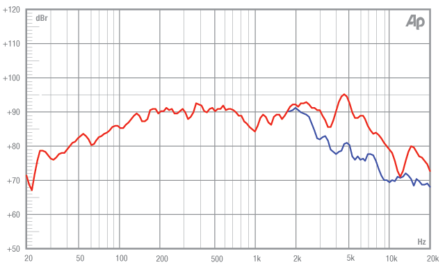

I thought so to for a very long time, until I saw this review with measurements;yeah, that one looks nice.
https://www.hifi-selbstbau.de/index.php/hsb-datenblaetter/tief-mittelt/faital-5fe120-8
Or google translated to English;
https://www-hifi--selbstbau-de.tran...uto&_x_tr_tl=en&_x_tr_hl=en-US&_x_tr_pto=wapp
Alas, not what we hoped for, especially the high H3 already popping up around 700-900Hz. 🙁
