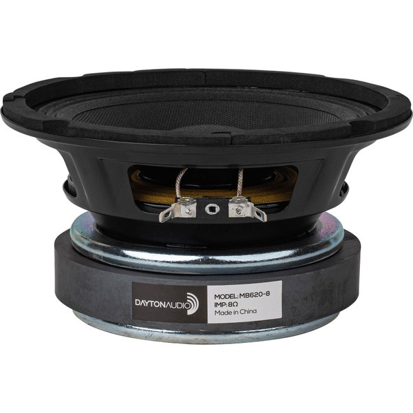

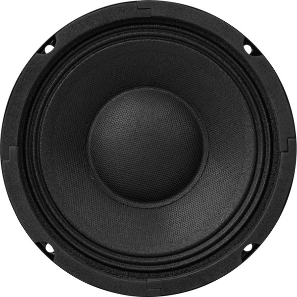

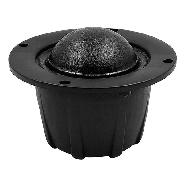

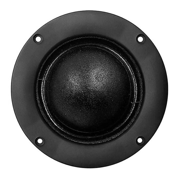

Dome or cone midrange
A bit of a conundrum here, I'm designing a three-way, settled on a fifteen incher and a ceramic dome tweeter...The choices for the all important sounding mids are a three inch Tangband dome...and a six and a half inch high power, big magnet cone by Dayton.
Now, the high power of the cone is superfluous, but the surface area requiring less displacement...does it increase outright accuracy vs. a three-inch dome ? The factory supplied SPL graphing has a perfect match to the 800 hertz & 4500 hertz crossover points...I'm leaning towards the dome for accuracy. Yes the cone is going to be beaming grossly & won't match the ceramic dome tweeter. ???

-depends on where you want the mid.s high-pass (I’m assuming the tweeter can except a lower high-pass).
Remember that with a cone mid. you likely won’t have to use baffle-step compensation on the woofer.
IF you want a low order crossover then use all 4 drivers.
You need a higher xover than 600 hz, even with a higher order slope if you want it to keep up with the 15. The other issue is the abrupt swing in dispersion at the 15" to mid dome handover, which can create uneven power response. The other big issue is the limited SPL capability of the mid dome if crossed too low. I wouldn't go lower than 800 - 900 hz 3rd order min if you want some hope of it keeping up.
That being said, if you get the xover right and make them combine well, a mid dome can sound better than a cone. I'm a huge fan of dome mids. I hope you're successful with the project.
That mid dome (if its the 3" version) looks similar to the ATC SM75-150, have low Fs and high xmax (for a midrange). For good polar match to the 15" woofer I think you can cross as low as 350-400 Hz with 4th order (24 dB/octave) acoustical slope, shallower slopes are not recommended IMO. Easy with active xo. Probably needs an impedance flattener circuit if you plan using passive xo.

That Tang Band mid dome can't be compared to the ATC, which is more voltage sensitive, handles way more power and has more xmax. The biggest issue for me is the price - $180 for this newer version of Tang Band mid PE sells is really steep.
I've used both the older version of the Tang Band mid (75-1558SE) and the ATC SM75-150 (non S version) . The 75-1558SE doesn't even come close to the ATC in almost every way. The similarities end with both mids being 3" domes.
As a comparison, I used the Scan Speak D7608-9200 in a few builds and it needs to be crossed above 800 hz 3rd order to just about keep up with the capabilities of a 12" woofer. The 1558SE can be crossed a little lower at about 600hz 3rd order if you dont need 100+ dB playback levels, but even then it starts to sound strained and shouty. A decent 5" cone mid will blow it out of the water and can be crossed an octave lower.
So I'm not trying to discourage the OPs efforts in using a 3" dome mid for his project. I'm trying to keep him from wasting a fair chunk of money on drivers that won't live up to their factory published specs.
The only other currently available high output 3" dome I'm aware of, which can be crossed lower than 600 hz and keep up to a 15" LF driver, is the Volt VM752.
Power response is gonna suffer no matter what with the large difference in baffle size assuming an 18” baffle minimum for a 15” woofer unless there’s some creative baffle sculpting in place…..the side and back response of even a 6-7” mid is gonna be very fwd balanced. Me?…..I’d do a side stand mounted three way with the dome mid and tweet fitted vertically along side the 15” woofer…..no THAT is a speaker I could dig!……sadly we’re all pre programmed for the up and down instead of side to side…..we missed Mr Miagi’s lesson! Lol
