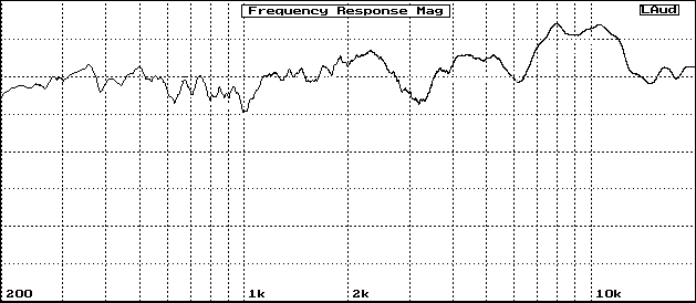

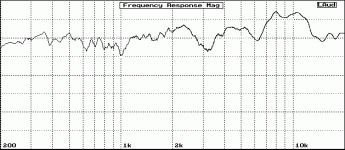

planet10 said:
All a flat FR measurement really tells us is that the speaker is flat under the measurement conditions
As an example, i attach an on axis FR measurement of a very well respected speaker -- the manufacturer is doing better than they ever have -- ie consumers are voting with their dollars -- and not because of some superb marketing maven like David Wilson... actually the opposite, the company in question has some of the poorest marketing...
Note that the measured FR is +/- 10 dB.
dave
