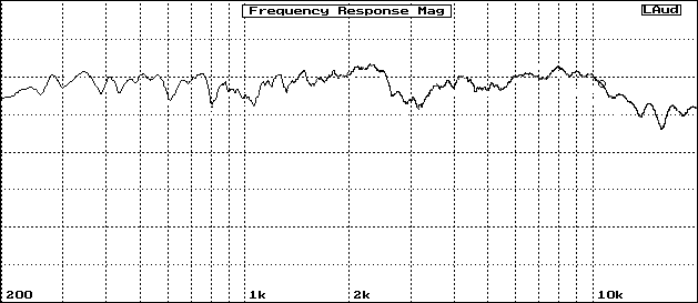

ucla88 said:
cannot emphasize this enough. Flat FR+minimimum phase behavior=correct transient response. Having either significant FR variability or non minimum phase behavior will distort transients.R.
minimum phase behaviour is just important to your equation. And that eliminates many, many candidates. Getting flat FR most often ends up screwing up the phase response seriously. One of the reasons a lot of people put up with full-ranges. They tend to be much better behaved phase wise.
However, it's somewhat of a stretch to think that a unit with poor FR variability on axis somehow becomes smooth off axis, making the power response smooth.
attached it a 30 degree off axis of the same speaker in posted on-axis for before.

Well, "flattening the FR" is not what causes non minimum phase behavior. Basically, all individual drivers are min phase, except for some very infrequent oddities. And even this is debatable.
The nonminimum phase comes from the xover, not from trying to get the system flat.
Now single drivers are theoretically appealing, but they cannot do a good job with either nonlinear distortion or smooth power response-in general. (I realized there are exception).
As far as your off axis plots, well you're right in your example. This is likely just diffraction effects. Whch do ge better off axis. Which is why diffractio may be overrated as a problem
dave
I bet people like to listen that speaker slightly off axis 🙂
I am not much experienced with full-ranges but the reason why they have a fan base may be more related to them being closest thing to point sources and the resultant nice imaging. I don't see the point in sacrificing the amplitude response flattness for the sake of some phase linearity. How much of a phase distortion is audible as far as know is still being debated, but I don't think many will debate that a 1db peak on upper midrange will change the sound of a speaker profoundly. You could have a nice phase response at the expense of having a nasty FR amplitude response. What will this gain? The linear distortion is caused by both phase and amplitude nonlinearities. If the argument is "I have the phase right, so what amplitude is screwed" is assumed correct, then what is wrong with this argument "I got the amplitude flat, so what the phase is screwed"? As a mathematical model, both divergence from flat FR amp and linear phase results in transient distortion. Add two sine waves and record it. Then change the amplitude of one sine wave without touching its phase, the sum will be distorted version of the previous sum of two sine waves. In addition to this, our hearing is more sensitive to FR amp irregularities than non-linear phase issues.
