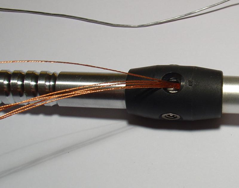

DIY tonearm cable:
on the picture you can see 4 cables. Each of them consists of 9 thin wires coming from relay coil. No need any insulation because every one is enameled. Tightly twisted.
Similar sound quallity presents VdH MCS - 150 M - copper version.
One thing is very important: the less connections the better.
