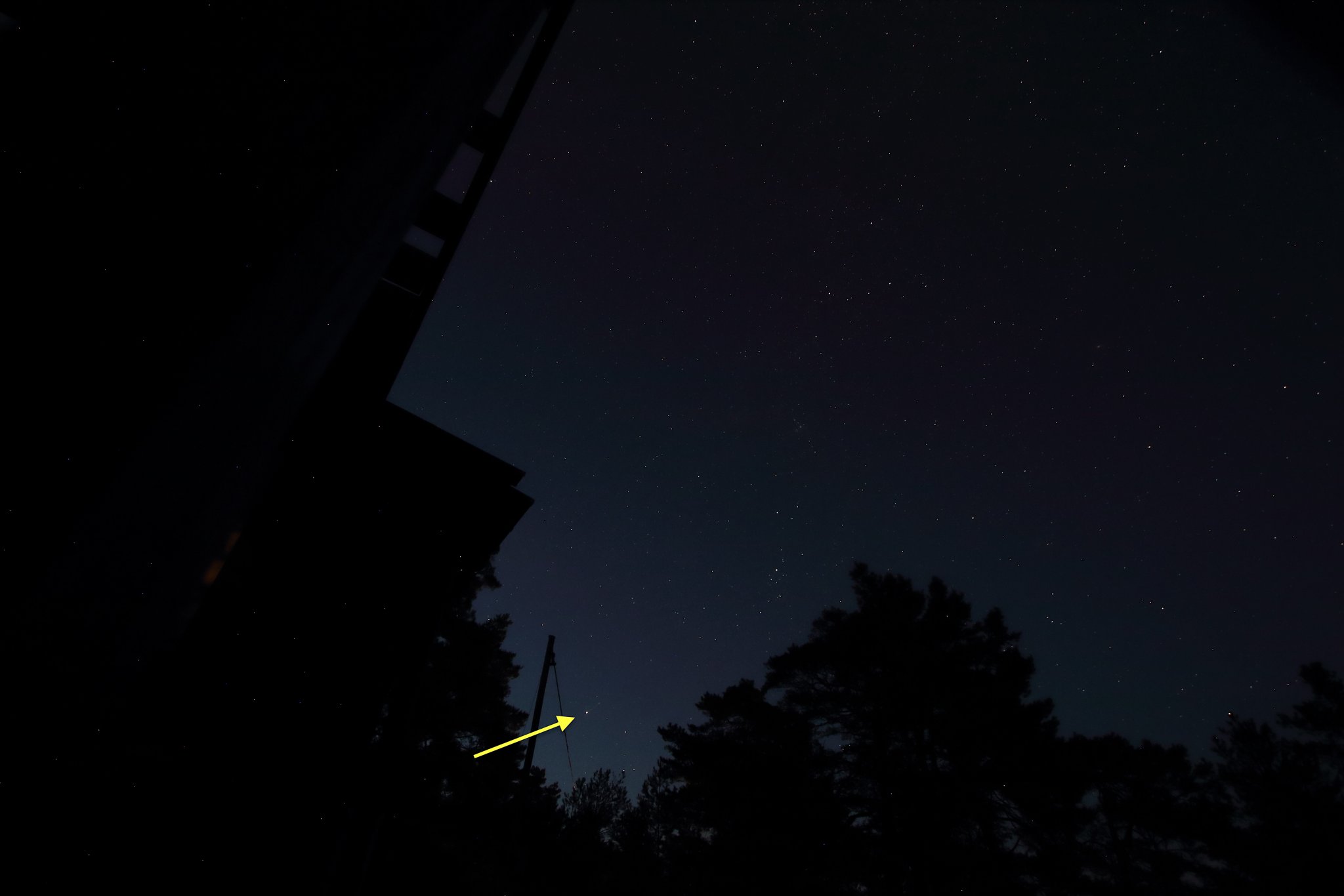

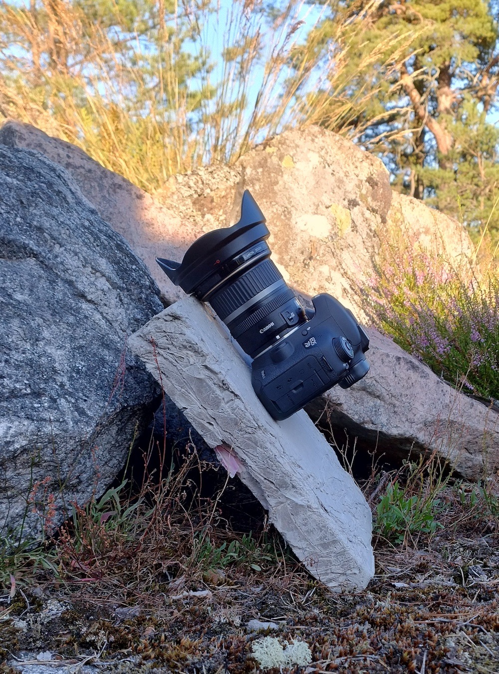

Now I'm setup for some hopefully nice captures...

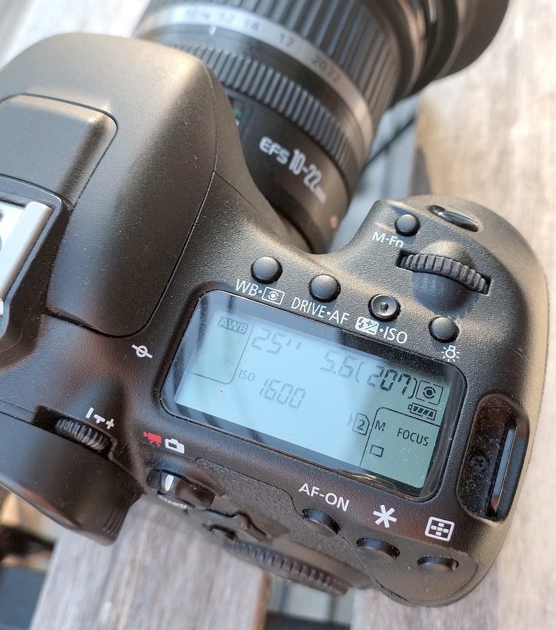

Set to M mode I could dial in 25 sec exposure but for some reason f was stuck at 5,6 and I could not maker it one step wider which the lens support... iso 1600... Haven't done this much before so a bit excited 🙃
This should give a good coverage with the crazy star in the left/lower part of capture... and hopefully some more ones in order to know the location..
I ran into this problem with borrowed full frame f1.8 prime Nikon FX lenses on my small frame DX Nikon D60. f1.8 came out as f3.5... never figured it out! The speed-dial sometimes controlled aperture and sometimes it just controlled time.
I have forgotten what your camera is, a Canon EOS D9 or something, but there might be a switch on the lens itself that needs flipping to manual if it is like mine.
Your camera might slip down the rock and break, especially in the dark. A plank and a bolt, which might be an old Imperial size because I just tested some metric bolts, that fits the bottom of the camera looks a more promising "Quick Fix" for long exposure.
Edit: Just checked, camera mounts use an ancient Whitworth 1/4-20 or 3/8-16 UNC thread. Whatever it is, my tripod works! With a sort of square mounting plate that locks in...

Here goes... started with the lens cap on... looked dark 😉

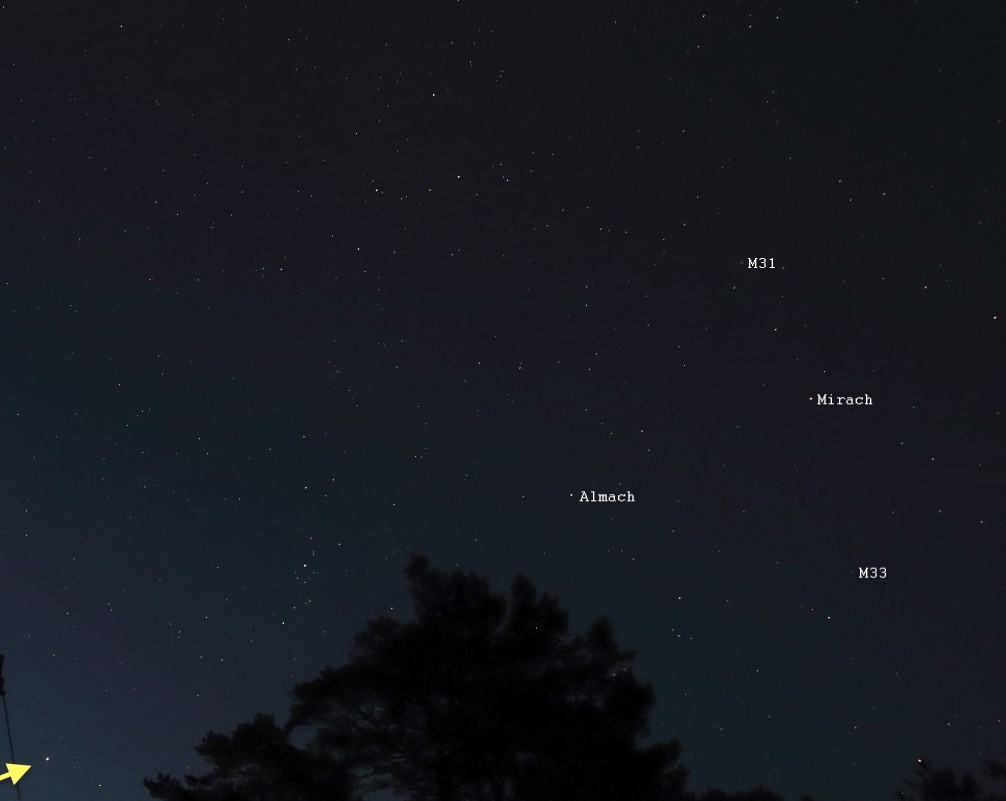

By all means click the picture - it's large 🙂 yellow arrow points to same heavenly body as I first posted a picture of i.e. the colour shifting object.
Lots of stars out there :-D

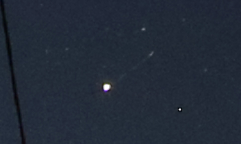

Strange strobe/line coming from the mystery star!?

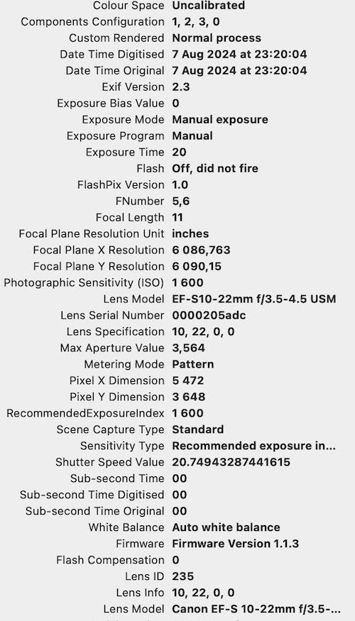

Shooting details...
I was very satisfied with the result and just did 2 or 3 shots.

Oh come on! It's Capella! Magnitude 0.
Use the W of Cassiopeia as a reference. Pole star there too, so we know it's North. No sign of the Milky Way. 🤣
Very fine image as it goes. I am impressed. Perhaps you can keep an eye out for the blaze star too. Skies hopeless tonight in Blighty.
FWIW, the f3.5 Canon lens is small format, so should do f3.5 at 10mm, less at 22mm.

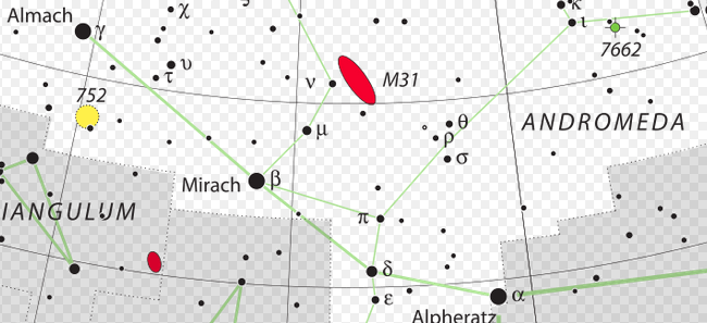

Centre of frame, highest up. Bottom left is Almach, the bright one is Mirach. Makes a right angle triangle with M31.

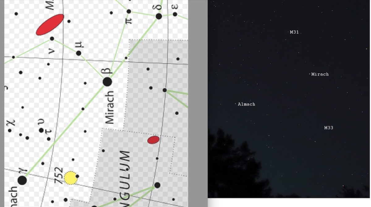

I really tried ti follow your description but I still think I would need a little arrow to help me get where M31 / Andromeda is in the picture. And perhaps what is what? 🙂

Anyway, here's my effort in MS Paint, and I have to admit I am guessing a bit with M33:
The yellow arrow marks bright Capella and the W of Cassiopeia helps you zoom in on M31 (Andromeda) and M33 (Pinwheel or Triangulum) Galaxies in Andromeda. Few rogue pixels there I think.

The trick with stars is to construct straight lines between them in your mind, and then see triangles and things pointing to others.
Bit of a geometry approach using a visual and spatial imagination. So follow a line from Almach to Mirach, turn left to Mu and continue the same distance to Andromeda.

Get it now - I couldn't make up the need for an almost full 90 deg left rotation of the map to fit the sky. Thanks for your help and insights!
