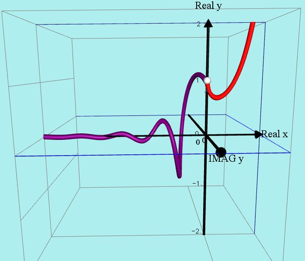

Visual: Yes.I feel my visual proof that 0^0 = 1 with the x^x function is equally compelling
However, nothing proven. I presume it is based on some analytic extension, but here I see no definition of this analytic extension. I can make tons of those, simply defining: Take your favorite pensil and scribble beyond the f(0) = 1, into R- or C.
So, what is the source of this impressive visual alleged proof.
Read my lips, @mchambin. The matter of 0^0 = 1 is closed:
https://www.diyaudio.com/community/...enerates-gravity.393908/page-164#post-7562449
To reiterate the telling x^x function:
Let's move on.
Let's move on.
And refuse to understand what I am explaining to you. I have enough of this behavior. There is no discussion, you only care about making beleive you are right.
I vaguely remember the term discontinuous graphs. Also functions.YOU REFUSE TO TELL ME THE SOURCE. That does it.
@mchambin, I got the image from Reddit or Physics Stack or something. I can't remember and have cleared my history since.
But the graph is accurate AFAIK.
You might google zero to the power zero to find it. It is more philosophy you are talking than maths, and that is a very bad thing. Just do the maths, not interpretation, as in quantum mechanics!

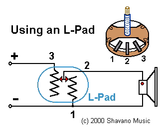

I found this about L pad
Thanks, but the discussion revolved (pun intended) around a variable L-pad control used to vary the attenuation of an 8 ohm driver - and not a fixed series and parallel resistor combination.
In the diagram above, the series resistance track on the left has a maximum value of 8 ohm while the parallel resistance track on the right has a maximum value of 120 ohm.
The variable L-pad and driver combination is said to present a "constant" impedance of 8 ohm to the crossover.
One day, I may investigate how the impedance presented to the crossover varies with the angle of rotation of a physical, real world L-pad control. It would be interesting to reveal the exact extent of the departures from the so-called "constant" impedance.

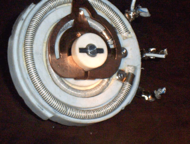

I would not mention the word 'pot' in this context. More appropriately, could the law of the two L-pad resistance tracks be logarithmic?
If so, that would mean the centre position of a resistance track is not one half of the total value of its resistance as has been assumed.
However, since the resistance tracks are wirewound, could they be anything other than linear?
EDIT: I would regard the variable L-pad as two linked rheostats.
Perry Babin gives a table that shows the values of the series resistance and shunt resistance starting at the maximum level (at the top) and ending with zero volume.
If these values have been measured by experiment, they indicate that the action of the variable L-pad is non-linear (i.e. a 4 ohm Rs would not coincide with a 60 ohm Rp).
P.S. Steve did not comment on these figures after I drew his attention to them.

Right, this is two mechanicaly linked rheostats.
Likely they are linear.
It could be non linear only by mean of using a variable winding pitch or a variable resistivity wire.
The table is odd, figures are not consistant.
It is not clear the input impedance is: Rserie + ( Rshunt // Zdriver ).

Perry Babin gives the following figures for an 8 Ω; 120 Ω variable L-pad. See section 122, L-pads: https://www.bcae1.com/
Fully attenuated: Rs = 8 Ω, Rp = 0 Ω, Rp and driver in parallel = 0 Ω, load presented to amplifier = 8 Ω
2.5 dB attenuation: Rs = 2 Ω, Rp = 24 Ω, Rp and driver in parallel = 6 Ω, load presented to amplifier = 8 Ω
Show me a speaker with 8 ohms resistive impedance...
Of course I am well aware of that, but we have to treat the speaker as an 8 ohm resistance in order to examine the working of the L-pad.
Besides, I am interested in the use of an L-pad with a tweeter whose impedance may not rise much with frequency above its fundamental resonance frequency.
That's why I had some doubt that the figures had actually been measured by experiment.
As I said earlier, "One day, I may investigate how the impedance presented to the crossover varies with the angle of rotation of a physical, real world L-pad control."
