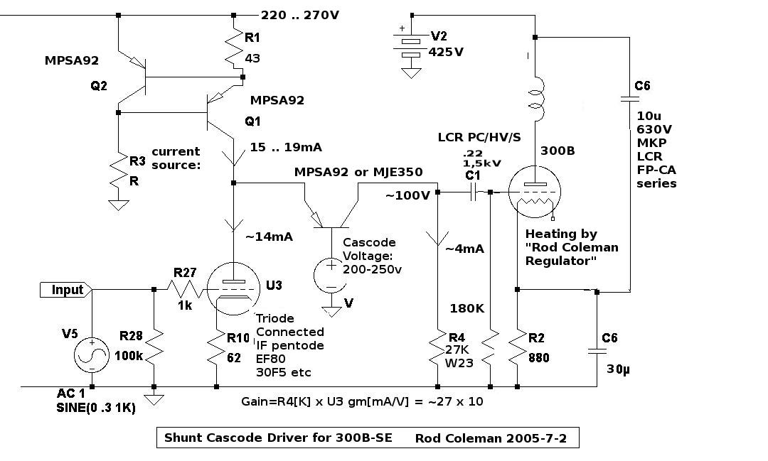

Hi Andy, I developed the circuit to work as a driver for 300B. I like plenty of gain in this application, so high-gm TV IF pentodes, triode-connected, work and sound best. I tried EF80, 6BW7, 6F23, 6F30, 30F5, and tuner triode PC86 - all sound good. Gain: 200 to 300 for a single stage. I tried the LP2 DHT in filament bias too, but they seemed a bit too microphonic, and the gain a bit low for 300B, and I did not experiment further with these.
The attached circuit, with the 2-stage MC preamp posted above, is my amplification from MC to OT - 3 stages only!

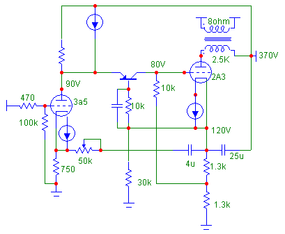

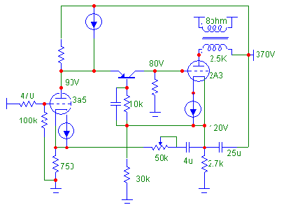

Not sure this is well thought out, but anyway an attempt at a true Lofting White version. Amp floats on output cathode and noise cancellation is made to input cathode. The ratio of input cathode resistor to string to output cathode should be about 1/u of the input tube.
I put the optional plate resistor in parallel with the current source that feeds the shunt transistor, so the option of blending in different load lines.
Sheldon

Hi Sheldon, you may be on to something, and dc-coupling must be a real possibility with this circuit.
the flexibility to choose almost any triode, and run at any anode-current without altering the anode-voltage or the load resistor (hence gain) opens up opportunities out of the reach of most circuits.
I found that the base drive to the cascode has a strong influence on the sound, and using a divider buffered by darlington-connected MPSA92s + current-source pulldown is worth the trouble. I'm looking at a purpose-designed double-shunt-regulator to nail this voltage solid - while at the same time regulating the B+. With this scheme, the current source can be replaced with a resistor across the two fixed voltages. Thus, the self-noise of the whole stage will drop. (Not that it is bad....)

Now we're cooking, Sheldon already convinced me a while back on the Darius Loftin-White but marrying it with the Taylor shunt makes it all come together. I'll be using a 6C4C in place of the 2A3 and so I'd like to see the "Rod Coleman gyrator-CCS heater supply" included here too. I've looked at the base schematic for Rods heater supply (the public version) and I think one pcb could fit all this together into a nice package.

Have you considered the burnt away power in the cathode resistorst? It will be manageble though. By adding the anoderesistor I also suppose you worsen ripple figures?
If you go back and check the DC-design I did(the left one) it can be made with anything from 0 ohm resistors and up to cathode bias. If you go for normal cathode bias with 0V on the grid you have no current through the cascode load-resistor and can use any value you decide. It only takes the gyrator and a negative voltage of maybe 100V.
Take another look and you could maybe marry them to each other😉.
