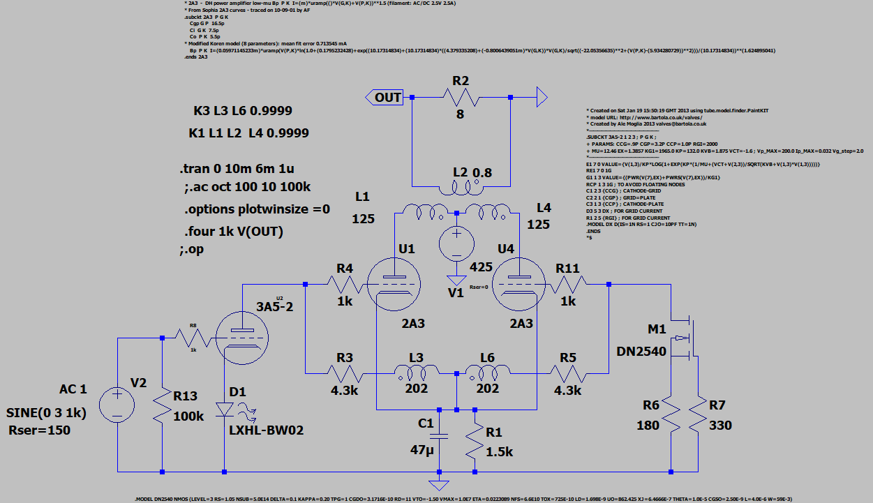

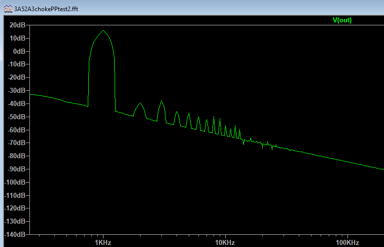

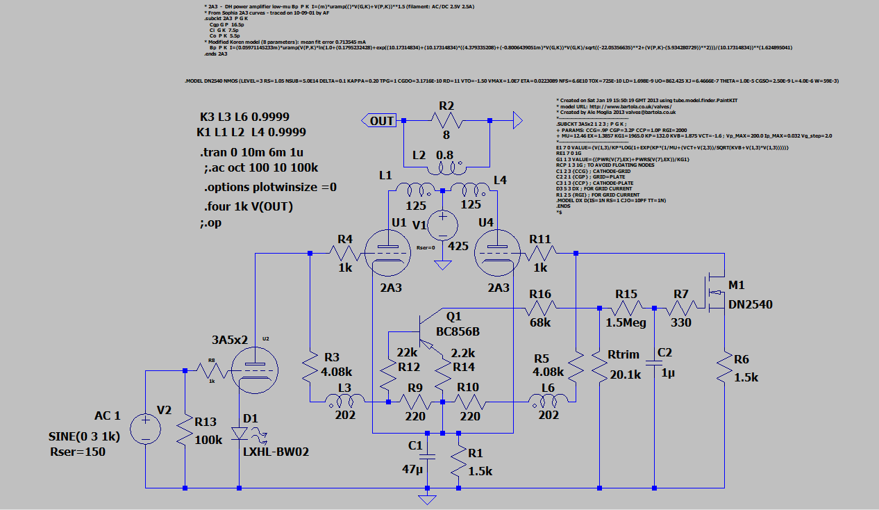

R revintage Member Joined 2007 2023-12-10 9:07 pm #182 2023-12-10 9:07 pm #182 Simmed a simple PP with the same ingredients plus a 5mA LL1667. ••• More options Share R revintage Member Joined 2007 2023-12-11 12:13 am #183 2023-12-11 12:13 am #183 Added servo, design Rod Coleman, to the PP. Indicates 0.3% THD at 5W, 2.2V RMS in. Below this 2nd harmonic is dominating. Last edited: 2023-12-11 12:20 am ••• More options Share Bigun Member Joined 2009 diyaudio.com/community/threads/tgm8-an-amplifier-based-on-rod-elliot-p3a.245619/ Paid Member 2023-12-11 3:36 am #184 2023-12-11 3:36 am #184 Very excited to see some action ! (I’m still building My 2A3, it could even be ready this winter, only a decade in the making) Reactions: 1 user ••• More options Share E ErikdeBest Member Joined 2003 2023-12-11 7:33 am #185 2023-12-11 7:33 am #185 nice to see you back @revintage! Reactions: 1 user ••• More options Share Prev 1 … Go to page Go 8 9 10 First Prev 10 of 10 Go to page Go Show hidden low quality content You must log in or register to reply here. Share: Facebook Twitter Reddit Pinterest Tumblr WhatsApp Email Share Link
