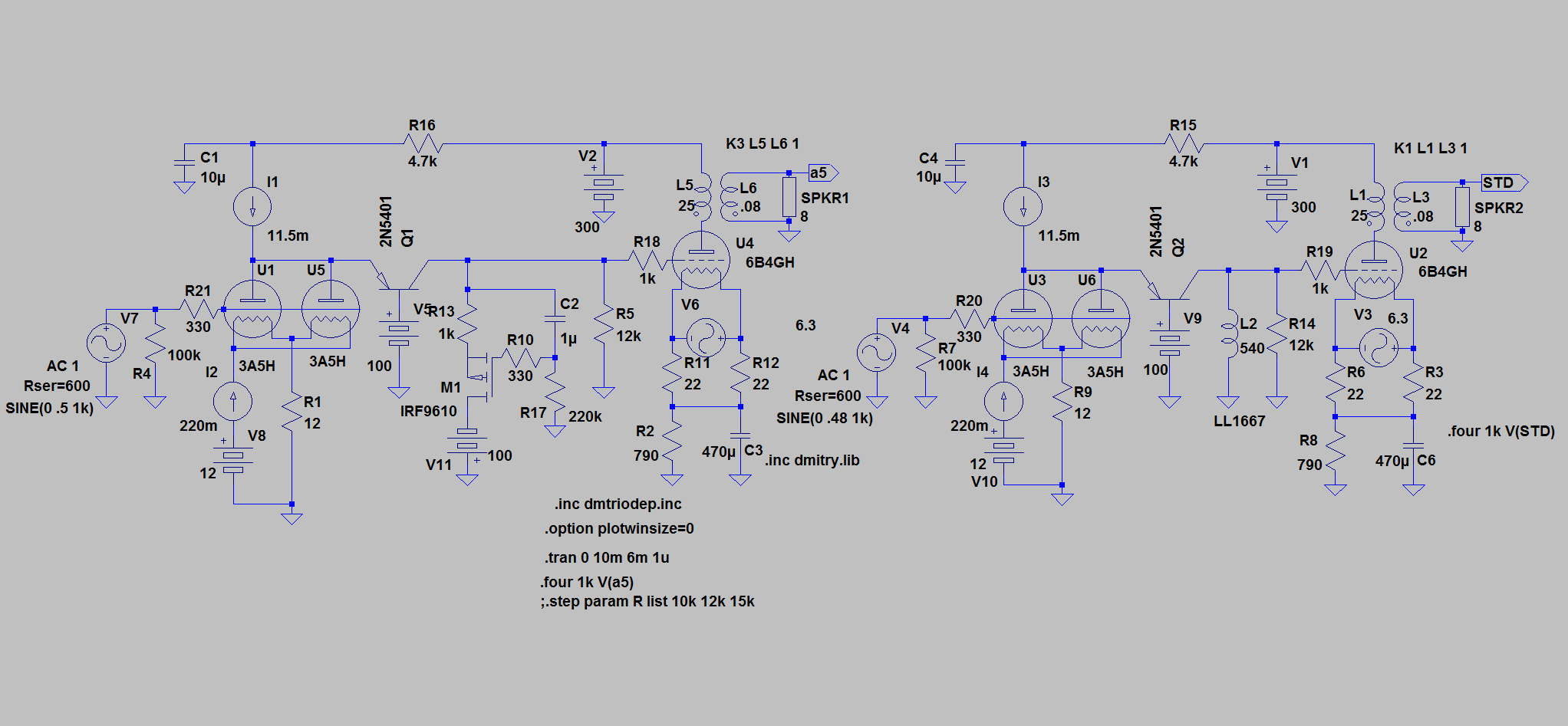

The second one will probably be impossible to realize due to start-up making the powertube grid go positive. Fun to play with anyway.
I get an error message 'couldn't find symbol(s) TRIODEH'
Joined 2009
oh, I was being slow, I didn't recognize what Q1 was doing. It reminds me that I had proposed something like this before (see Q6 in the schematic at post 5): http://www.diyaudio.com/forums/solid-state/194268-dx-hybrid-amplifier-will-produced-soon.html
It makes for a nice hybrid, but I'm not sure that strictly, the 3A5 is driving the 2A3 unaided. The I-V curve of Q1 matters.

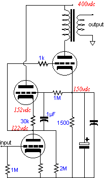

About the Dx I note you finally understood the thing wouldn´t work with tubes😉.

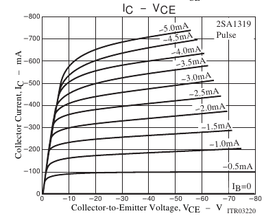

Still, I would prefer to keep the BJT curves out of the signal path in the case that I'm trying to achieve a DHT - DHT combination such that the performance of the amplifier is determined by these DHTs - adding in the I-V curve of a BJT must change the outcome. I'm not sure that this is what I want, given that I can simply use a 6C45Pi as a driver without any sand ?
This is the not-so-subtle difference with a cascode transistor: there are no curves. It's a flat current-in, current out transfer, whole orders of magnitude less curvy than any common-emitter transistor (or even triode) amplifier transfer characteristic. See the bottom line of the graph in the previous post. Competent design is a prerequisite, though.

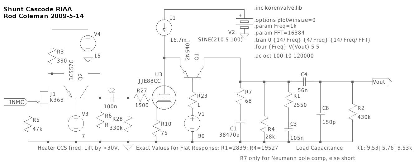

I use a shunt-cascode with a JFET for MC cartridge stage, shunt-cascode RIAA (the eq stage works really well), shunt cascode PA driver. Shunt-cascode from MC to 300B - only 3 stages needed, and I have gain to spare!! The sound of it is superb.

The 3A5 is very easy to use with filament bias, so I have drawn that, and drive it with my Filament Regulators (shameless, I know).
Shunt-cascode + Filament bias means NO capacitors in the signal path, except the output coupler.

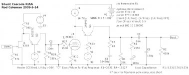

Thanks for posting this circuit. Please explain the function of the MPSA92; I\m sorry to say I do not see the reason for its inclusion in the design. I have in the past built various stages using active loads and of course constant current sinks, but have never (knowingly) had any solid state devices in the signal path, which in this case there appears to be.
Thanks in advance
The circuit operation:
The PNP MPSA92 is fed with constant voltage at the base. This forces the triode's anode voltage to be constant, too - 0,6V higher than MPSA92's base.
The triode is biased to give idle current - say 5mA. The whole stage is fed from a CCS - say 10mA fixed. So 5mA flows into the triode, the rest has only the PNP as a way out [remember Kirchoff's law]. So you have 5mA in the triode, & 5mA in the PNP, which flows into the load resistor - where the current is turned into a voltage.
Now apply some grid voltage. The anode voltage is fixed by the PNP, so only the anode *current* can change. But the overall supply current is also fixed, so only the output current can move.
Thus, the triode becomes a current-pump (a transconductance amplifier, for jargon fans). The fixed anode voltage frees it from the compromises forced by the (internal) anode resistance - so that the gain can be set by the output resistor, without having to consider the B+ value, or the value of anode-current.
The gain becomes gm x Rout. It easily exceeds the triodes mu, which is the limit for CCS loaded stages. And it has no Miller effect, unlike CCS loaded stages.
Since the Music current only circulates between the triode and the load, the supply current is constant instantaneously (not just on average, like a normal SE class A stage). This means that the power supply capacitor carries no Music signal - a huge advantage in itself. And the gain is so high, that the triode's cathode resistor can be unbypassed - eliminating another perennial nasty. Lars has shown that it can also run into the following stage with dc-coupling (lose the coupling capacitor, too), so you can have a capacitor-free driver stage!
I might mention that it sounds better than any other architecture I have tried.
Disadvantages? Needs a PCB for proper layout really, but it can be made small & low priced - and the other parts are quite ordinary. I am laying one out now.
Also, for very high gain stages, attention to stability criteria is important, but again, the PCB controls this well.
