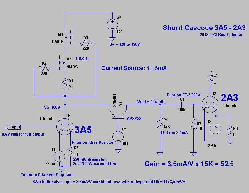

does the 3A5 have the stones to drive a 2A3?
Thinking of DHT driving DHT, two stage only which means I need some gain from the driver. The 3A5 has a mu of 15 (data sheet attached), not exactly high. Is there a DHT with more mu than this one ?
I know the Fi 2A3 has a 'weak' driver (< 1mA plate current supposedly) but I wonder - does the 3A5 have what it takes to drive a 2A3 and
after all is said and done, is the 3A5 very linear ?
I found only one set of curves of any use... and they are attributed to a website that no longer exists. Where I found them is here: Phono Preamplifier with 3a5 Directly Heated Triode
edit: here's how I figure out the gain of the amp. mu of 3A5 x mu of 2A3 = 15 x 4 = 60
with 5k OPT into 8R the voltage ratio is 25, so the gain of the amp is 60/25 = 2.4
that's not really going to do me much use is it....

Maybe not, but maybe. Leaving aside the fact that you have likely overestimated the gain you will realize, if you feed your amp with a 2Vrms signal and have a gain of 2.4, you end up with 4.8Vrms on the output. W = V^2/R = (4.8)(4.8)/8 = ~2.8W. So, you are not quite pushing the 2A3 all the way, but you are actually pretty close. If you have a preamp, or a source with a hot signal, then you are OK.
Reactions: freddi and dubadub
The loadline you have drawn is pretty useless as it doesn´t allow a descent swing and also is in a very unlinear area. With a correct working point the tube is very linear. If you use http://www.revintage.se/triodecalc.xls you can check both max outputvoltage and 2nd order distortion.
If you parallell the two halves(guess you planned that already) and go for something like 4mA/110V, using CCS load you could maybe make it work. Then do a loadline with 2A3s gridleak resistor as load, with parallelled halves you off course double the the load(ie if grid leak is 100k you use 200k).

On paper tube data looks good with S=3,6 mA/V , Ri=4,2k and mu=15.
It will not work with resistive load as the loadline will be to steep. So why not go for two 156C in series(at below 8mA) as Andy suggests. With a CCS heater through the cathode resistor no bypass will be needed. Sensitivity will be something like 2,3Vrms.

The 3A5 can easily answer the call!
With shunt cascode (the best sounding 300B driver I have made) you can drive 2A3 to full output with only 0,6V rms.
The 3A5 is very easy to use with filament bias, so I have drawn that, and drive it with my Filament Regulators (shameless, I know).
Shunt-cascode + Filament bias means NO capacitors in the signal path, except the output coupler.

But they do not appreciate that the BJT is simply using its mighty gm to hold the anode voltage steady, while passing a variable current.
You can compare a BJT vs triode in this capacity, very easily. Just make a standard series-cascode stage with any triode on the bottom, any triode on the top. If you swap the UPSTAIRS triode around, it is quickly evident that high-gm triodes sound best. Last of all, compare the best triode with an NPN BJT - which easily surpasses all.

2N5401 and MPSA92 behave similarly & either type will work fine - but the MPSA92 is easy to buy.
V1 is a voltage source of 101V. It can be made from a resistor-divider + emitter-follower (for low impedance drive) or it can be a shunt regulator set to about 101V.
I use the divider circuit in my amp, and the sound is outstanding - but shunt regulation is potentially an improvement. That's where I am working now.

I'm not a stranger to sand (most of my DIY experience is sand) but I'd much prefer it was used as a load, not directly in the signal path - Rod, in post #8 there's this "Q1" ? - was the intention that it provides gain or just a means to couple two different dc-bias points ?
Lars, can you post your simulation (the forum now allows attachments directly from LTspice) ?
With a shunt-cascode, the amplification is entirely determined by the triode.
The transistor Q1 simply forces the triode to operate with fixed anode voltage, and vary the current according to the grid input. So the triode works on a vertical load line (the line is at 100V & varies from 4mA idle and 2,25mA to 5,75mA at full signal - numbers per each half of the 3A5). This allows many triodes to give their best possible performance, even with gains of many times mu).
The fact that the B+ capacitor is eliminated from the signal path makes far more difference than adding a "grounded grid" NPN. And notice also, that the input AND output are referred to ground, so the power supply rejection is greatly improved compared to other architectures. EMI is also highly rejected for this reason.
