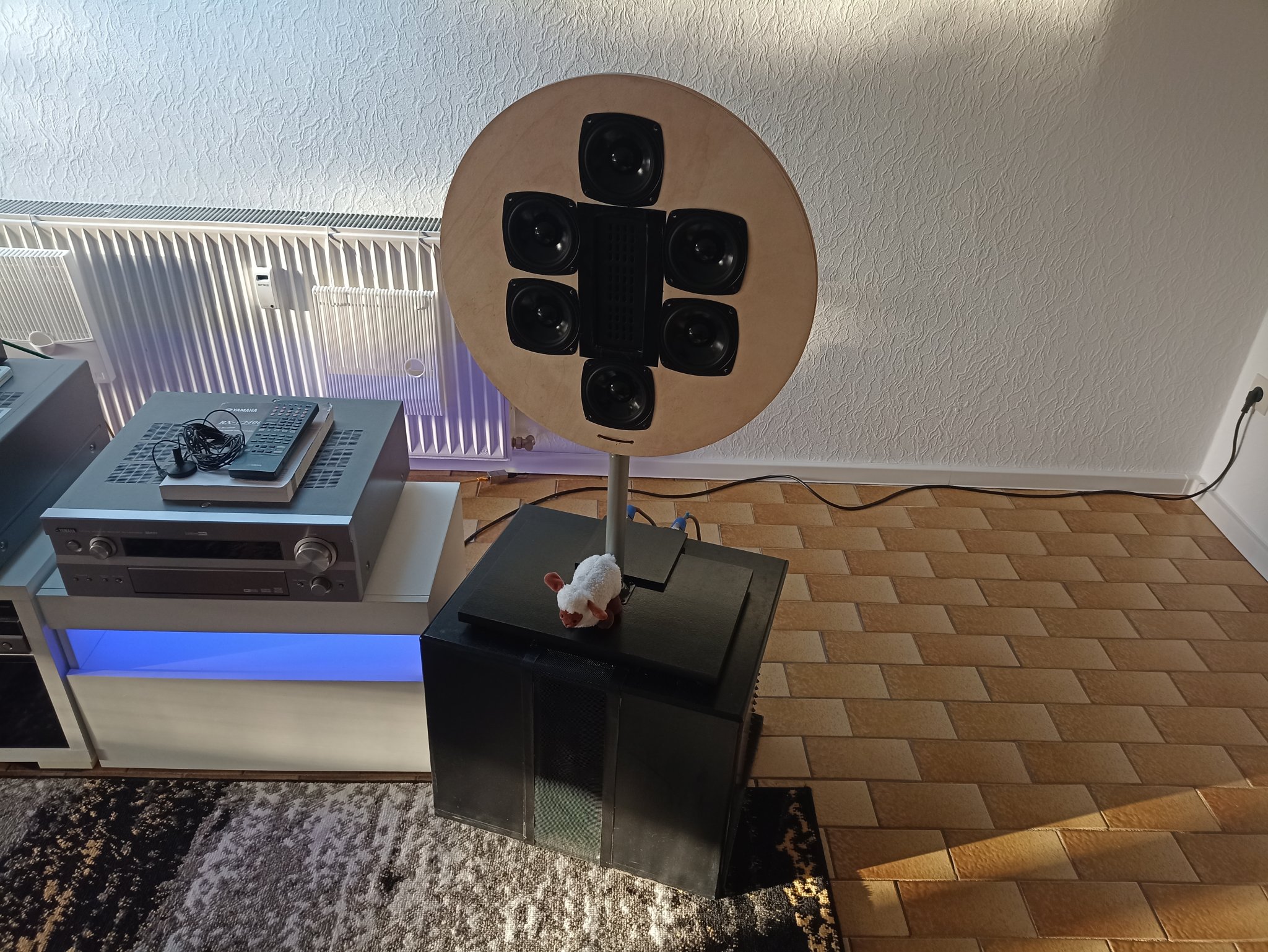

I didn’t consider sound Coming from the rear as an issue in as much as sound would come from the rear of any ob speaker.
Technicality in this area is certainly not a strong point of mine.
Are you saying the performance would be worse if the driver was mounted at the focal point facing out from the convex side?

Yes, ob shape matters. Offcoure, because the shape affects cancelation. Worst shape is circular ob with speaker positioned in the middle. Center of the speaker has equal distance to the edge of the baffle, resulting in big dips in fr response, since cancelation is equeal all over.
Ob has figure eight pattern, not omnidirectional, like incorrectly stated above.
Side cancellation of figure eight pattern is one of the main benefits. First arriving signal is cleaner, with less side wall reflections, since dipole does not throw sound sideways.
Signal going back is no problem, since it has to bounce many times till it reaches the listener. It never interferres with first arriving signal. Floor and side wall reflection arriving too close to main sinal, milliseconds, are detrimental. Back signal arrives tens of milliseconds later is not detrimental, recognized by brain as separate, can add spaciousness.

Thanks adason, very much appreciate the info. Looks like it may be better offsetting the driver. I recall seeing in another thread a “formula “ for an ideal placement on the baffle (looks approximately 1/3rd from top edge) I am determined to use the sat dish for interest sake and will only get one chance with the position.
Being a circular baffle with the driver offset I wonder if rotating/tilting the baffle would change the sound characteristics.
If you "fix" the response by offsetting the driver, it won't put the overall distribution in balance. Putting the driver in the middle gives the best midrange baffle support. Besides, the convex side may already give good diffraction control.

What's the problem, it's the "dipole null", alias edge diffraction related interference, which depends on size of the baffle basically. The bigger the baffle (regardless of transducer size) the lower in frequency this happens, it'll make the dip some where when wavelength is similar in size to the baffle. Usable bandwidth of a dipole transducer is below this regardless, so all big baffle does is it shifts the usable bandwidth of the transducer down, reducing system SPL capability ( limited by bandwidth and xmax of the driver ). So, baffle can be basically any size and shape, as long as good design practice is used, use the clean bandwidth of the transducer. Basically, best would be naked transducer without any baffle at all because it shifts edge diffraction issue as high in frequency as possible, shifting the usable bandwidth up which results most SPL capability. One can abstract naked driver to be circular baffle, transducer in the center.Yes, ob shape matters. Offcoure, because the shape affects cancelation. Worst shape is circular ob with speaker positioned in the middle. Center of the speaker has equal distance to the edge of the baffle, resulting in big dips in fr response, since cancelation is equeal all over.

This is true when the system is positioned carefully, it's not automatic just having a dipole. Backwave, first specular reflection from front and close side wall would have similar ~6ms delay (positioned roughly >1m from these walls), like with any speaker positioned at the same location. Difference is the reflections might be attenuated if toe-in is optimized, side nulls pointed toward the earliest specular reflections of front and side wall. Due to having same delay these would interfere similarly as any other speaker, except being attenuated the interference is far reduced in amplitude as long as nulls are utilized to attenuate them.Signal going back is no problem, since it has to bounce many times till it reaches the listener. It never interferres with first arriving signal. Floor and side wall reflection arriving too close to main sinal, milliseconds, are detrimental. Back signal arrives tens of milliseconds later is not detrimental, recognized by brain as separate, can add spaciousness.

Open baffle means you loose spl on low frequencies - a lot. Seems like LiiAudio 12" doesn't have huge Xmax that would be needed for equalization...
Other than planar baffle means that frequency response and dispersion will be different on front- and backside. With AKABAK one could make a simulation, but I wouldn't bother.
If you have a 12" driver or can purchase such, easiest is just to make it and give a go. My guess is that it will sound awful.
