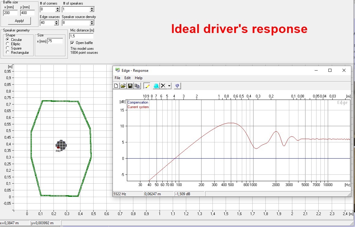

There are freeware simulators that you can use to study baffle diffractions of boxed and open baffle speakers. Different baffle size and shape, different shape, size, location and number of radiators, movable mic.
Easy simple .exe for diffractions http://www.tolvan.com/index.php?page=/edge/edge.php

It's all to do with the ability of long wavelength, low frequency sound waves to bend (or diffract) round an open baffle.
Long wavelengths from the rear of a woofer bend round the baffle and interfere destructively with the long wavelengths from the front of the woofer, resulting in bass cancellation.
By making the baffle larger, it becomes harder for the long wavelengths to bend (or diffract) round the baffle, resulting in less bass cancellation.

At very low frequencies, a dipole source has a lot of cancellation. This is because the different pathlengths between the front source (front of cone) and the rear source (rear of cone) and the listener is much less than the wavelength of sound. Therefore the phase difference of these two sources at the listening position is not much different than at the source itself, and with the rear and front sources out of phase you get almost complete cancellation. But as you increase frequency, the two pathlengths are different by an amount (e.g. the width of the baffle) that becomes larger compared to the wavelength, eventually reaching half a wavelength. This flips the phase difference from 180 deg out of phase to in phase and the two wavefronts actually constructively interfere (add in phase) creating a +6dB SPL at that position and frequency. In general the SPL from a dipole source is dependent on distance from the dipole, and the listening angle. Linkwitz's web pages contain some models of the type of response pattern that this generates and that is a good source for info.
In between very LF and the dipole peak, the relative phase angle is changing from 180deg out of phase to in-phase, and so there is a slow change in the SPL from the dipole source at the listening position vs frequency.
The magic is eq. A driver on an open baffle will show a response that drops at 6 dB/oct below a certain frequency. Simply equalize that by means of some filter and you end up with a system that has a straight response. At the cost of course of max output of course, for an OB woofer 15-20dB correction at 20 Hz is not unusual. Eq can be done actively or by choosing driver parameters accordingly.So what magic is going on if there is a minimal box with no front or back?

I hate to break it to you, but you can make a great OB with a circular baffle if the baffle diameter is less than about twice the driver diameter. In that case the responses on and off axis are very smooth. The diffraction problems arise when the driver is much smaller than the baffle, and the distance to the edges is the same from the driver center. In that case the driver is similar to a point source, and a round baffle reinforces the edge diffraction signature and causes strong peaks and dips in the frequency response. When driver and baffle are of similar diameter, the peaks and dips do not occur. There is a great paper on this topic by Mellow and Karkkanien called "On the sound field of an oscillating disk in a finite open and closed circular baffle" J. Acoust. Soc. Am., Vol. 118, No. 3, Pt. 1, September 2005.
Maybe if the author of that web page you linked to had more of a grasp of the subject they would have mentioned that the plot of a driver in a circular baffle is for a point source, like a tweeter in a large circular baffle (I think this was lifted from Linkwitz's study on that effect). It does NOT represent most OB systems and is an exaggeration of the typical level of this effect in a real loudspeaker just to make the effect stand out for the purpose of demonstration. See:
https://www.linkwitzlab.com/diffraction.htm
