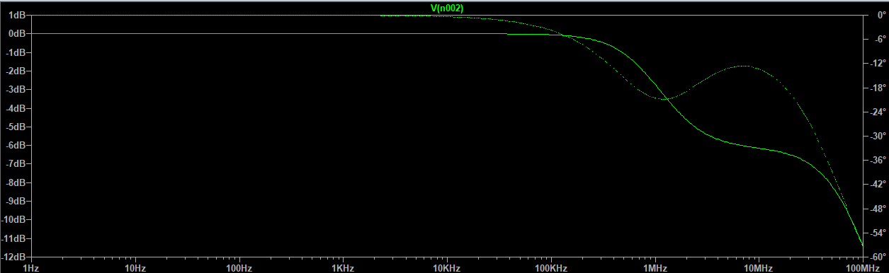

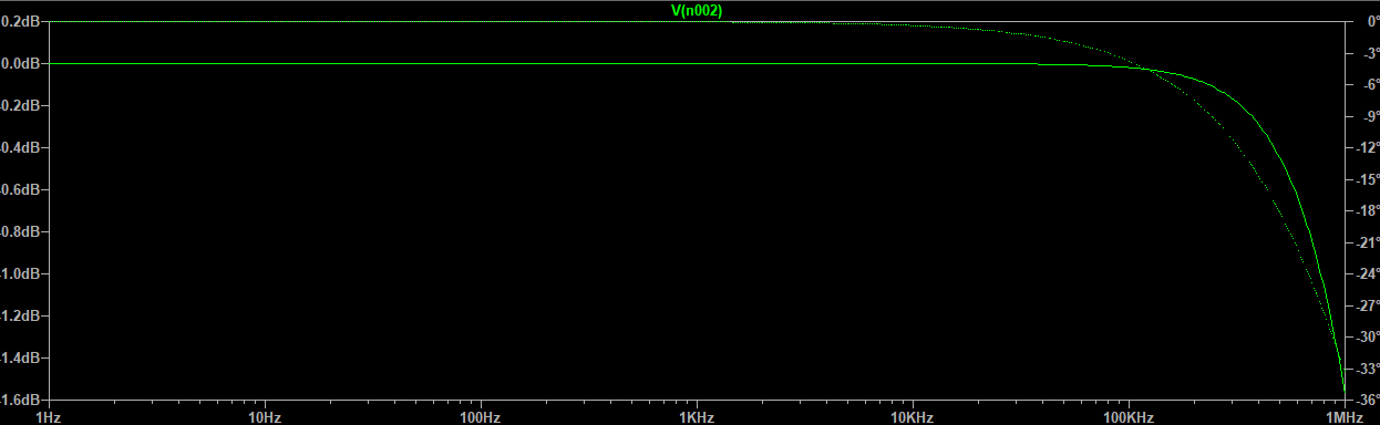

I doubt some residual inductance in most resistors should be a problem. Inductance will increase the impedance at high frequency, which should be a benefit. But also add some sort of series RLC resonance, together with the Miller's stage capacitance.
I see residual resistor capacitance as more of a problem, because it will bypass the resistance value and couple high frequencies. From that POV, I wouldn't use wirewound non-inductive resistors.
However without any real-world values, it isn't worth it to draw any conclusions.

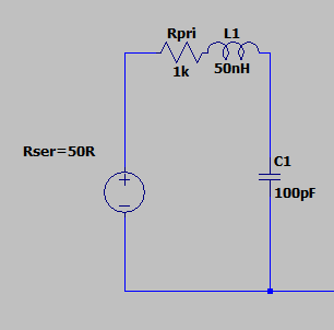

Here is a frequency response simulated with and RLC, 50R driving impedance, 1k resistor value, 50nH parasitic inductance added, 100pF shunting capacitance.

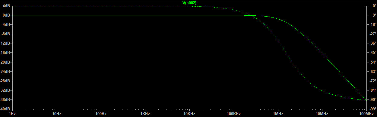

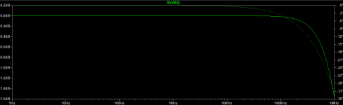

Here is a frequency response with 100pF parasitic capacitance across the resistor
I think you need to buy a mills MRA5 resistor the size of one of the cathode resistors in a line amp and hear the difference. I like how it cleans up the tube noise when looking at the plate on the scope.
I'm not sure how those model values scale, but they seem too large. 100pF would be difficult to achieve even if desired, and plain wire is what? 1nH/mm or some other tiny number. If that's off by several orders of magnitude, doesn't matter. A bulk resistor can have negligible parasitic Z's for this gig. But it does need to still be a resistor at somewhere around the top of the HF band, maybe 30MHz.
But your point is taken; a lossy inductor also does the job.

Chris, yes, 100pF seems impossible from my POV as well, but I oversized the value as a worst-case estimate.
