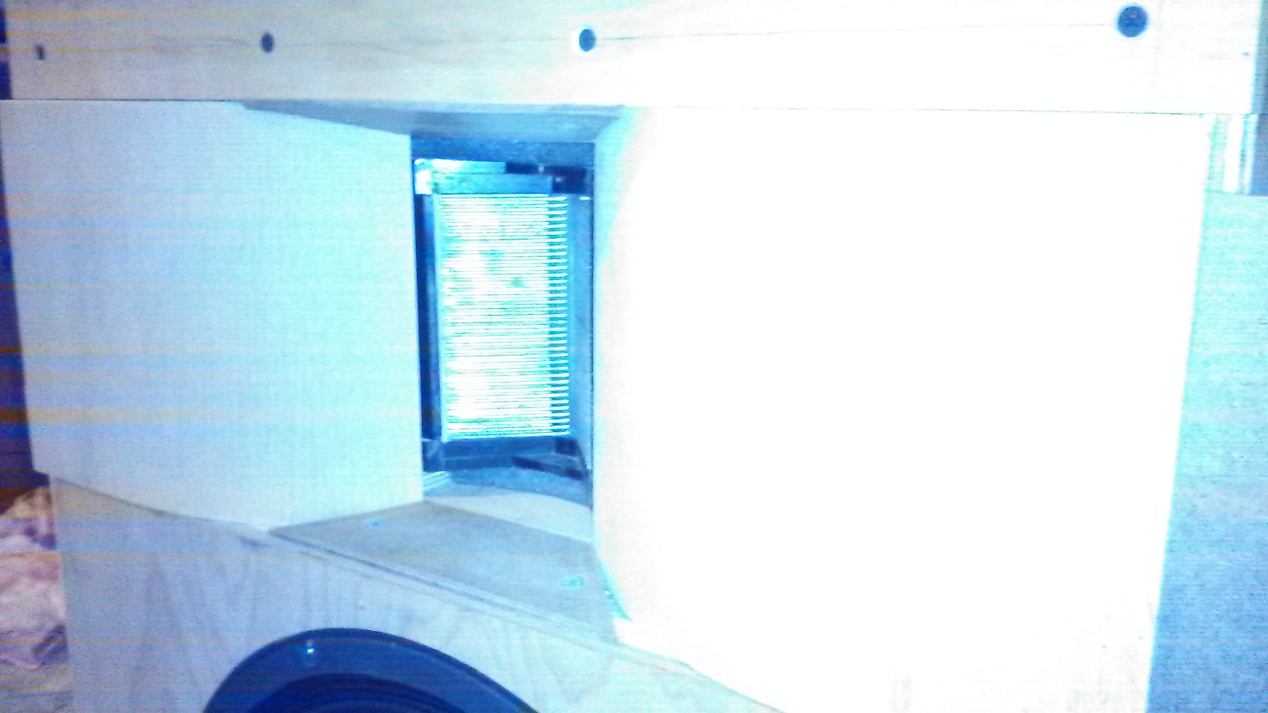

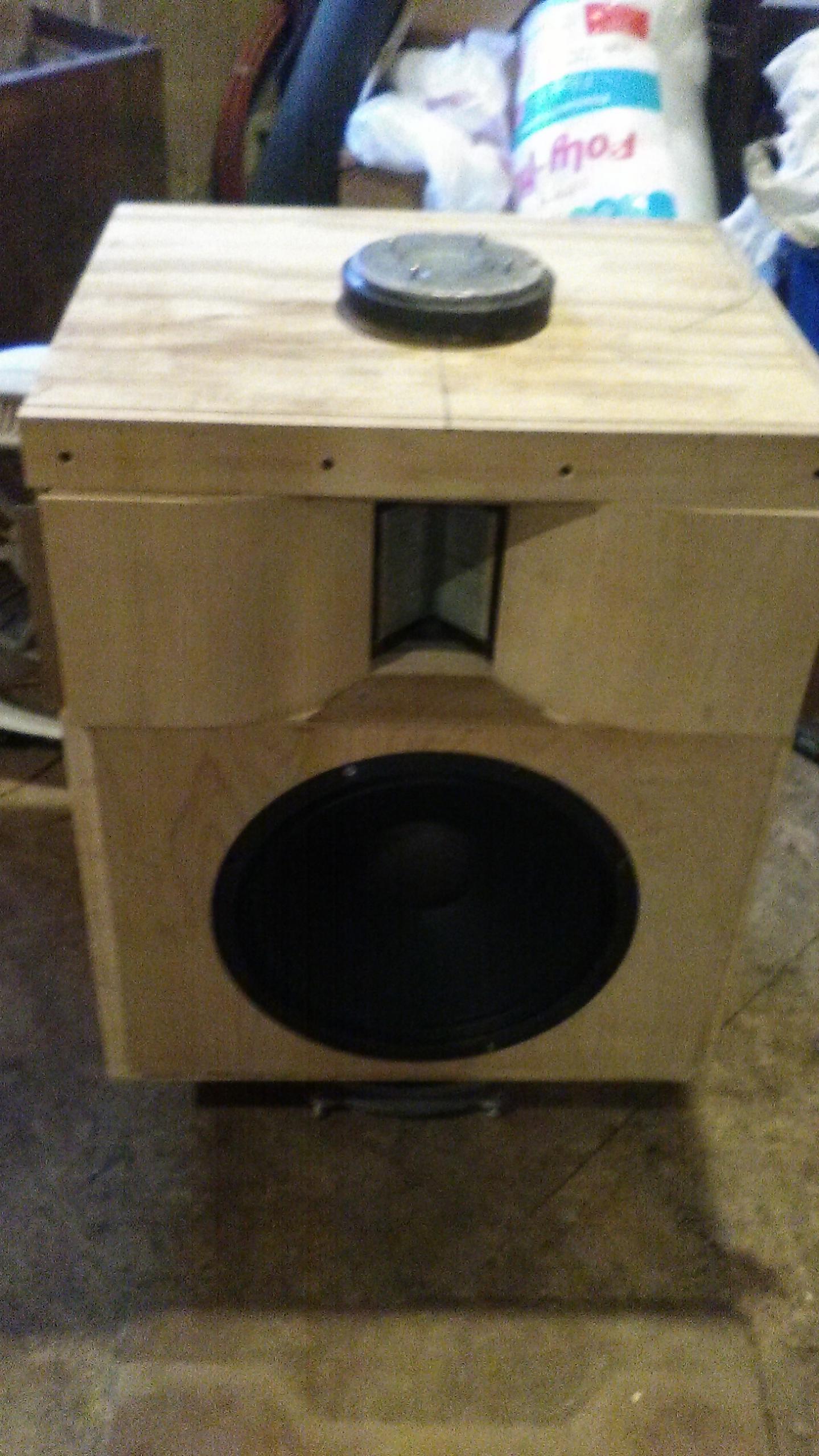

I think a larger horn/AMT combo (as is) would lack the efficiency of a CD/horn. I don't believe you can just slap a AMT to a horn and call it good. Oskar Heil had a patent of a circular AMT that might be as close as you could get to using a dedicated "horn" with it. The efficiency would be lower though I'm sure.
An AMT/waveguide combo works well to smooth out the frequency response I've noticed. That's with an existing heil AMT structure. The 1st generation heil structure is the most efficient of the bunch but nowhere near a CD. So, how loud do you need it to play? Home hifi you'd be fine.

I don't believe you can just slap a AMT to a horn and call it good... The 1st generation heil structure is the most efficient of the bunch but nowhere near a CD...
You can't just "slap" a CD to a horn and call it good either............lol
The heil is no where near the efficiency of a CD? How efficient are CD's without horns anyway? The purpose of the horn is to increase potential spl....which turns into lower extension and a wider passband....more directivity, etc, etc....
My impression of waveguides are poor mans horns, whatever the waveguide does a horn does more....they are just tiny horns to me, non the less...
