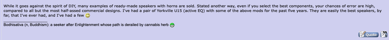

While it goes against the spirit of DIY, many examples of ready-made speakers with horns are sold. Stated another way, even if you select the best components, your chances of error are high, compared to all but the most half-assed commercial designs. I've had a pair of Yorkville U15 (active EQ) with some of the above mods for the past five years. They are easily the best speakers, by far, that I've ever had, and I've had a few 🙂
