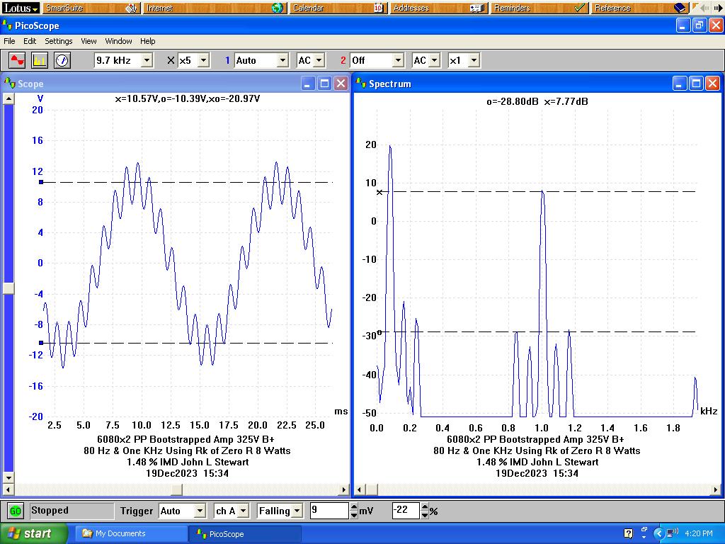

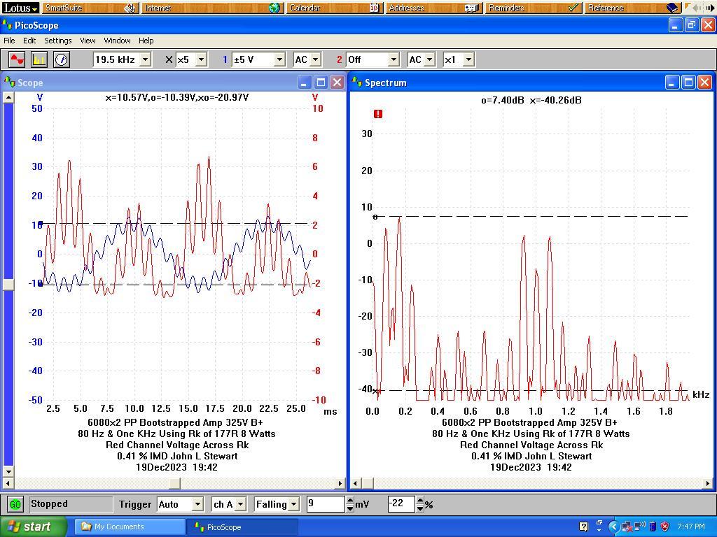

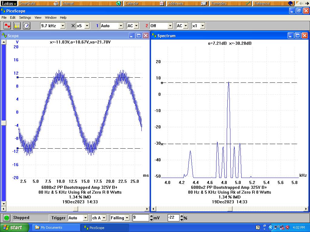

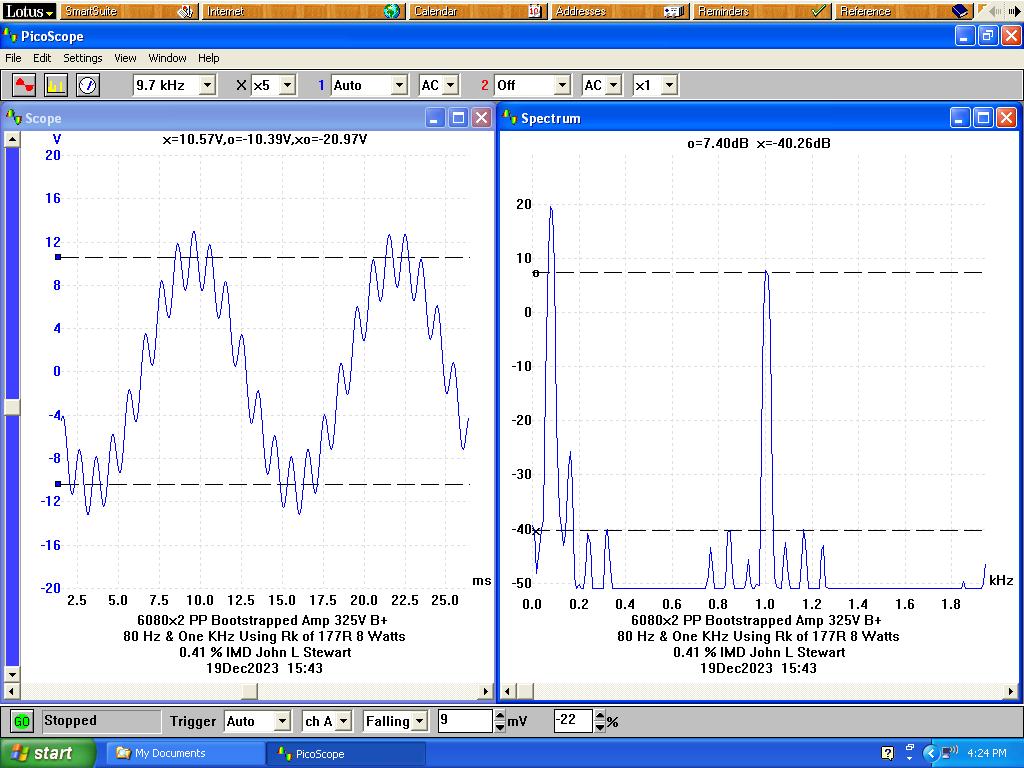

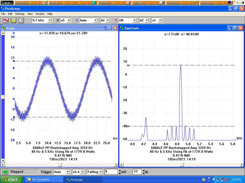

Here is the detail of the amp I used for this series of tests. Something I'd been curious about for a long time, bootstrapping the driverBy adding a resistor in the tail (roughly 1/gm) the current can be increased toward the edges so as to keep gm more constant.
for low mu triodes. In the Spring of 1998 I finally pushed ahead. The front end is a 2-stage diff amp with resistive tails to -150V.
Very few in audio use a negative potential other than for biasing of the output stage, Yet it was ubiquitous in the Op Amp buz, both SS & Toobz.
Some people object to the use of bootstrapping even tho it is used in McIntosh, Electrovoice & Circlotron amps.
Crowhurst also use bootstrapping in his Twin Coupled amp. I've used in several times since in Crowhurst's Amp, this PP 6080 Amp & others.
Measuring & calculating the degree of positive FB we get 1.5 to 2 db. That is easily overcome by the external NFB path to whatever
degree the OPT will allow. I also used the resistive tails to -150V in all of these. Including a Class AB2 PP 6V6 amp.
At one time or another all of these amps I built have been here on DIY. So I will bore you with yet another set of slides.

I've found the reference of the tests I've posted here:
https://www.diyaudio.com/community/...4-6n1p-pp-amp-kit-build-2.406195/post-7533720

PP 6V6 Class AB2 Amp John L Stewart
This Amp looks like a good subject to use in trials of the Allen Wright Distortion reducing circuit. Trying at levels in Class A & AB with some grid current. Later this week we will see!
Circa 2001 I built this amplifier to satisfy some of my curiosities. None of these involved listening, but as always I did listen for a short while to be sure it was working properly. It was at a time when I was looking for experimental results from various circuit topologies. Not long after I got going on this project, another good looking contract appeared. So as usual, Money Talks & &hit Walks. The project made it to RAT but there was no article to get published in Glass Audio or AudioXpress.
This Amp was used briefly in another project published in AudioXpress Nov 2003. In that instance the project was a free running analogue switch with adjustable open time. An RF engineer would look at that one & recognize a Balanced Mixer.
My amp curiosities included, what Class AB2 6V6s in PP would do while working from a limited PS as they do in a performers guitar amp & in comparison from a lab supply. Another point of interest was the use of an internal NFB connexion from the PP 6V6 plates back to the upper grids of a Differential Cascode frontend, the drain connected to a -150V volt.
The application of a similar internal NFB connexion I’d seen in one of Bill Perkins (Pearl) Amplifier Schematics, although in Bill’s case the NFB was from a tertiary winding on the OPT back to the screens of the driver tubes (PP 6AU6s). I had no OPT with tertiary windings & the G2 rg2 would load the NFB circuit. From other work I had found the looking in resistance of a common pentode voltage amplifier to be ~30K. If we dig enough in Terman Ed 4 we can find what Terman said on this subject.
It looked to me a way out & a more predictable result might be NFB to the upper triodes grids of a Cascode stage, that in order to avoid loading.
It might be a surprise to some I would use tubes of the BQ7 series as drivers in this amp. Earlier in one of the other experimental amps I’d built, I made adapters to use BQ7s to compare to the usual 6SL7/6SN7 2- Stage Diff Amp. The results were much better than I had expected. It seemed they would be suitable for this build.
Most of the slides look to be self explaining. The 10 mS tone Bursts I think were at 10 watts. So we see a drop of 10V across the PS at the termination of C-L-C of 10 mF-10H-100mF from FWCT SS Source, Hammond 271X. The other is Peter Gabriel performing.
