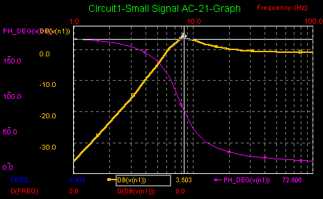

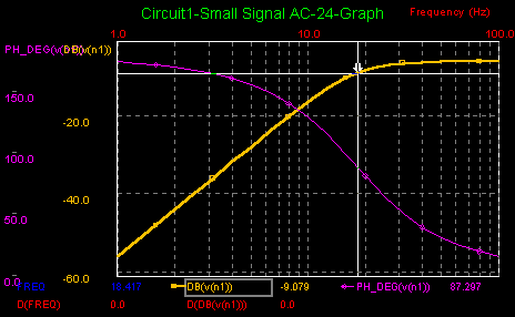

I have done some simulations, for lowish mu triode and UL pentode. The circuits are my attempt to model what the anode sees, for these two outputs using either resistor bias ('k' version) or CCS bias. For the triode I assumed an effective C at the anode of 10uF, for the UL 1uF (bigger C, but bigger mu too).
You can see that the low mu triode with CCS has an LF peak of 4dB around 8Hz. Using resistor bias changes it to a 0.6dB peak around 12Hz.
The UL output is smoother, with or without CCS. This is because the higher anode impedance damps the peak away to nothing.

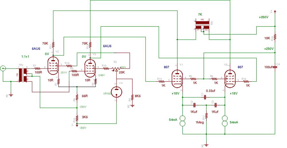

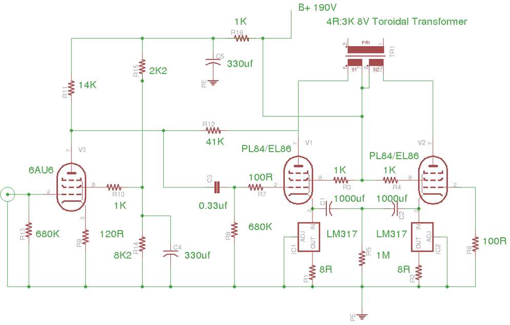

This is what I am currently listening to which is a considerable step up from the original in terms of bass punch and top end extension.
The second schematic is a version of the Simple EL84 amp. This works really well, but I had to reduce the plate load on the 6AU6 to fill out the sound a bit.
The bass is not as tight as the 6080 amp - but that is to be expected considering the difference in output impedance.
The next one is my version of the Tabor amp by Gary Pimm. This sounds the least satisfactory of the lot. Don't quite know why. I feel if I ran it Triode strapped it would probably sweeten up. The surprising thing is that running this amp Pentode should have lower output impedance than triode. Still I think the 807 is a reasonably high distortion pentode.

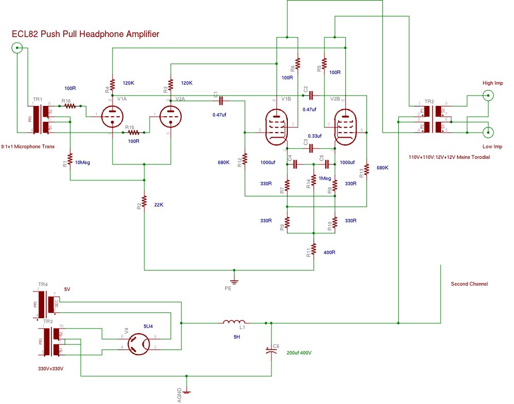

i also built a PP headphone amp using ECL82's. Sounds sublime and would make a perfectly workable power amp for speakers.

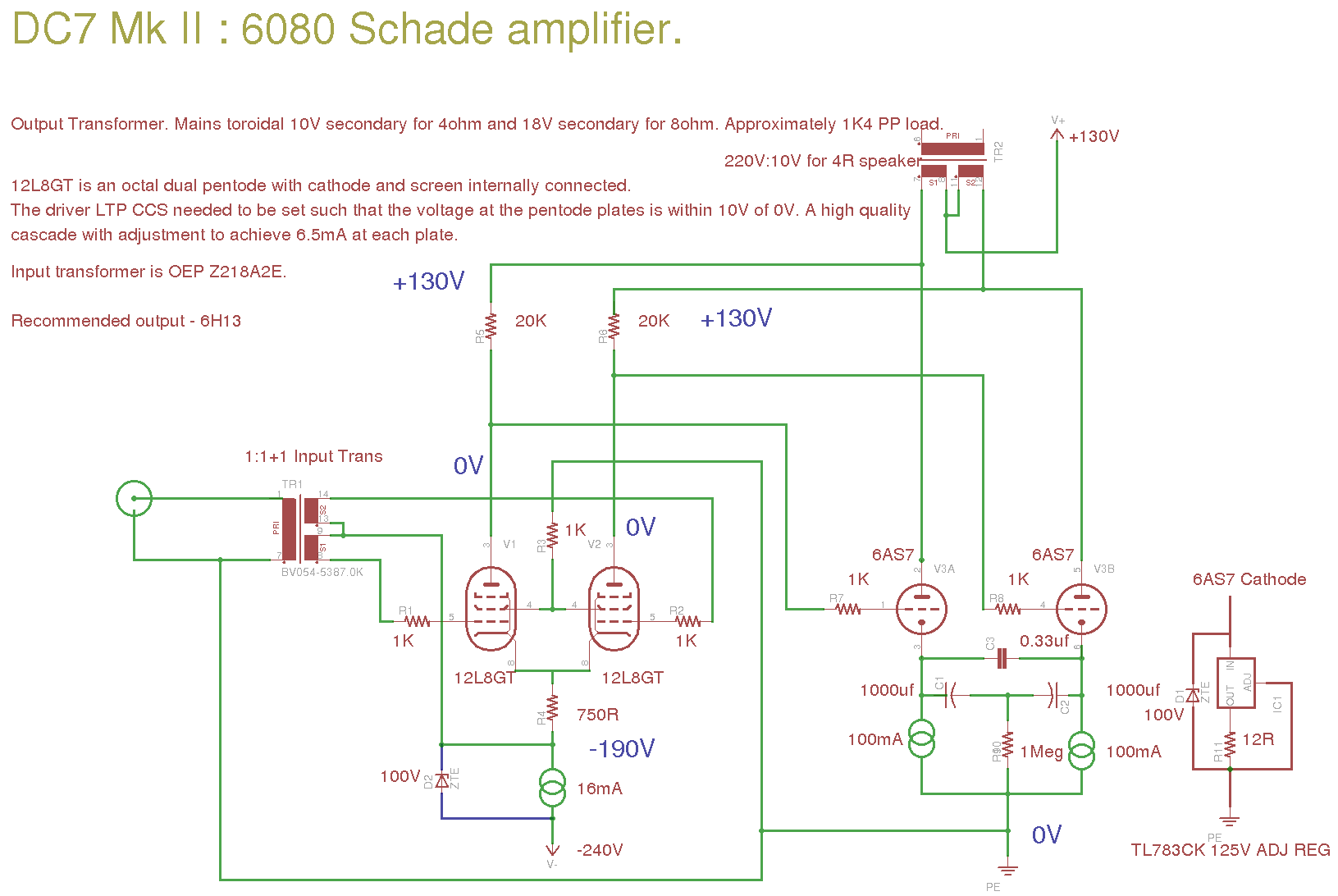

It was my design objective with the DC7 Mk II to make a four valve PP amp. This constrained me to finding a suitable dual Pentode (not a lot of them about) for the driver.
I love the idea that anyone looking at it would think it was a SE amp, and this would shape their preconceptions as to how it would sound. When they listened, and then were told it was a PP - look at the surprise on their faces😀
I have grown to be of the opinion that SE is a hopelessly compromised approach, unless restricted to the flea powered territory.
Shoog
Yes, this DC7 Mk II is terribly clever-a really streamlined design; I would love to see the look on peoples faces too! I am not familiar with this dual pentode. Using pentodes as gain stages is one more piece of prejudice I have to shed. It is a relic of using SET for too long although I have never liked any of the transmitter SET amps that I have heard including the most iconic of them all which I had to babysit for a friend for a while.
Shoog, I'm very interested in your DC7 mk2. Do you know about how many watts it puts out per channel? I'm using fairly inefficient speakers, 83db/watt, and that was why I was thinking about paralleling 6as7's. If I could get away without doing that I'd prefer it. I now am understanding why the obscure driving pentode was chosen - neat.
