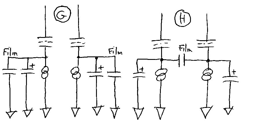

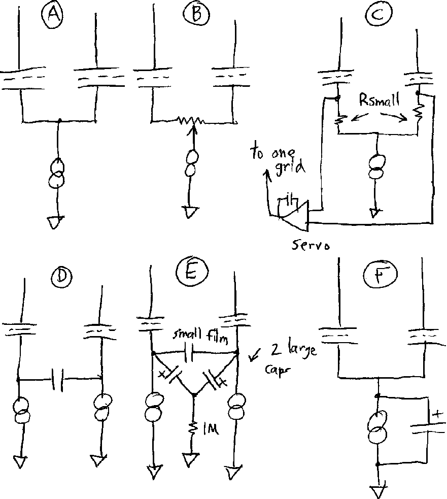

Remember that differential operation means that you are restricted to class A. There is absolutely no way for this topology to stray into class B of any kind.

I understand that with differential CCS it is only class A. So no one has to always return to a previous thread to know what we're referencing here's the map of different CCS cathode schemes courtesy of Brian Beck. Pic A,B,C,D, and E is class A only. Pic G, and H is the "standard" CCS scheme that allows limited AB. Not sure about F. Is this correct?

Exeric; sorry there has been no reply to your last question. It is hard for me to see with the large idle currents in the designs we have been discussing how,other than in extremis,how this kind of stage could be driven into class B and I don't know what the behaviour would be under such circumstances.
