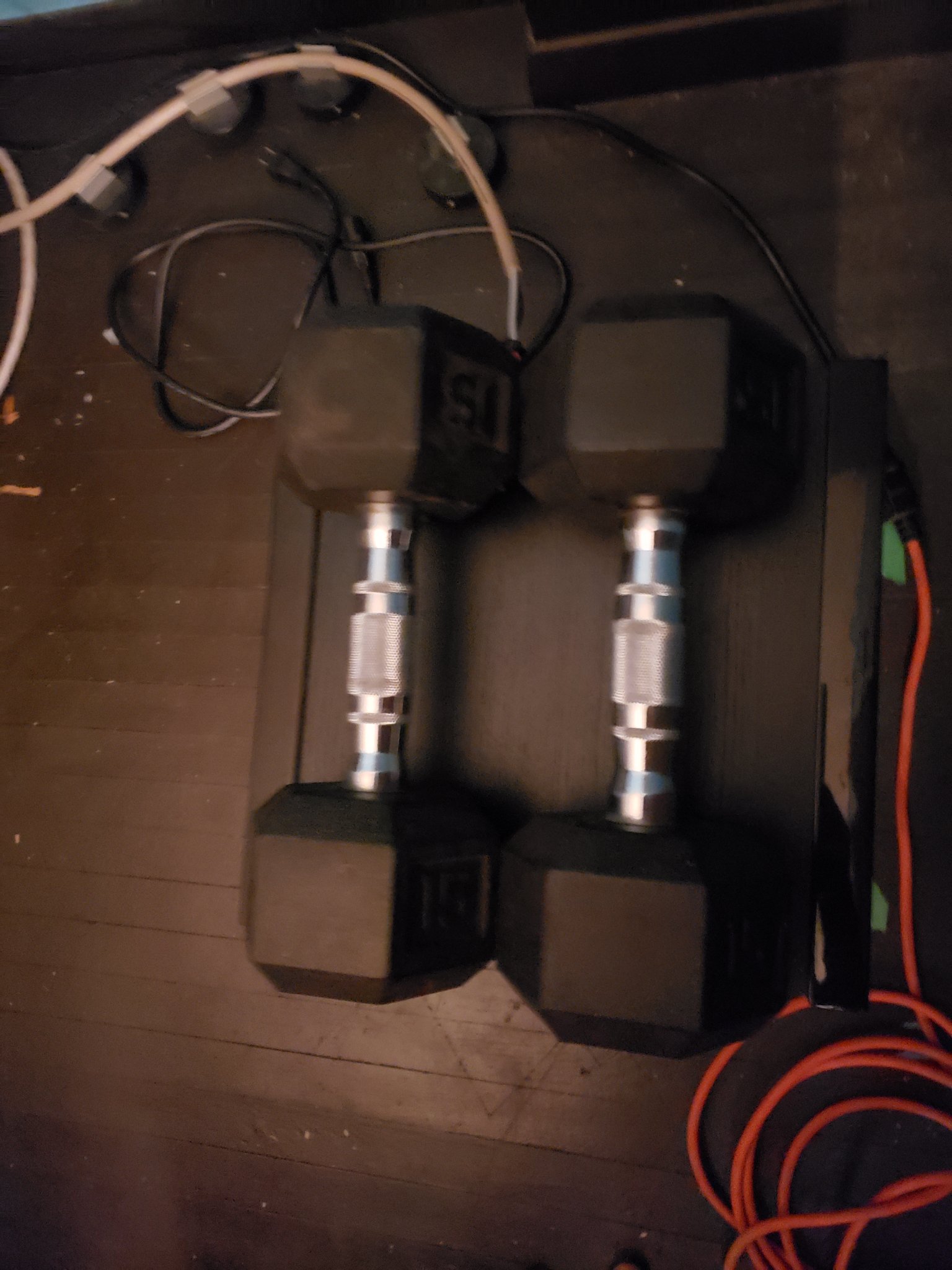

I guess the other plus about 8" sealed boxes, I double up every wall thickness not be smacking my legs on a hug box. It will be a bit tricky setting up one per corned and making the lines invisible. The crawl space resides directly under me so not a problem drilling the floor where it doesn't show up top. To run two sets to the opposite side.
I weighted the sucker down until I get spikes that fit. 30 lbs seems to be the sweet spot lol.
