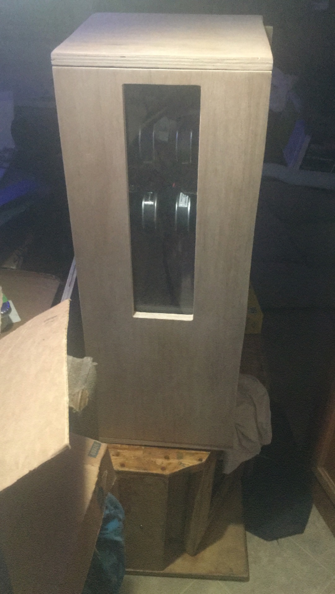

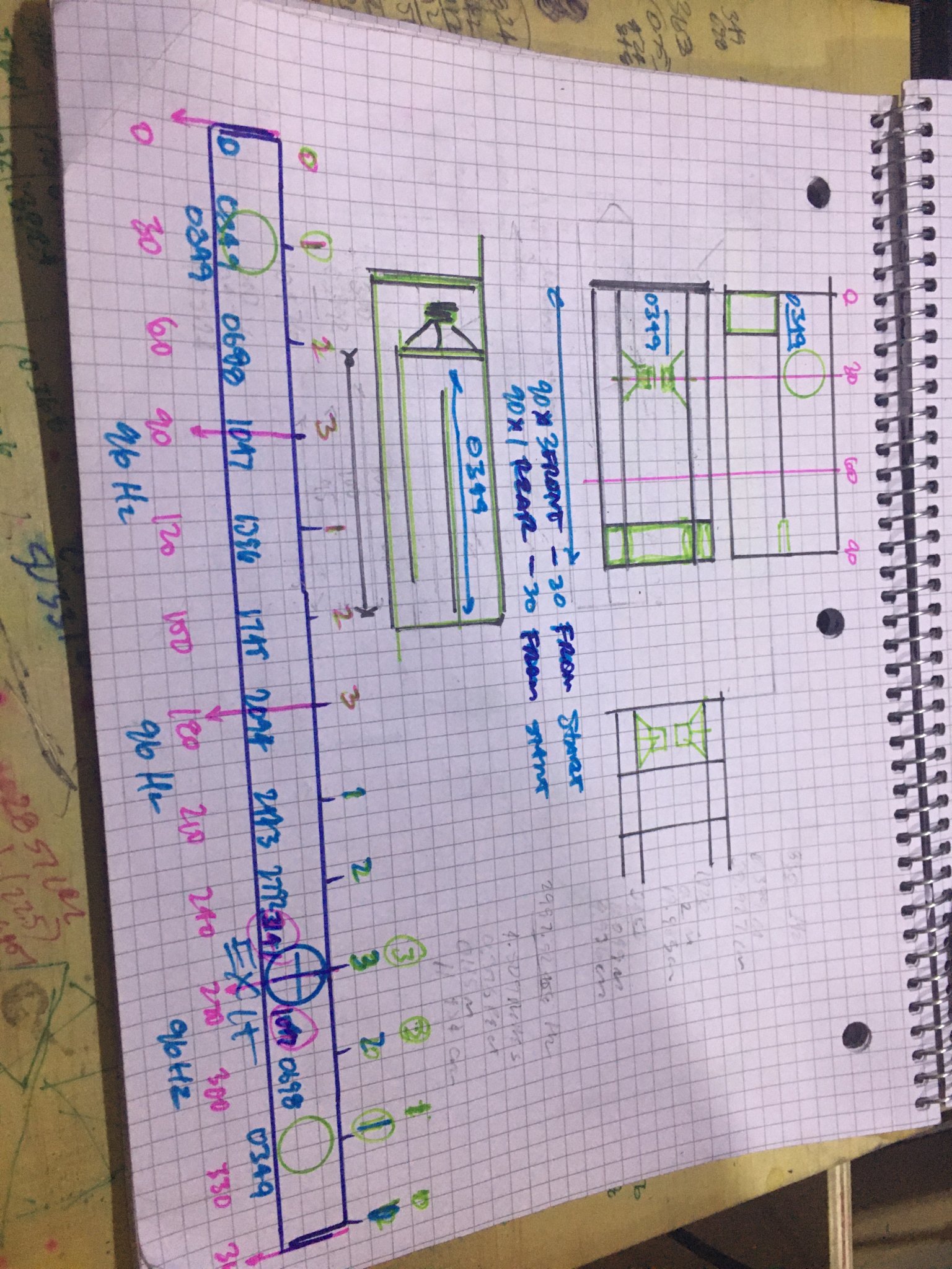

pressure inside the pipe as the 3/4 harmonic(not 1/4) is useful as individual segments as resonators but make them all part of the fundamental. but the fundamental isn’t the entire pipe it’s a three to one (with a turbo). Except this ‘turbo’ has no lag.
If you swing a pendelum by definition of frequency and in one second it Will complete 30° or pi/6, but This is pi/ nine for transmission lines as Martin King documented as 0349. But he didn’t tell the whole story or explain of the source… oh well.
equal and opposite pressure waves are (sine/cosine) coming towards each other from either end Of a compounded qw pipe at all times but from opposite polarity that number 0349 is technically 05236 now, pi/9 vs pi/6. These numbers are radiant and I helped define a breakdown to circle the thThese numbers are radiant and I helped define a breakdown to circle. When you do this you can draw sinewave all the way around the circle 360° and the drivers will be separated by 300° change that to centimeters change that the radiant change that anything you want it doesn’t matter the point is time and flight and also driver has fixed everything and more as pictureWhen you do this you can drive sideways all the way around the circle 360° and the drivers will be separated by 300° change that to centimeters change that the radiant change that anything you want it doesn’t matter the point is time and flight and also driver has fixed everything and more.
Maybe better to look at this response and compare and contrast things to better understand it then be explaining it which fails to deliver it seems.
It’s up to you but meanwhile there’s a superior subwoofer that is not that difficult to build that people might want to be aware of. Knowledge is free but Maybe Thats why it hard to understand? I’m not used to having it??😂
It isn’t That big of a deal once you look in horn response. Martin king was doing the same thing but using a MLTL / bass reflex last I talked to him, But that does not work. it comes up with a phase discontinuity every time.
