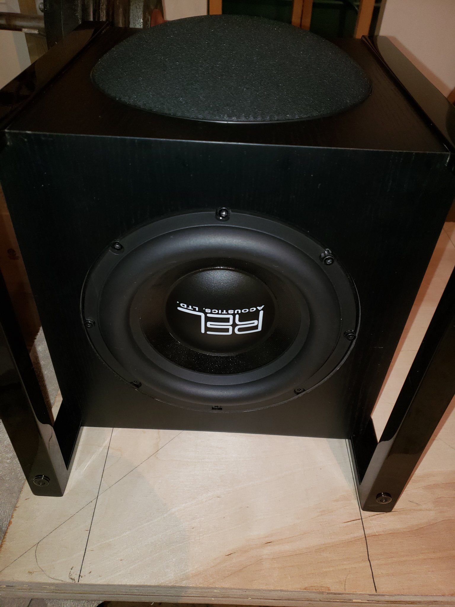

The principle at work is the same though ie the rear side of the woofer is coupled via the air in the cab to the PR or air column in the port which then resonates in sympathy.
except that the weight of a passive radiator is much higher than that of the air column in a port
For a typical BR spec vent size, but IME (and IIRC also Tom Danley's) using a simple BR vent's air mass to find the weight of a PR is spot on when using the correct air mass density and of course when the vent area (Av) = the PR's effective piston area (Sd), which due to it needing an ideal ~> 2x driver effective piston area (Sd) dictates a ridiculously long vent (Lv) to reach down into the (sub) bass.
