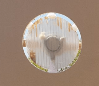

Could you post a few more pictures of the construction. It's maybe in another thread, but why the 100 mm hole + plate fixed with glue? Why not fixating the plate directly to the panel without the hole?
Exactly whic Tectonic exciter are you using?
Wondering if it is better than the Dayton ones, and are causing the better freq response.
Could you elaborate a bit more on the sound, and in comparison to other speakers ..
Thanks for posting
Edit: .. ok I think I get it. The plate in the whole is actually responsible for the much better high freq response as this is the only part moving at higher freq. Towards lower freq, the panel will start moving as well.
I would think you thereby also have a more "normal" off axis response with reduction towards higher freq.
It's kind of a 2 way mechanical system 😉

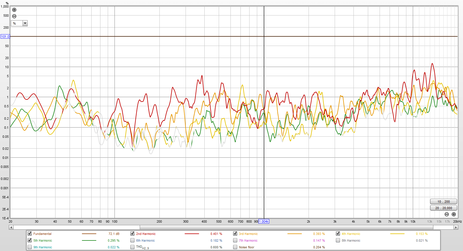

REW should do 2nd...9th if you dont limit it in the preferences. Did you?
Here are all the distortion curves for the 'blue' panel.
I have not plotted the curves that are below the noise floor (6th - 9th harmonics.) The curves here are masked where they drop below the background noise. I have also not plotted the THD since that is on a previous post.
I'm not totally happy with these distortion curves though. The drivers I'm using (Tectonic TEAX32C30) have had to be raped in order to get rid of the protective rubber shrouds buzzing. I've also had to reinforce the feet that attach to the metal springs. And they're still buzzing a bit.
I'll use Daytons next, possibly the DAEX32EP-4.

Thanks Baldin,
Yes, I did suspect that the 100mm polycarb disc was acting like a piston. But I have measured off-axis responses and they're still better than any dedicated tweeter I've ever used. This implies that the disc itself is still acting like a DML panel. My theory is that the weight of that disc is a lot lower than the whole panel, and will therefore perform better at HF.
Once the wind dies down here, and IF there's mains power, then I'll do better off-axis measurements for the system.
Another thing, the disc was mounted behind the panel, on the back skin. In effect it was firing through a 100mm-dia, 20mm-deep cavity. I suspected that this cavity might be resonating at high frequencies, so this morning I re-mounted it on the front skin, and re-measured. No difference, except that quick off-axis measurements show a little improvement over the back-skin performance.

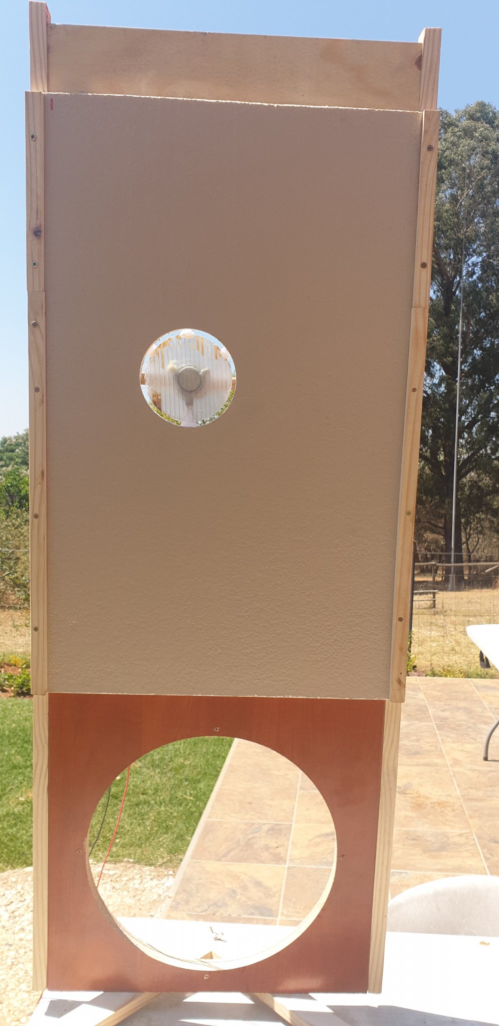

WRT the photos, I WAS going to supplement the bass with 15" open-baffle cone speakers. But after auditioning the panels with and without the cones, I've decided to go without them, and will simply make the panels a bit longer.

So tell us what gave you the intuition to use polycarb on the DML with a hole on the panel?
Pete, I think it was just common sense to me. The exciter would drive a lighter weight to a higher frequency, while the physical "impedance" of the larger panel would be coupled to the driver via legs, and operate at a lower frequency.
I've never actually thought about it in detail.
I think that fortunate happenstance had something to do with it too.

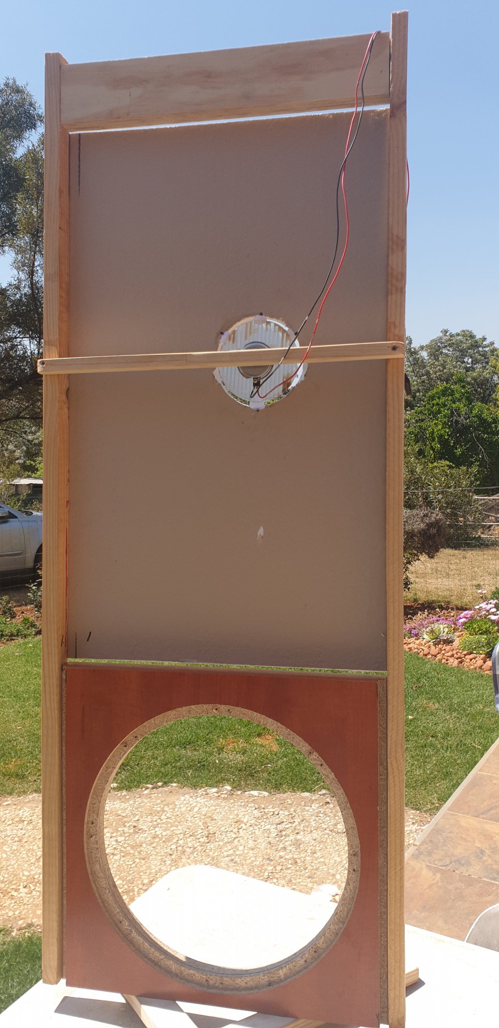

I'm sorry I don't understand what the exciter vibrates on only on that polycarbonate disc? and the rest of the panel what is it for? you could also put some photos in front and behind.
Thank you
Thank you
The disc is fixed to the rest of the panel via "legs" of hot glue. You can see the black dots in the photo of the back of the panel where I marked the 60° positions before mounting the disc with hot glue to the panel.
Yes it's a bit messy, but the proof of concept seems to work nicely.
Disc density and stiffness will effect the speed of sound through the material and will dictate what size the disc dia should be.
